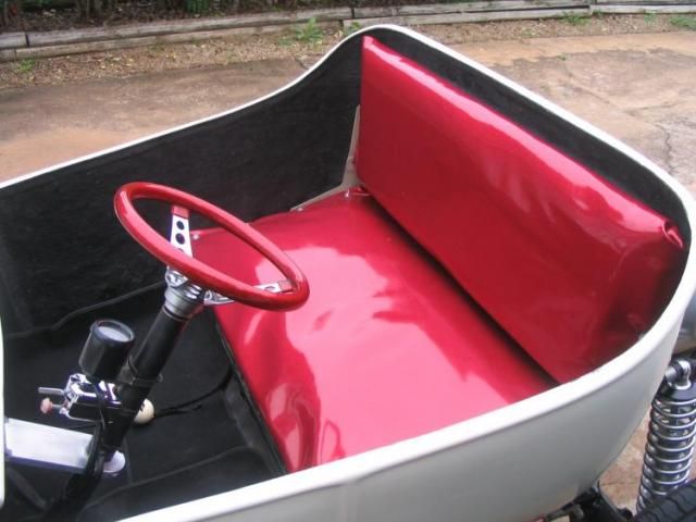

    Remember a while back, I was saying how I had to drive in a down pour? I think I mentioned it. Well, anyway, I used Zodiac marine grade metal flake vinyl for my seat. When I got home, all I had to do was wipe my seat dry. No water soaked in at all. My wiring under the seat and all my other junk was dry as a bone. I don't have pleats for maintenance reasons, as well. Simple and purpose built.
    I got it from these folks: http://www.diyupholsterysupply.com/
    Great folks to deal with.

  9. Hey Fred, I would be keen to see some more full photo's of your interior please, especially how high is your base off the floor and how have you attached the frame to the body ? That is the area I'm working on now and the little voices in my head say for me to look for small bucket seats out of a tiny jappa to fit in instead of a one piece seat. The main issue I have is trying to fit the hand brake in a position where I can reach it without having to remove my seatbelt. It is now in it's third position but if I built a one piece seat base, it will have to have a cut out for the hand brake which isn't really nice hence the little voices. Where is your hand brake Chip and how easy is it to reach ?

    Okay, here we go. The front riser is about 6". That will seem high, but bear with me. The rear is 4". The reason for the heights is because I used webbing on the seat bottom. I took a piece of cardboard and made a pattern for the seat bottom. I then transferred that to 3/4" marine grade plywood. I cut holes for the driver and p***enger side. Then, I did a weave with the webbing that is used for lawn furniture.
    Next, I went to an upholstery store. Not the auto type, but the upholstery store that women go to. I purchased 2 medium sized, fluffy pillows. The plain white ones. That's the inside stuffing. After MANY trials and errors, I found the Zodiac Marine Vinyl and covered the seat bottom. The back section is 3/4" plywood and a 3" foam backing. I wasn't worried about my back, it's my *** that bounces. Underneath that bottom, the base is divided into 4 sections by varnished and fiber gl***ed pine. The area where the body tapers wide on each side, are separate sections for storage. There's room for a whole list of stuff, I have stored underneath that seat. Tools, my fuse box, access to the battery, a big tarp, car care products, flash light's, zip ties, pocket knife, battery operated tire pump, tire plugs, gloves and a hat for cold weather, electricians tape and a 12" pipe wrench. whew! Here's a better pic of the interior. You'll have to wait until tomorrow to see a pic of the underneath section.
    Back to the height. I knew I wanted the final seat height (with me in the car) to be about 4". The webbing allows my weight to settle in the seat at 4". Which seems perfect to me. The top of my shoulder blades are even with the back of the body. I sit "in", not on my car.
    I used the hinges from a boat seat, to allow the back to flip forward. That way, on hot sunny days, I can flip the back down and keep the seat cool. Again, thinking about my ***.
    If I answer the parking brake question, this thread will REALLY get off track. In a nut shell, in 38 years of driving, I've never had to use a parking brake, so......

    Whiplash, here are the pics of my seat and storage areas. First pic, is underneath. The green thing on the p***enger side is a 20'X30' plastic tarp. Folded tightly and pushed down into place. Underneath it is access to the battery. On top of that are a pipe wrench, Amour All, a mini LED flashlight, a Gerber, a couple towels, an issue of Rod& Custom (in case I need something to read on the side of the road) and the p***enger seat belt that's just flopped over.
    On the drivers side are the fuse box (I have a piece of rubber mat that normally covers it. It's tossed on the drivers side floor mat in the pic), a couple knit hats, gloves, another Gerber, various lengths of fuel hose, vacuum hose and electrical wire, tire plug kit, tail light bulbs, fuses, a battery operated tire inflator (underneath the hat and gloves), another mini LED flashlight, a spare fan belt and an ***ortment of other things, in case of emergency. The drivers side seat belt is flopped over here as well.
    Notice the 3 par***ions that separate the storage areas. On either side of each seat, are a storage area. On the p***enger side is a knit pouch that contains tools, a couple shop rags, a small funnel and a nice ***ortment of various sixe nuts, bolts and washers. On the drivers side are windshield cleaner, zip ties, screw drivers and the varnished stick for checking fuel levels.
    Here's the under side of the seat. Here, you can see the weaved straps I used. The white is the pillows I described earlier. The gray material is a thick felt material that covers the pillows. You can also see I didn't skimp on the staples, used to keep everything in place. The two small blocks of wood, towards the front edge, keep the seat from sliding forward and hold it in place. The folded over material is thick. So thick, that when weight is applied from seating, it creates a water repellant seal to the underneath compartments. On either edge of the seat are the hinges that I used from a failed boat seat experiment. The boat seats were hard as a rock and too small. Plus, they raised me to a stupid riding height.
    Finally, here's the seat with the back folded down. Again, when I'm at an event and the sun is beating down, I flip the back down and it keeps the seat cool. Trust me, nothing stings, like sitting on a vinyl seat that's been sitting in the sun for a few hours. Also, I can flip the seat forward and store a light jacket (that's folded) or the Sunday newspaper.
    That's it. The seat weighs about 25-30 lbs. Zodiac upholstery is water PROOF and VERY durable. That seat will out last the car. My theory on T Bucket interiors is, sp**** and functional. It's a HOTOD. No cup holders, no radio, no fancy Nancy materials. The interior sides are painted with truck bed liner. It's durable and water proof.
