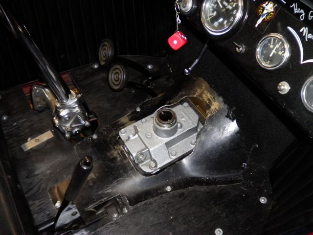

    Here is my e-brake setup, its a VW handle, I grabbed a surplus e-brake cable from our local Princess Auto. Works great and its out of the way.

    One concession I haver made to the modern was my emergency brake lever. Well maybe not too modern. Probably '70s Vega or something. Works great, not too noticeable, not much in the way. Actually my neighbor was building a WWII Jeep and bought this *****in short cable. I had him get me one for my roadster. Perfect. SANY0001.jpg

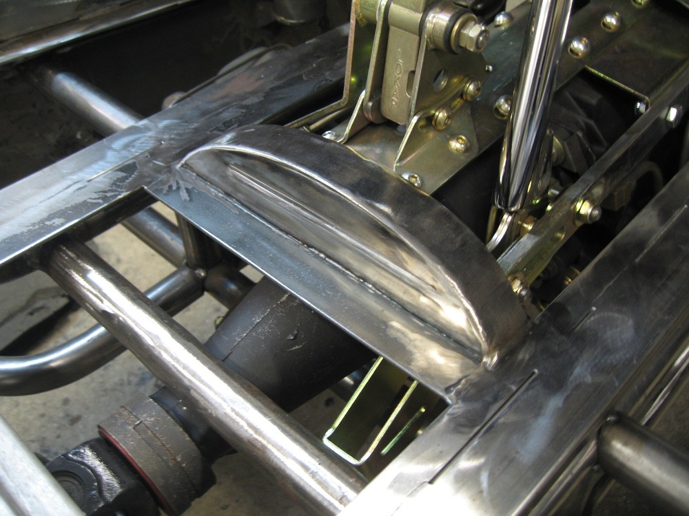

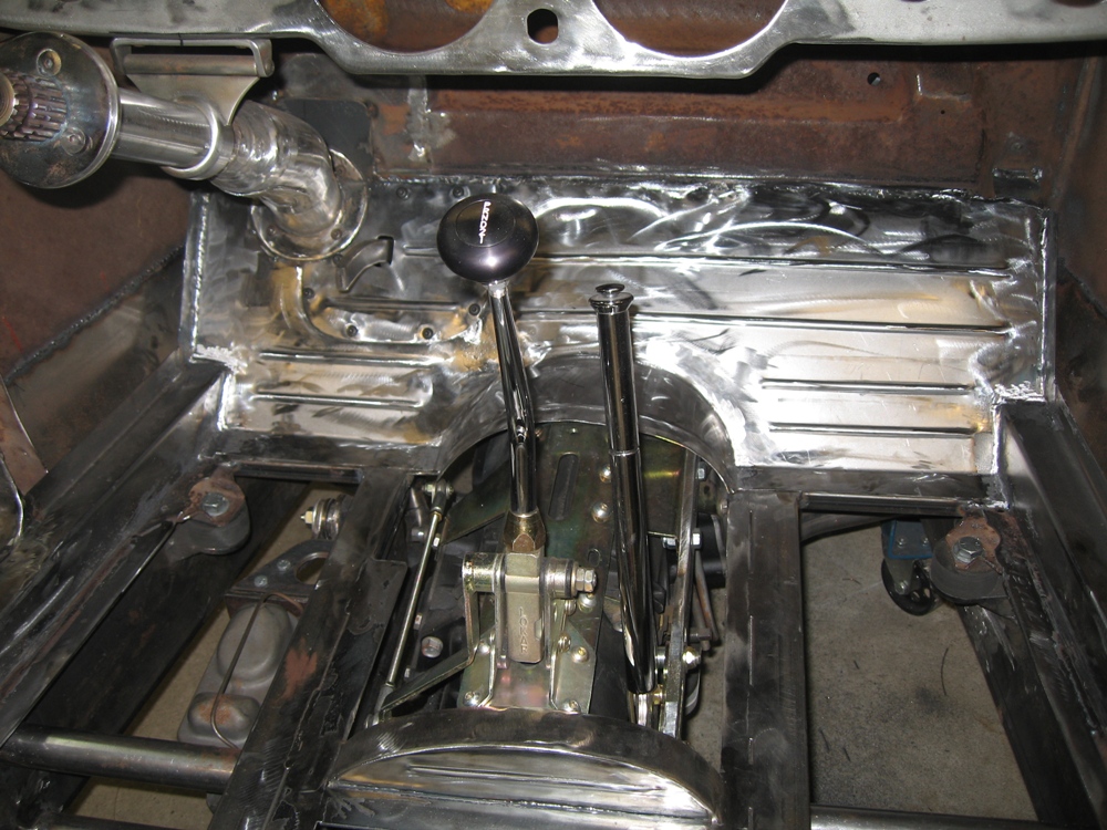

    For an e- brake setup in my RPU I decided to go with a Lokar trans mount e-brake handle and the brake cable kit that goes with it. I think it makes a clean install. :)

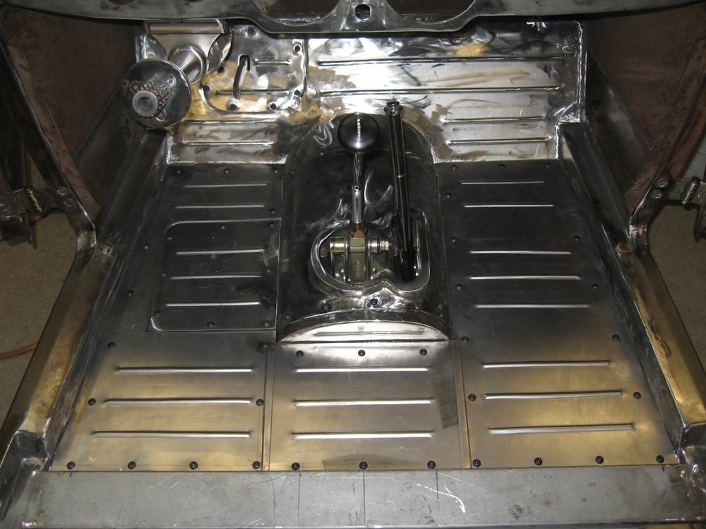

    Thanks :) The floor sections (except the toe panel) including the hump over the shifter and e-brake handle are removable for future access to all that under floor stuff you would need to pull the body to get at. :)

  14. That's VERY nice work, Blue one! What do the floor panels bolt to? I ***ume you built a sub floor? Do you have a pic with them off?

    I built a 3/4" x 1 1/2" rectangular tube sub structure and the floor panels are held down bolting into 1/4" steel nutserts .
    here are a couple shots where you can see some of the substructure before the nutserts and panels go in.

    THAT is one stout, owner friendly, mutha fu*kin' frame and body mounting system!
