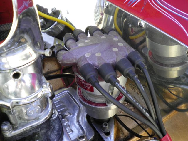

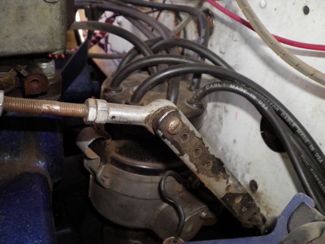

    Okay gang, I promised a bit of progress, and this off course is brought to you by the sound "PFFFFFFFFFTTTT", and by the ceremonial release of smoke that either means there is a new Pope, or an electronic component has failed.
    So, the quickest way to get back on the road was to dig out my spare Mallory YC distributor and pull out the points, figure out a coil, and get back to gettin' on. I lucked into this extra YC at a small, private junk yard I frequent for 20.00 if memory serves. I'm pretty sure it was never run in anything, but years of semi-outdoor storage have made it not so pretty. All is new inside, so out it comes. SAM_7067.JPG
    Next, what coil to use? I don't know about you, but lately, if I don't spend big silly dollars on a name brand coil, it's left me stranded within a year. The decision was made easier by the fact that I HATE external ballast resistors, and I knew one would be the deal if I was to run points. Why easier? 'Cause I was about to call on my VW days in more ways than one! See, cool little fact, VWs use an internally resisted coil! Now, the first thing you do with a newly acquired air cooled bug, is tool down to the friendly local VW shop and buy a Bosch "hop up kit", which has a .009 distributor (damn near perfect performance curve!) and, what we are concerned with here, A Bosch blue coil. I have never personally seen a blue coil go bad... EVER! They have a very nice output, and are of a very high quality. In researching this buy though, I do have to note that in the last couple of decades since my heavy involvement with the VW world, there has been a couple of changes in the storied blue coil. There is now a version made by my neighbors to the south down in Mexico that is oil filled and not noted for the traditional dependability. The is another version that has "Blue Coil" written across it, yet is silver, and also oil filled... Bad. The one to get is the Brazilian version, which is epoxy filled, internally resisted, and neigh on indestructible. Plan on spending about 50.00 at your wholesaler or VW joint. SAM_7056.JPG
    So, with the good stuff in hand, lets cure something else that has driven me nuts with this thing since I have had it... I HATE clutter on top of an engine! Engines always look best when stripped down to their skivvies, If you will, with a minimum of stuff stuck on them, and as little wires running to and from as possible. This has made me crazy! SAM_7057.JPG
    So, what to do? Well, I had intended to find a nice little coil bracket and mount it to the firewall in true traditional fashion, but coil brackets these days are either gawd-awful complicated billet stuff, or super cheap, flimsy, badly chromed **** made by one of Judy's relatives... Think... Hey, wait a second, what was that trick we did with the VWs? The one where we gacked a hole through both sides of the fan shroud and stuck the coil through... Ya, that's the ticket! So I grabbed my 2 1/8" hole saw, held the coil up, squared it with my thumb and one eye closed, closed my eyes and pulled the trigger.
    Something else to mention here. Another reason for the Bosch Blue coil is the fact that it is epoxy filled. It has been my findings, that an oil filled coil laid on it's side is RARELY happy for very long. Many in the ignition business have told me that I am wrong, but I didn't notice them hangin' out the night the Plymouth ate it's coil at 11:00pm on a Sunday night 3 miles from Dateland, AZ.! Never heard of Dateland, AZ? There's a reason! It's literally 75 miles from ANYWHERE! The theory is that an oil filled coil allows the upper coils when laid on it's side to be exposed and out of the cooling oil. This makes stuff not happy with prolonged use... POP! Epoxy fills are almost indestructible, 'matter of fact, stock VW installation is upside down and at an angle. SAM_7063.JPG
    Cleans stuff right up; Cee? In the end I lost the spade clips and went with loop terminals, which I almost always use simply because if anything loosens up, it still stays in place and functions. Now on ward and upward to making this stuff function! Oh, a simple band clamp holds it in place from behind, and eventually, this will be transferred to the polished aluminum fire wall to come. Next off, that damn throttle cable! Solid linkage soon. SAM_7075.JPG
    Sure cleans stuff up!

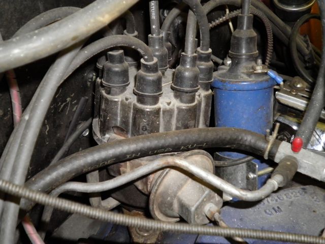

    Will that coil work with a Pertronix module ?
    I have a vintage Holley distributor rebuilt and modified with the Pertronix unit by GMC Bubba for my Y Block.

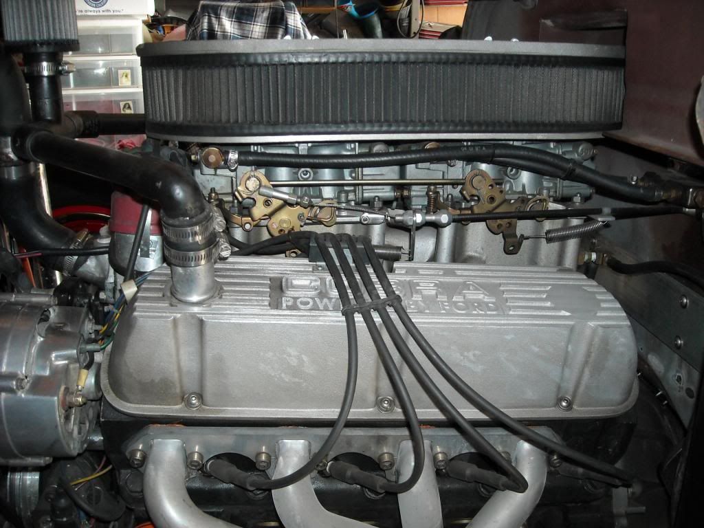

  3. George, this is the set up in my Chevy II. It was dead reliable for a good 10 years before I took the car down for a freshening up.
    Nothing wrong with that, MadMike. You notice I don't post too many pics of my T on here (except detail shots of how certain things are done as options for people), that's because it doesn't really fit in (Well, it does have some ugly that needs to be removed). The car has an iden***y crisis, it's seems to me (like a lot of other T buckets) to be trying to be to many things in one car. It has some drag style (Blown 392 , Weld Wheels, Giant back tires), some Fad T style (Top, deep diamond tufted interior, and cowl lights, lots of chrome), and a beautiful billet aluminum luggage rack that really doesn't fit the rest of the car. Then it has the ugly (bright red painted frame and radiator inside a chrome grill shell, performance stickers on the frame rails, chrome Ahh-ooga horn mounted on the frame between the radiator and engine, etc.....). But I have been gathering parts for two traditional styled T's for years, a mid to late 60's T bucket, and a '27 T roadster pickup (Steel body, '40 ford hydraulic brakes, 292 (.060 . Eventually one of these two cars will be worthy of this thread! ;-D

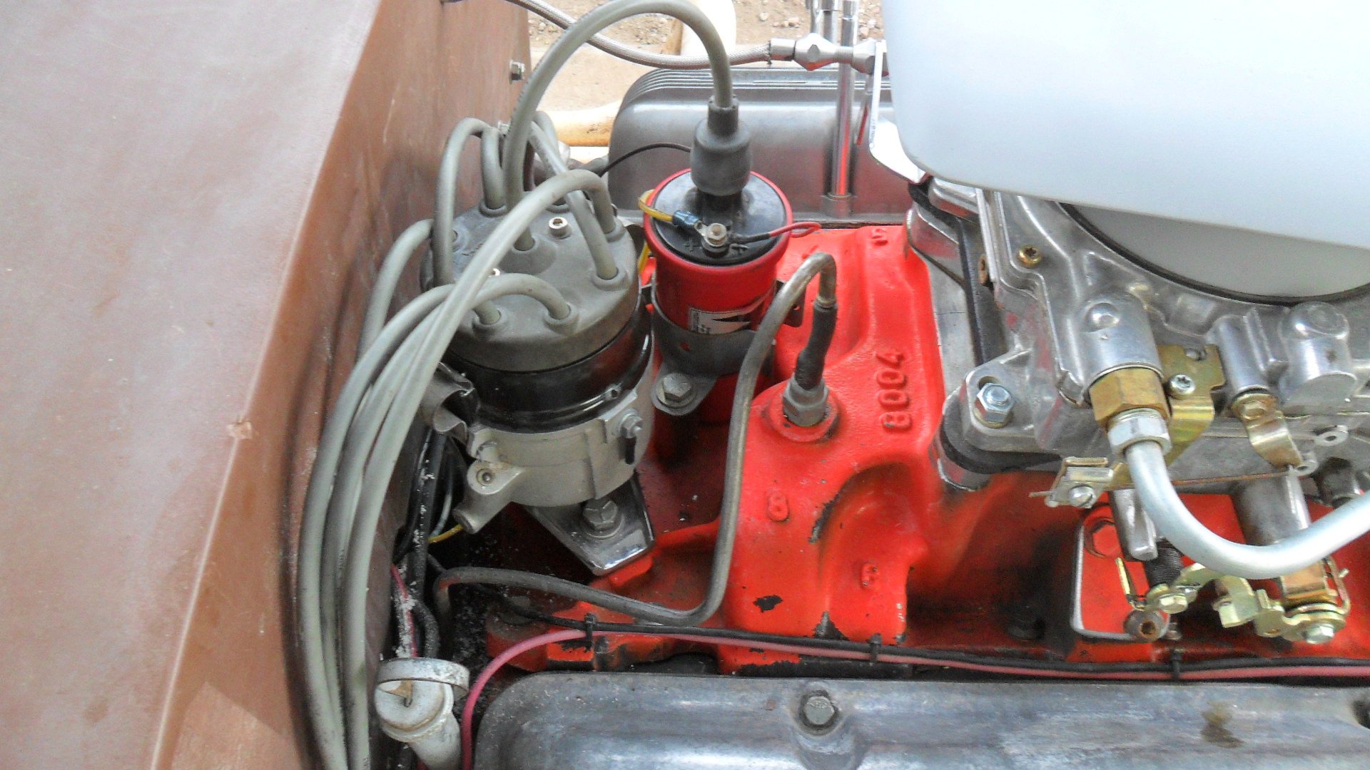

  4. And we just keep feeding my addictions....just bought another 54 '60's Hot Rod, Car Craft, Popular Hot Rodding, and Rod and Custom magazines on ebay.

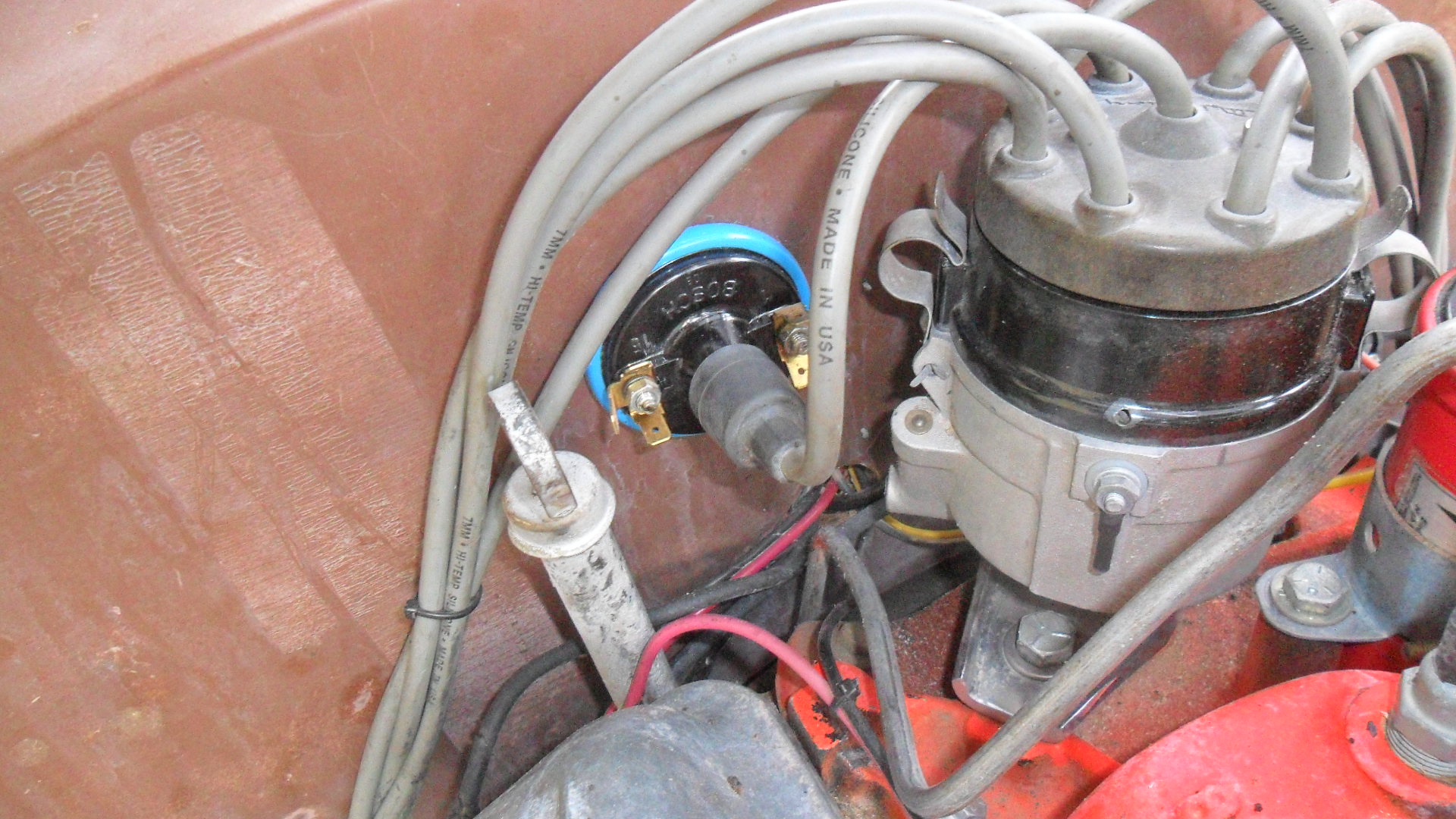

  16. Fuzzy Knight
    Joined: Jun 8, 2009
    Posts: 11,806
    Fuzzy Knight
    from Santee, Ca
    Chip if you look at the pic down under the Alt you can see that I mounted the coil to the fuel pump block off plate.

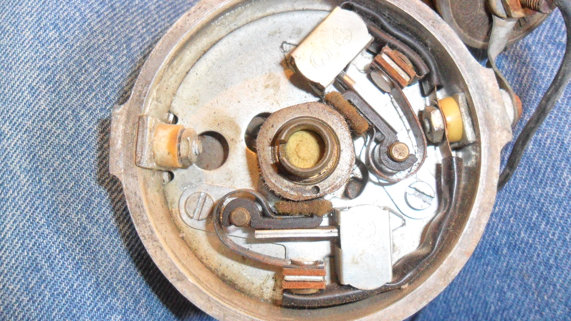

    Okay guys I doubt if I ever change anything on the dist. on my roadster or 48 Ford. (both early '50s Cad. engines. Top two photos). But the '60 Chevy. dist. in my 48 Plymouth (Bottom photo) is a different story. And you MoPar guys I've heard all the guff about a Chevy engine in a Ply. so save it. The Chevy. 283 in the Plymouth although it is running beautifully with all stock stuff if I can pick up a mpg or two it might be worth some change. So educate me in the best, easiest, cheapest way to upgrade to something better, more reliable and longer lasting than what I have.
    Thanks Gary
    Oh and you guys following Chips thread and not really building period correct cars. I can tell by your latest posts that you are at least listening to what is being said thus keeping some of the ugly out of whatever rods you are building.

    You got me there. I haven't run points into an MSD. I have run AN MSD Distributor and Chrysler electronic, however. I'm well aware of how it works, and haven't had reliability issues with either. That still doesn't account for the distaste of the Pertronix stuff. Unless you do something monumentally stupid, as I demonstrated the other night, nothing will kill them. And, as I aluded to earlier, 25 some odd years ago I saw 16 H.P on a dyno out of a high caliber VW bullet with the addition of a simple drop unit and coil. The points were floating and packing it in at about 6000, and that was the much vaunted "black stripe" points of the day. My buddy the dyno owner and engine machinest/builder Mike Fischer suggested I "come out of the cave era, and go with an electronic". instant 7000, and another 16hp at the top end of things. I haven't looked back since. So that's enough on that...
  19. need louvers ?
    Joined: Nov 20, 2008
    Posts: 12,901
    need louvers ?
    Hey Gary,
    Don't let anybody mess with you for the small Chevy in a '48... Mine has a WAY expensive, WAY breathed on small Chrysler that came with quite a learning curve and works great, but if I had it to do again it'd be a small Chev. Matter of fact, with a couple hours of engine mount fab work, a small Chev would slide right in. Then, maybe the Chrysler guys would leave me alone and not follow me around.
    As to how to improve what you have? Well, I'd dig up a Mallory YC like mine or your other one, and do the Pertronix and matching coil. The distributor has a fairly nice advance curve, and looks good too. You could go the next generation Mallory (YM? I can't remember...) and do the same. These seem to have about 22 degrees of advance built in, which for me works great with about 14 initial and 36 all in at 23-500 or so.
    If you know someone who still has a distributor machine, you can have the curve quickened and tailored a bit in what you have, if it's in good shape, and add a Pretronix and coil, or just new points, or even Georges fave, an MSD box and coil triggered by the points. He's absolutely right in that it simply become a low amp switch to tell the box what to do. I love having lots of zap at the plugs to do my bidding. Going this route with what you have also keeps the advantage of the vacuum advance which adds advance in at steady state cruise, and usually nets a bit more mileage on long straight trips.
