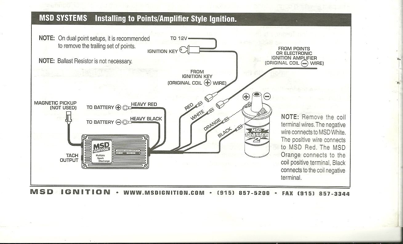

    Man, I wish you hadn't done that George! It was damn good tech. Damned useful too. And, it might have sounded like we were disagreeing, we weren't, we were going to different viable directions to get to the same goal, improved ignition over the points that are present. There just isn't the room to hide an MSD box on this car as I would like.
    I don't know of any way that these posts are saved, but if you can restore them, please do.

    George, I wasn't disagreeing with you. Your writings on going through and shortening the slots on the Mopar distributor to allow more initial advance is something I have done on several occasions in years past, and was a well written bit on how far we go sometimes to make things work correctly. Trust me, thee are several people that roll their eyes and go comatose around the Phoenix area when they ask the simple question of me, "how do I make this work better?" As to the other *****ing? Gotta remember, not everybody wants to work at this as hard as we do sometimes.
    It's just that right now, an MSD box isn't in the wallet for me, nor with the shallow dash in this car is it very "hidable". Under the seat is out as well, as I have just enough room under there for my sample pieces, flyers, and picture book of stuff I've done for when I go to shows to promote my business. That and I have had very good service with the Pertronix product, and while not in the same league as the MSD stuff, it is a very worthy upgrade over the stock points in my opinion. It also has a tendency to get trashed around here on a fairly regular basis, mostly because of incorrect installation. I wanted to set the record straight and show what I was doing to solve the problems I created. Nothing more, nothing less.
