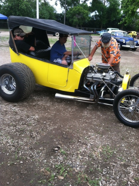

    Maybe this is a bad question, or a bad idea, but has anyone ever built a snubbed touring body? Like you have the front half of the touring body unmodified, but basically remove the back seat and rear doors to **** the back panel up against the rear door flanges...if that makes sense. My car has a pretty short wheelbase, and I'm wondering if it would be easier for me to come up with some touring panels rather than cut up either an A or T bed (the guy I got the body from had quite a bit of touring stuff but no pickup beds up for grabs). I'm thinking I MIGHT get a little extra storage out of that idea rather than hacking up a pickup bed... Your thoughts?

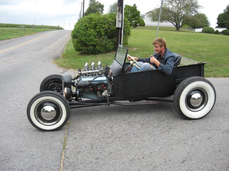

    Here is shortened touring that has been around a while, friend owned it in the early 70's, it still had a nailhead, '39 trans, and banjo rear at that time (it also had psychedelic paint and Indy tires). Not too traditional then or now; but it may have been in an earlier version.

    Hmm...I kinda like that look. Slightly different, but not over the top. On the other hand, I just went thrugh Blue One's thread again. This time what he did is a lot more relavent, so I picked up a lot more this time around. I like how he built his pickup bed and how he widened the back panel of the tub to mount flush with the body sides. Extremely impressive work to say the least.

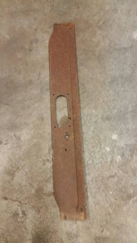

    Cowl (with brackets/braces that seem to get in the way of mating the body sides to the cowl)

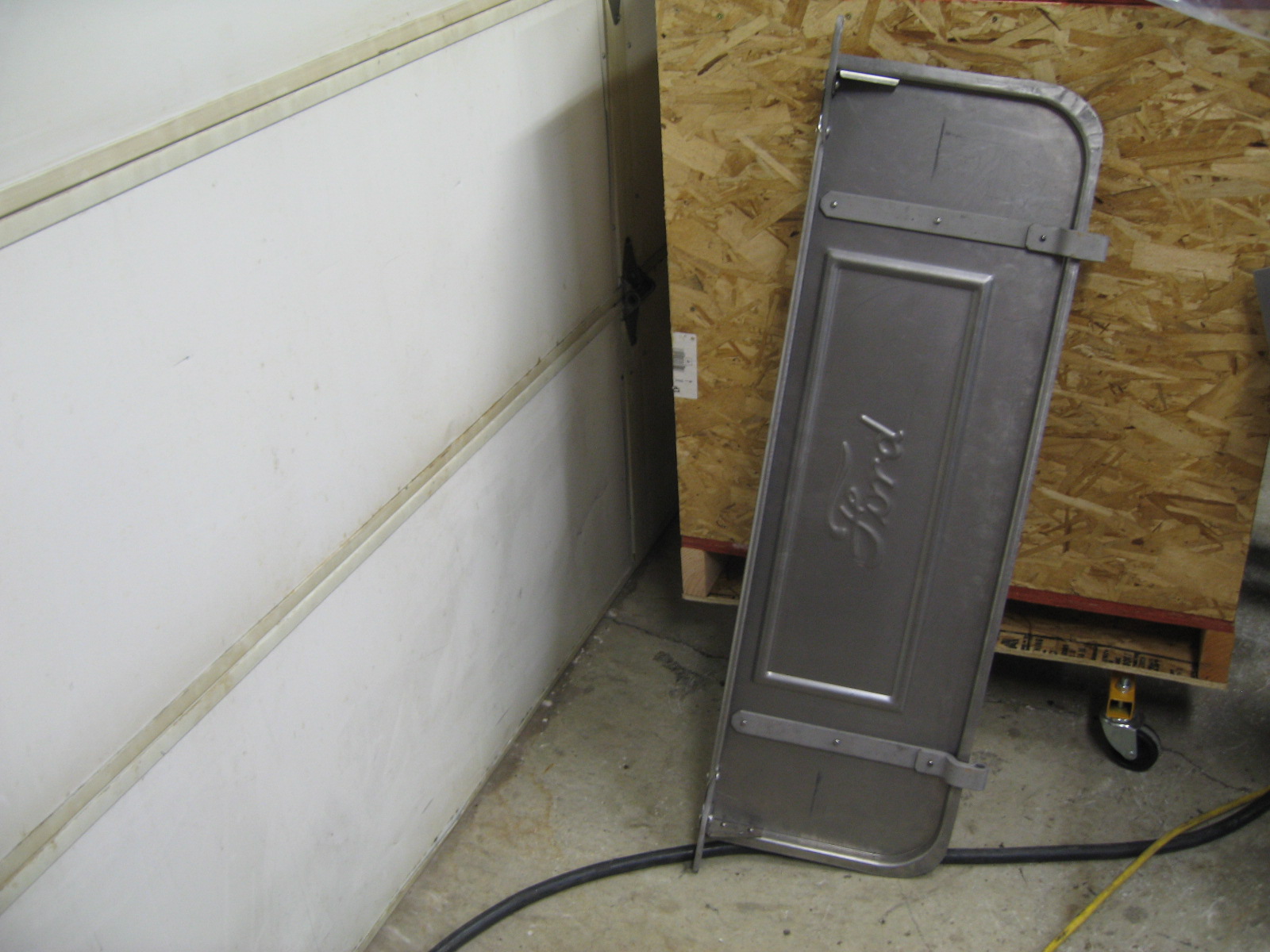

    Hi Tim, The repro tailgate I purchased is a model A tailgate, and I also purchased the formed curved rail that the tailgate hinges mount to. I narrowed the tailgate 4" ( 2" cut out of each side under the tailgate hinge straps) to better suit the dimensions of the T body and also narrowed the curved rear rail section to match.
    As you can see I then built the rest of the bed to suit what I had and wanted.
    You mentioned the rear section of my body, I did widen it to match the side panels and as you saw on my thread I also then completely rebuilt the back of the body including the top rear lip of the "tub".
    Larry

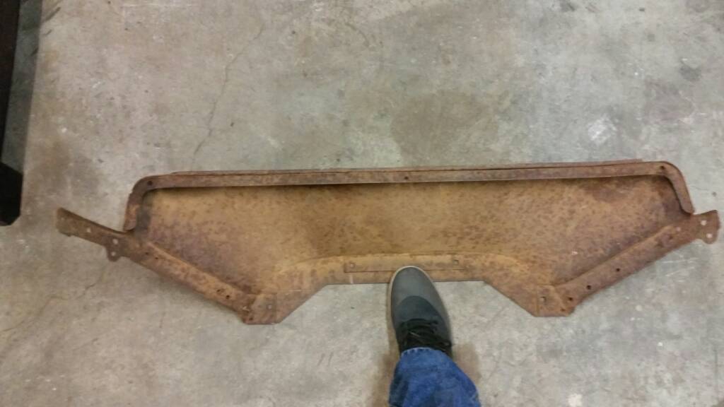

    Dash, door, seat frame, and back panel. The dash and seat frame are pretty scaly and pitted, not sure if I will use them... The door is kinda pitted too, but I think it will clean up ok. I have hinges somewhere, just need a latch.

    Something that you will find with the old metal T parts Tim is that they won't fit together like you might like them to or even as nicely as newer metal parts will fit.
    If the parts came from different cars it can be even worse.
    The best thing to do is to look at pictures of how they go together and then you can decide if you want them together differently ( like I did with widening the rear of my "tub"to match my side panels)
    You can then modify and ***emble the body to suit your taste in how you think it fits best.
    Larry.
