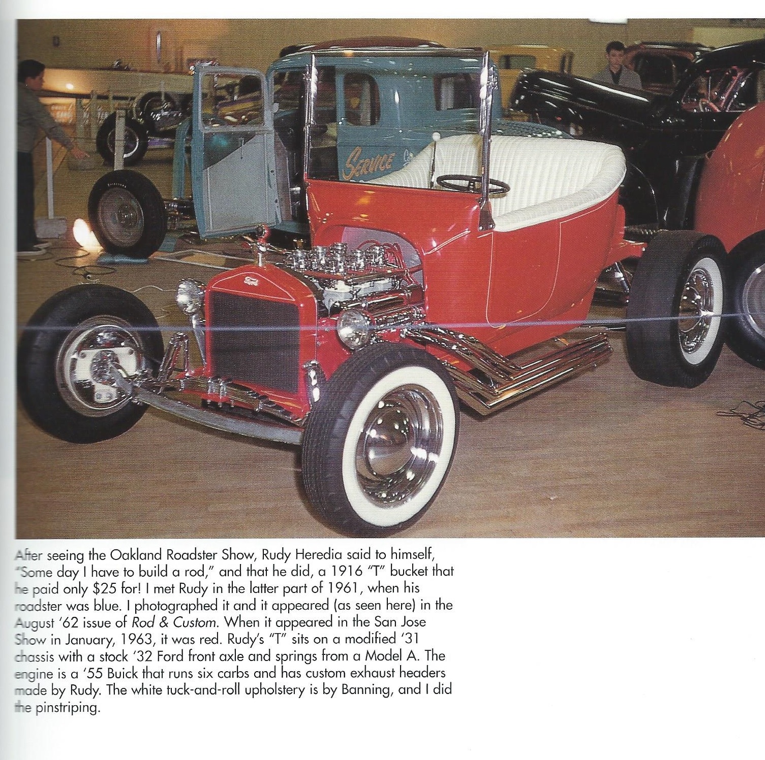

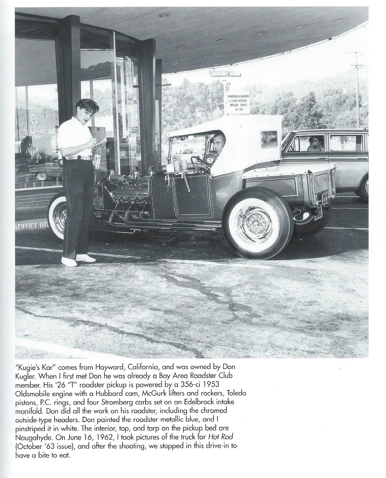

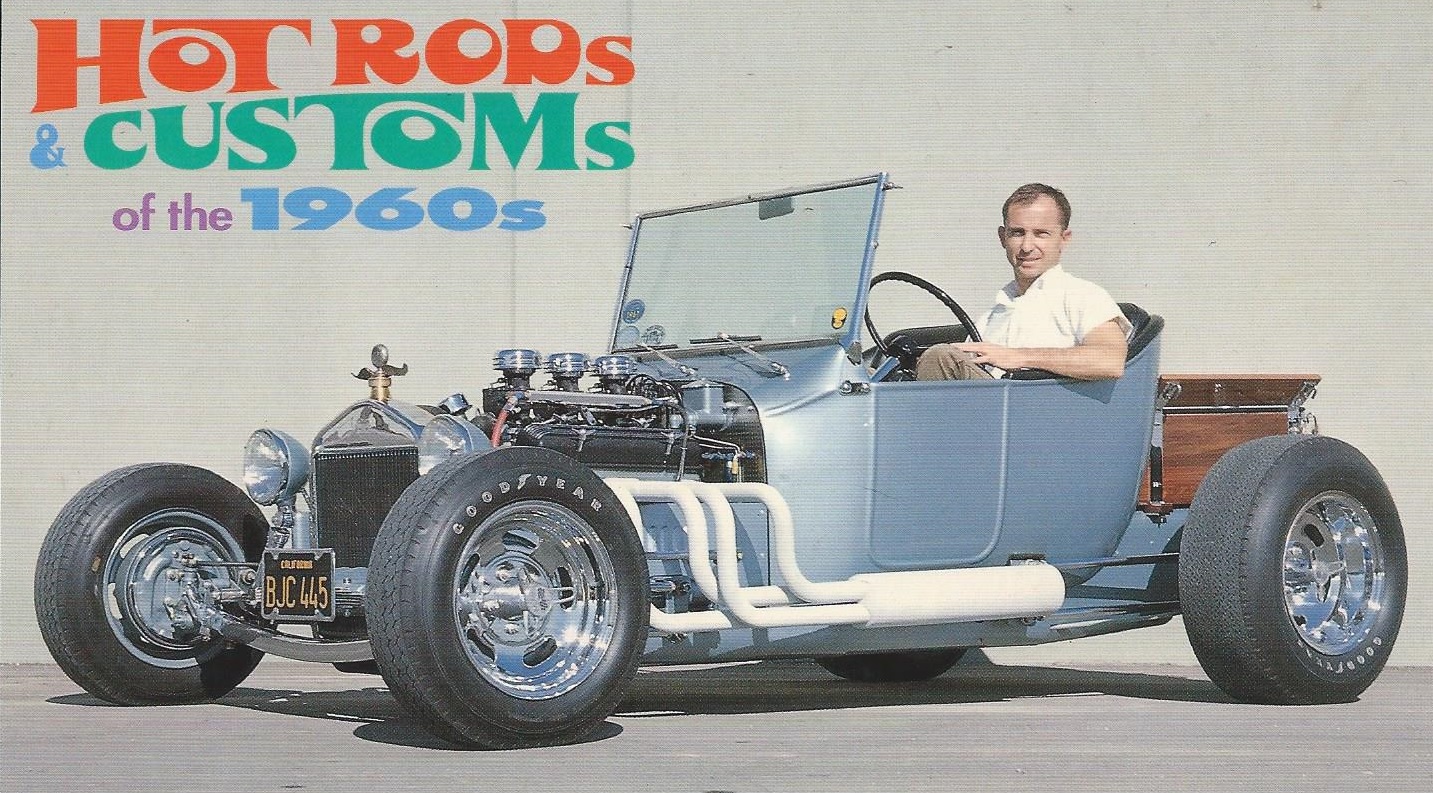

    Guys, here are a few T-buckets scanned from Andy Southard's "Hot Rods and Customs of the 1960's". Full credit goes to him.

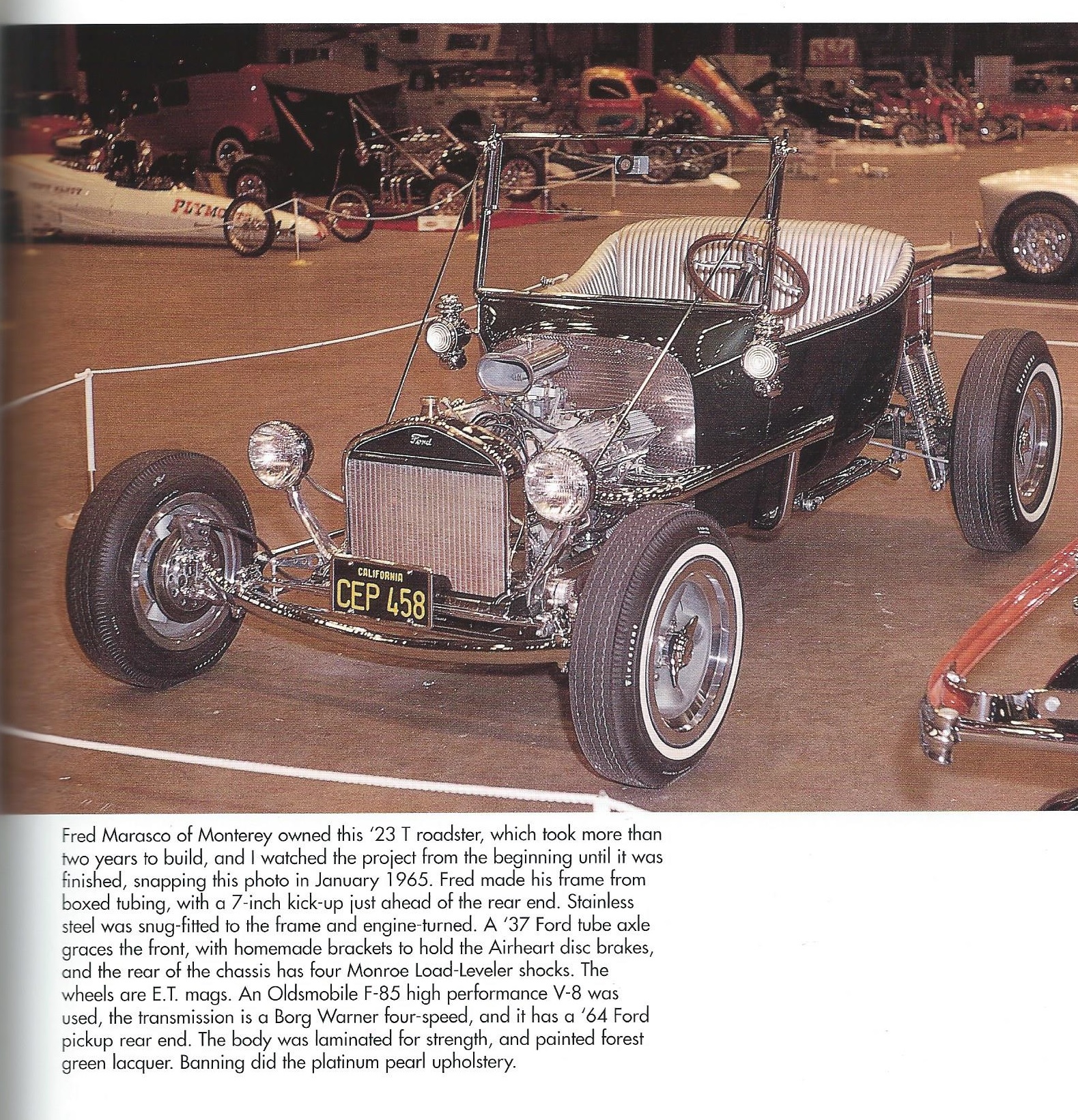

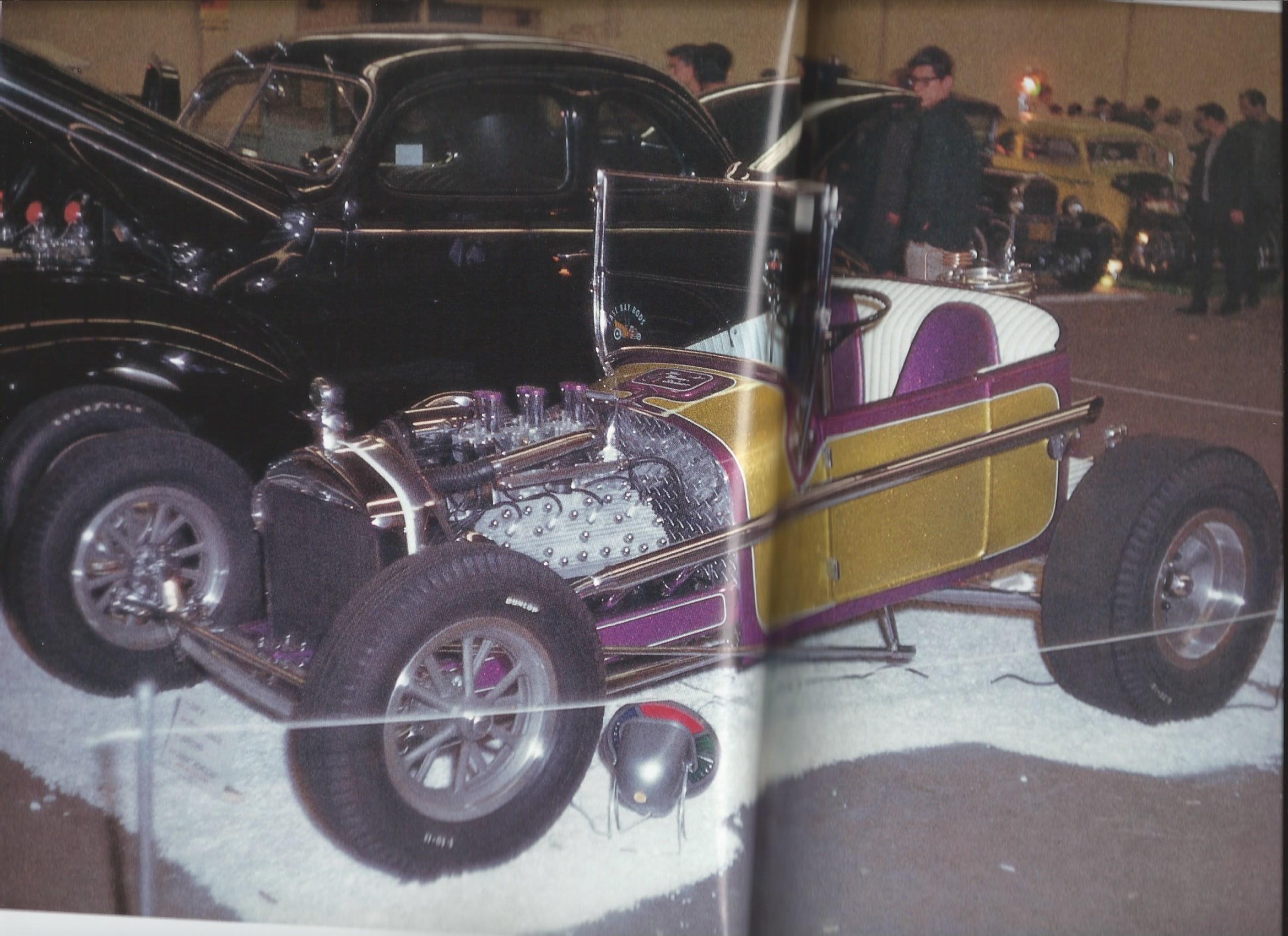

    A few more from Andy Southard's "Hot Rods and Customs of the 1960's". t 04.jpg t 05.jpg t 06.jpg

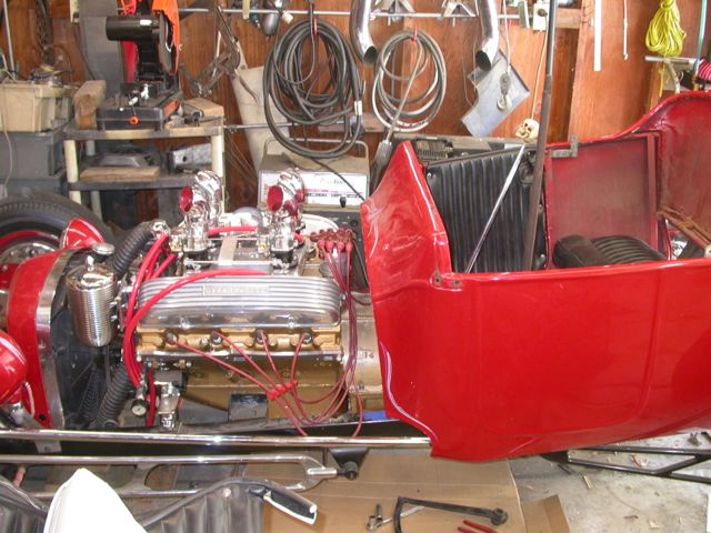

    DSCN2050.jpg Seriously Fred when I had the SBF in the roadster I used a G.M. alternator. I just bolted it low with a long bolt and aluminum spacer.

  27. Just Gary, the first picture you posted of the "T" at the drive in, would that be at the corner of Lewelling Blvd. and Mission Blvd. in Hayward? And also Keith Bush's black full fendered 32 sedan is the one that went upside down as a Highboy a few years ago in Washington state. He still owns it, and it has been fixed and put back to the full fendered state just as in the picture.

  28. Also, I believe the pearl yellow Vette behind Himsl's tub is the one that had all the chrome done in black chrome, and the interior was black diamond tuffted with all the ****ons being black chrome pennies.
