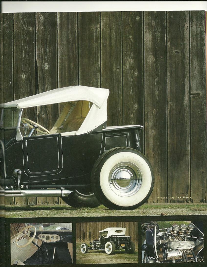

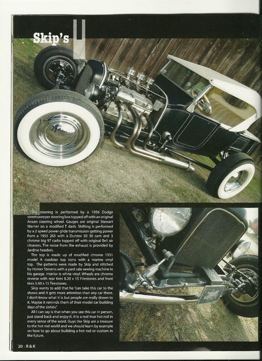

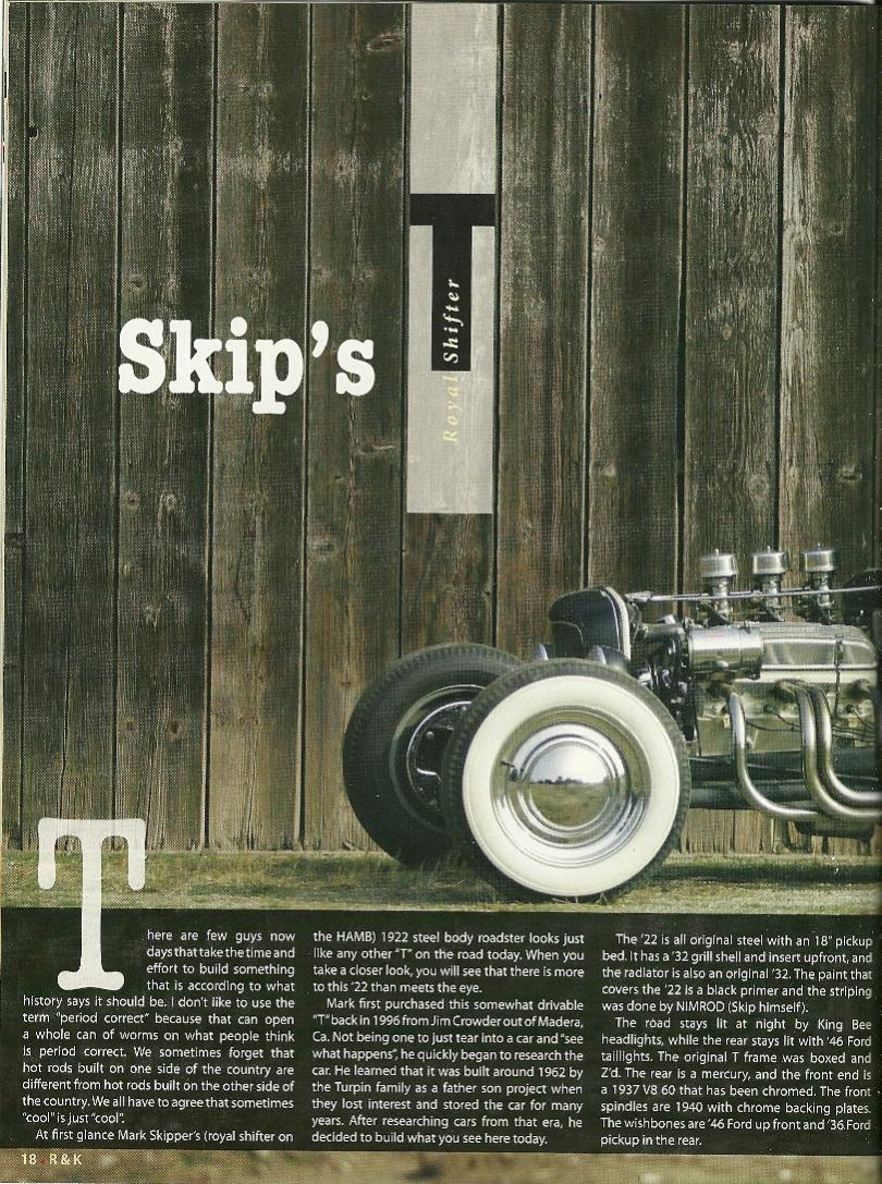

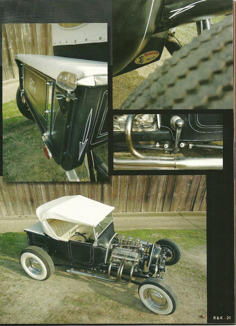

    Hey gang, back in from the shop. As promised, I scanned Royal Shifter's 'Bucket, and here it is.
    Now, I owe Harv117 and Gary SteelRebel and apology, as I remembered it wrong and this one IS on a modified stock frame. I too looked at the low angle shot of it and mistook the wishbone for the stock "T" frame taper.

    Thanks for posting the pics of Royal Shifters car, Louvers. It confirmed what I was thinking that top looked like.

    Damn good eye on that one too! I would have never put my finger on that being "A" based. now I know what I'm looking for if I even get to that point with mine.

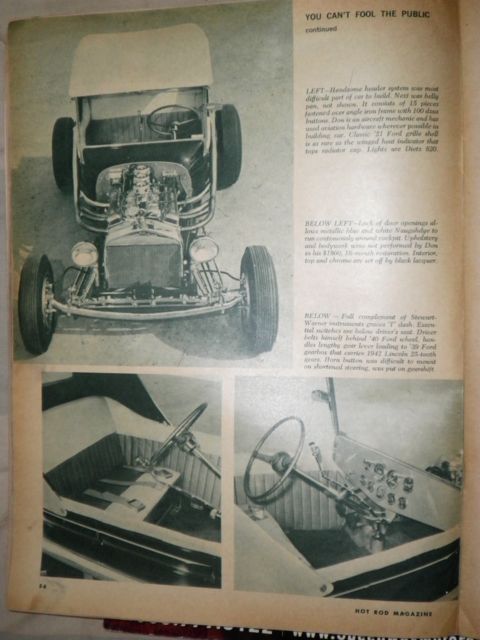

    Rebel, there's something crazy going on with that dash and I like it! Do you have any pics of it?

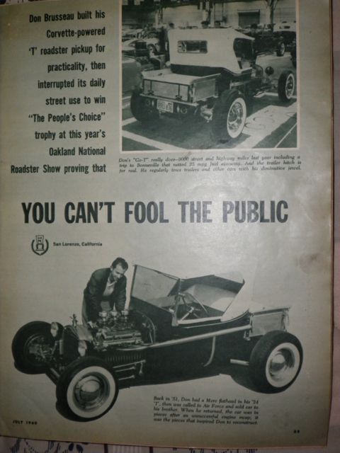

    For some reason I kinda had a hunch that was the car you were after.

    Sorry to say Don died a couple of years ago too.

    Interesting to see a 4 bar front suspension back then. Certainly not the norm on a T Bucket, even today.

    Don was quite a craftsman. According to his friends he had one of the first "man caves." Early '50s tract house in San Lorenzo. Attached two garage opened up to the detached man cave garage in back with all the build equipment.
