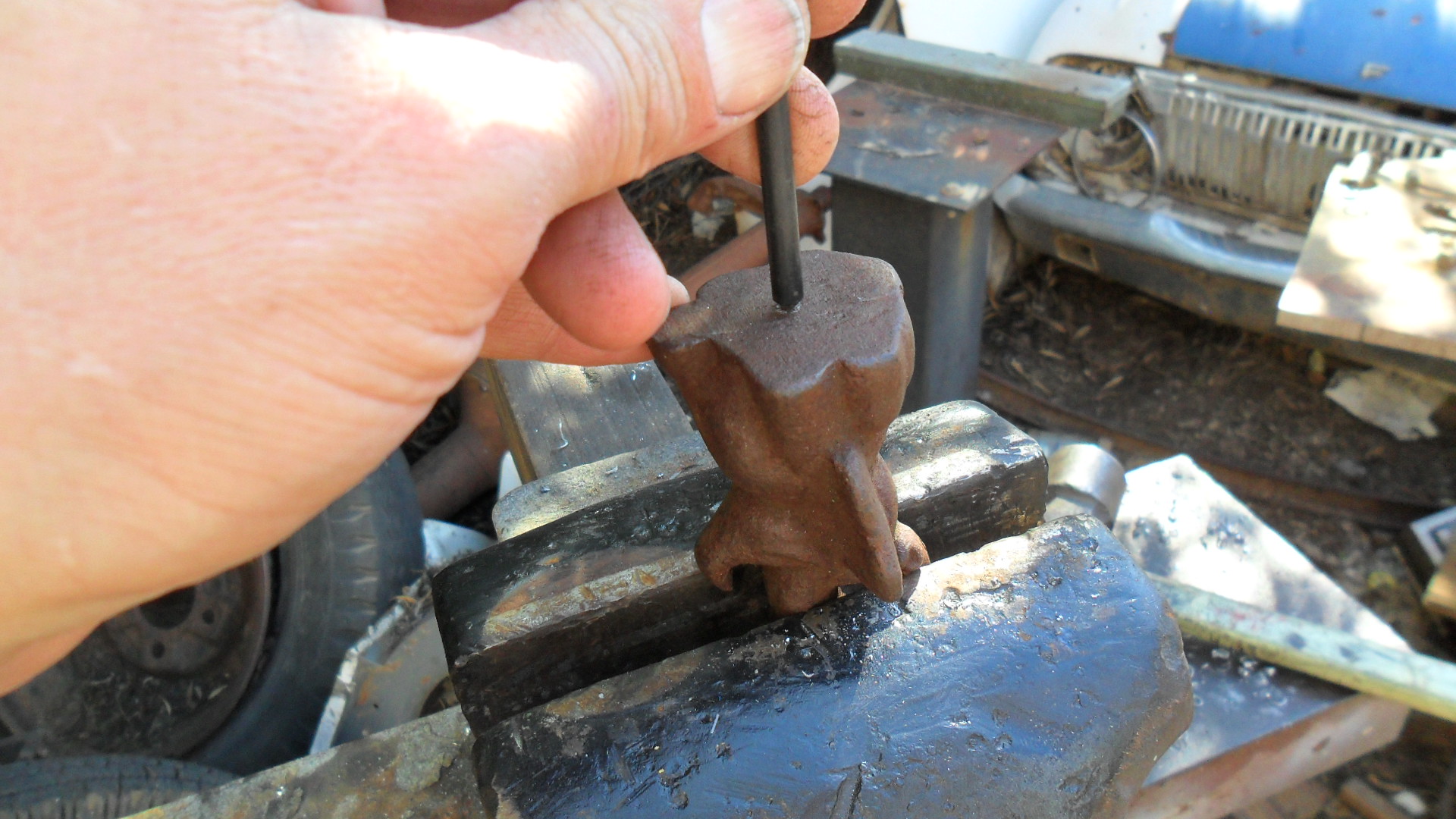

    Drilling the hole was more "close one eye, hold your thumb up, hope and drill" kinda stuff. This again was done on the drill press. SAM_4766.JPG
    So, ya, as uncomfortable as that looks, I started it with a starting drill, (They are about 8.00 at Harbor Freight, and some of the best money spent!) and then drilled it up for the next phase... WARNING! THE FOLLOWING PICTURE IS KINDA GRAPHIC! SAM_4768.JPG

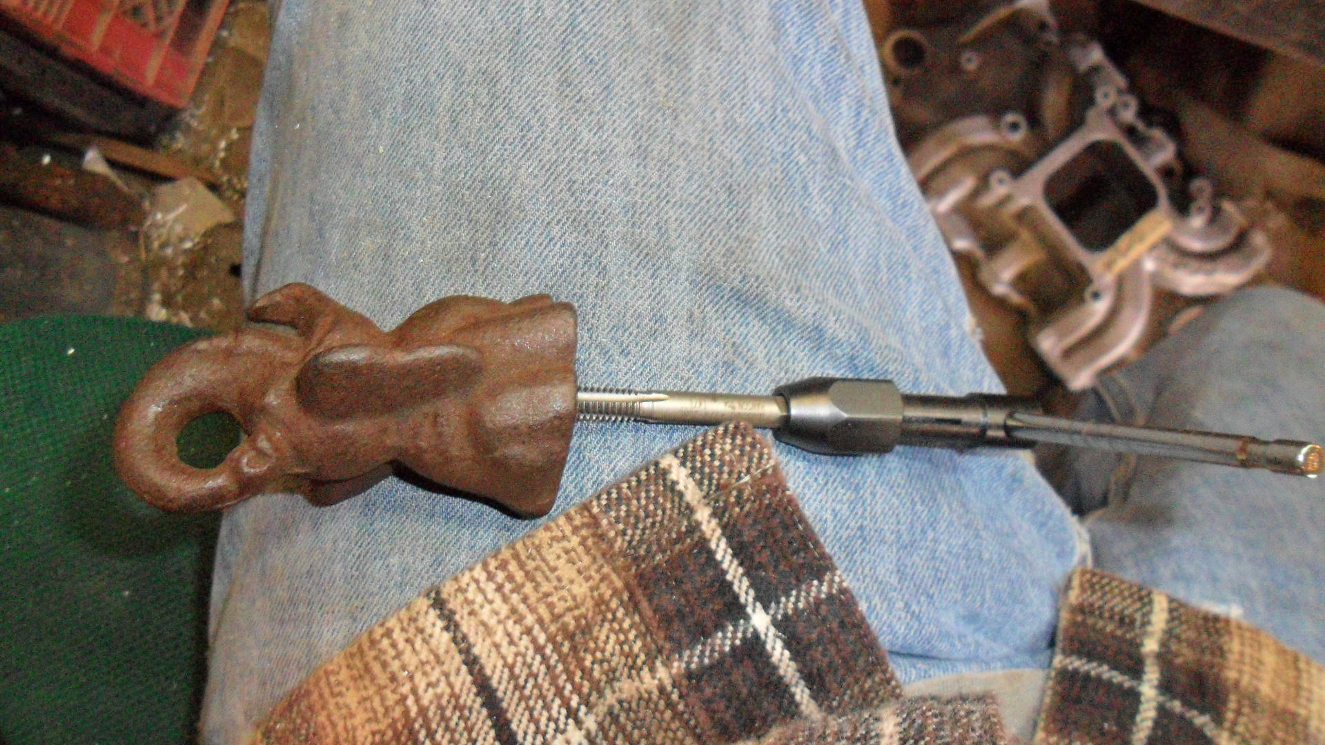

    We are tapping him! The expression on his little face made me wince a bit as I carried out my mission, but fear not little buddy, it's hurt lots less from here on out! 1/4"-20 is the rule here.

    LOL...so it is. Still could have been worse. You did use some lube on there, right?

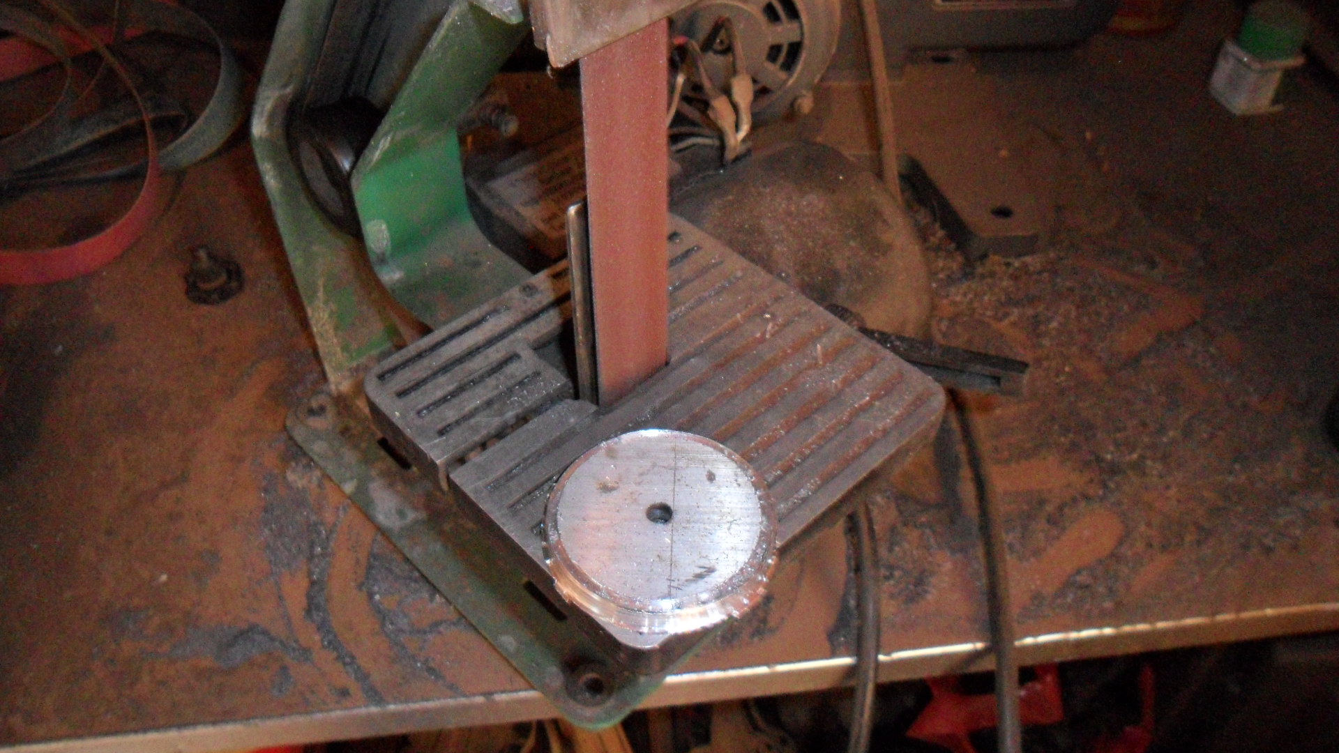

    So back to my aluminum blanks. They spent a few minutes on the belt sander getting some of the ugly knocked off, course belt screaming away! Kinda like this... SAM_4769.JPG

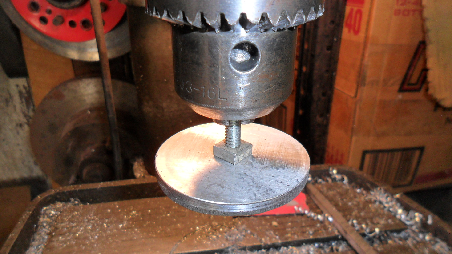

    Next I wandered over to my nut and bolt bin, and grabbed a long 1/4"-20 bolt, and a couple of nuts, and screwed the whole deal together through the 1/4" holes in the blanks, then mounted them in the drill press. I then took a minute and changed the belts around so that the drill press was just flat rockin', going as fast as it could. SAM_4773.JPG
    'Cause now it was time to start making this thing round, and giving it some shape. We are going to do that with a highly scientific way, with sandpaper and a backing board... We'll start with really course stuff to get the shape. SAM_4775.JPG
    Just realized this all the lower piece with the super shallow step.

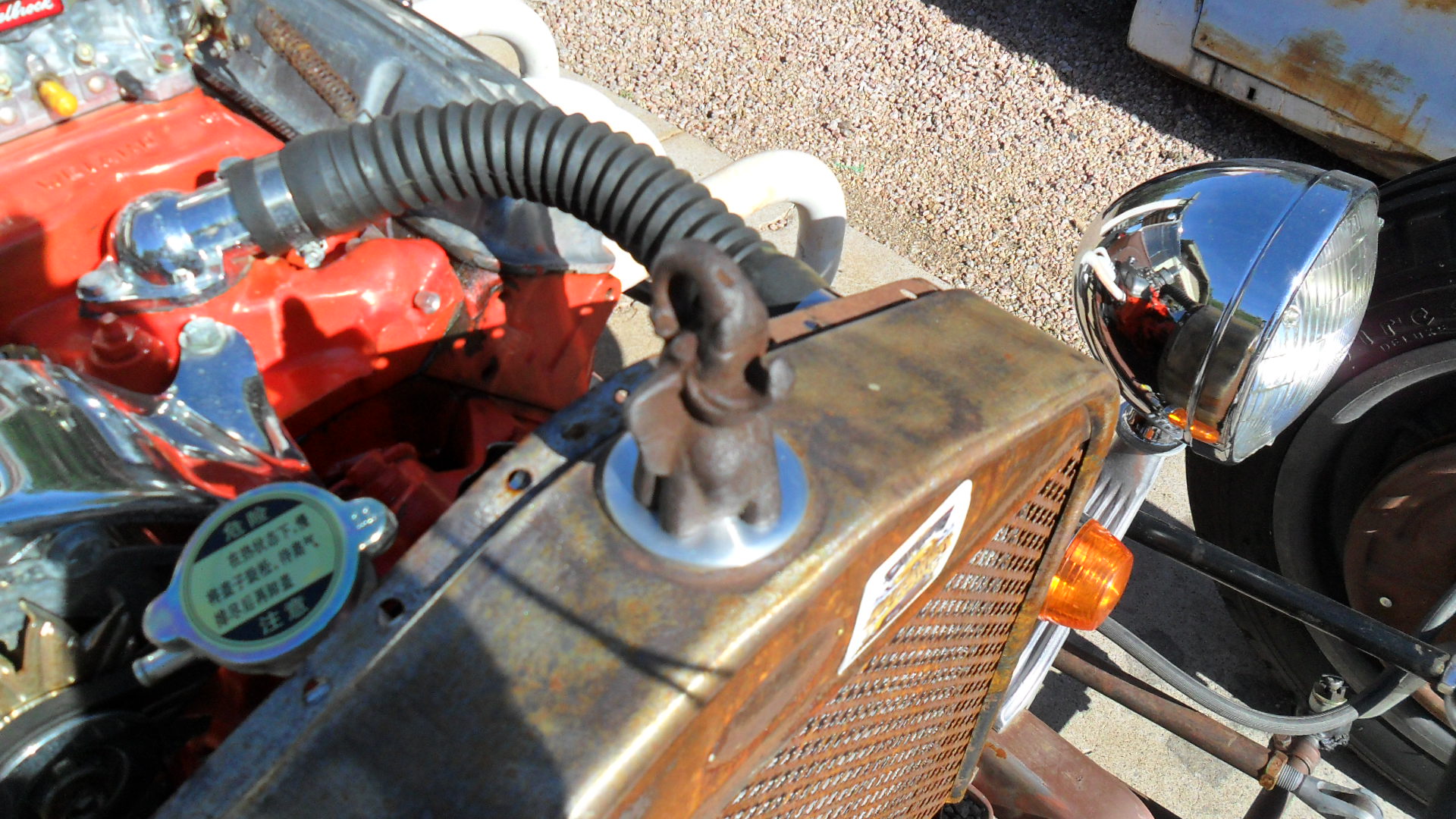

    Okay, Back to the top piece with the step you saw machined earlier. It was shaped the same way you saw earlier, but more so, so that the base has a slightly round contour, we can't have this looking like "billet" , after all. I don't have any pictures, but the step we made earlier was sized and refined with a flat file CAREFULLY as the drill press was spinning away. CAREFULLY being the operative word. I simply filed at it until it fit snuggly into the radiator neck hole in the shell. Then the whole deal top and bottom was finished up and cleaned up with 180 grit sandpaper back on the drill press. Looking exactly like this... Though not quite as blurry in real life, for some reason the nice copy wouldn't load. SAM_4783.JPG
    And with a 1/4"-20 stud and nut and bolt, we ended up with this ... SAM_4787.JPG SAM_4789.JPG
    And that folks, is how you turn your basic antique store chochski into a cool and different little radiator mascot...

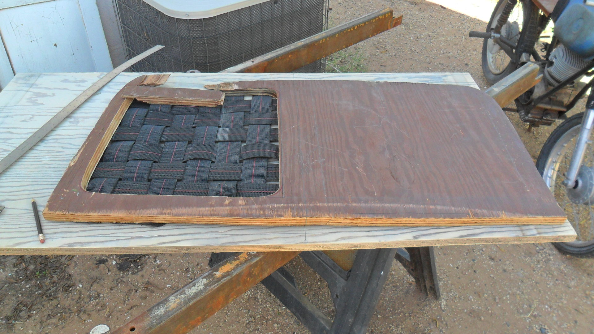

    I had to make a new seat base. I let Kurt drive this thing earlier in the summer, and he is your basic Migilla Gorilla shaped guy. I'd say about 6'6" and 265 ought to be about on it. He took off down the road, came back with load of hardware, and later I jumped in the car and knew right away something was wrong... he broke the seat base! no great loss, as it was made of s**** **** that he and Roy found in the alley, and it showed. I was determined to do better. SAM_7100.JPG
    I used a chunk of 3/4"marine ply that I had laying around from a previous project. It needed to be sanded a bit to smooth it out further, so out came my handy dandy Bosch sander, complete with 220v to 110v converter, courtesy of the Hong Kong airport. See, Judy's brother in law's Brother, (wheh!) beyond being one hell of a neat guy, wants so badly to come over and play hot rodder. he swears soon he'll have his visa and be able to spend some time here, and I'll corrupt him the best I can! Well, long story short, he is an A&P mechanic at the Hong Kong airport, and every time a tool is de-commissioned due to a flaw, (and with those boys a scratch or dent is enough for a throw away) he grabs it and saves it until Judy gets to town. Then he sends it home with her with the simple directive, "use it to build hot rods". I frequently send him pictures of what I'm doing, and hope he gets here some day soon.
    A very important design element on this one was very simple... Rounded corners. See, when you stretch vinyl over something, it is always happier going around a radius without wrinkles than it is going around a square corner. Sounds ridiculous, but it's very true. SAM_7102.JPG
    So that done, all got sanded and all the edges rounded so that the foam and vinyl will lay down nicely with a minimum of fuss. Next on the list was the hole and the webbing. Tell you what, this webbing is the coolest thing I have ever done on one of these seats in a bucket! It literally gets me down about 2-3" over just the foam, and makes for a downright comfy ride. moments after this was shot I went out and bought the rest and did Judy's side, finally. SAM_7105.JPG
    Ready for what comes next... White Vinyl!

    Chip, I just can`t stand it. I probably should just let it go, but I can`t. One of my pet peeves is evident in your Finished Elephant on the Radiator shot. Pleeeaase....TAKE THAT CORRUGATED DONKEY you-know-what UPPER RADIATOR HOSE OFF THERE AND PUT A FORMED, TIDY, WELL FIT ONE ON!!!
    There. I feel better now....It`s been a long week.....
