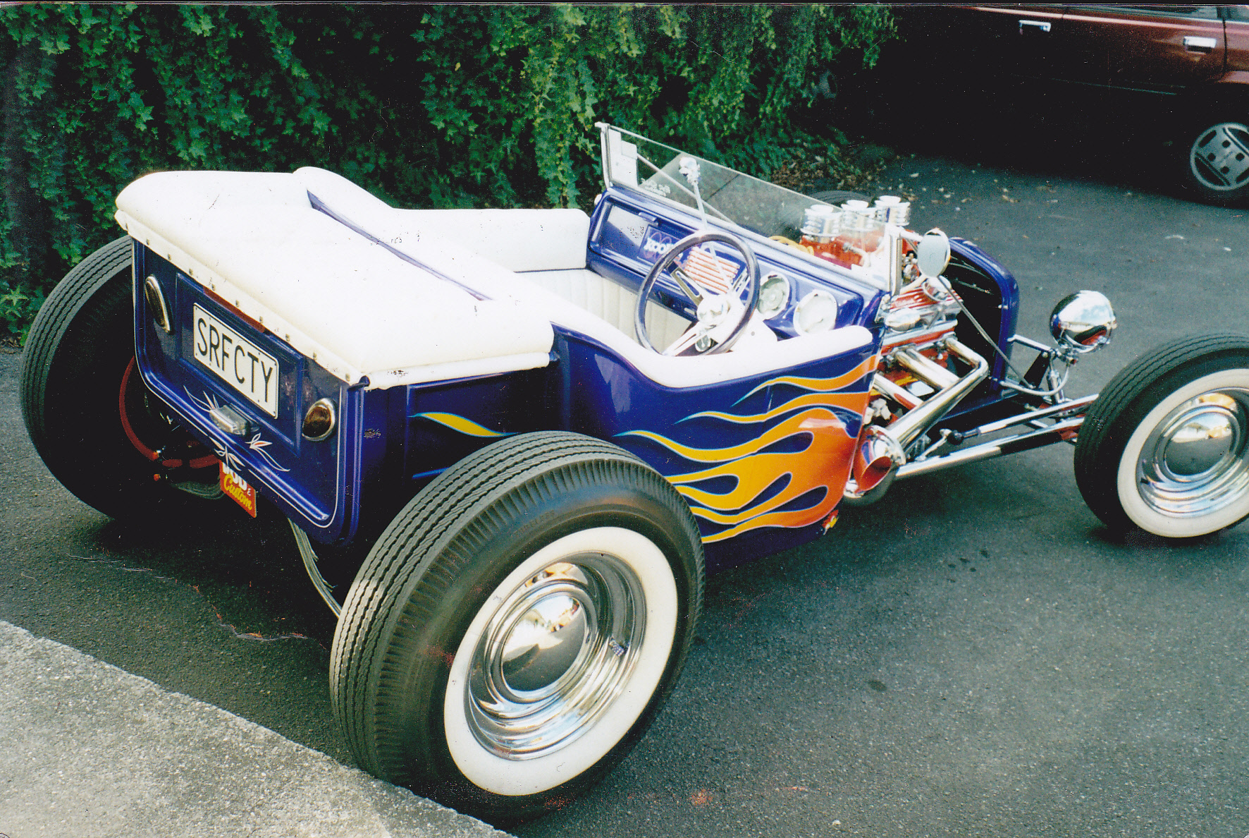

    But, since you're asking, here's what a 90 inch wheelbase looks like. Sorry for the ****py scanned picture, but the car is currently partially dismantled and this is the best pic I got! :rolleyes:
    Oh, and my crank c/l is in line with the top of the frame.
    Bear:)

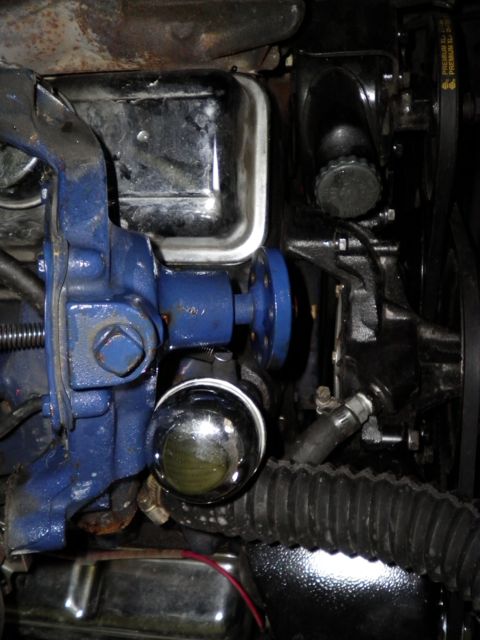

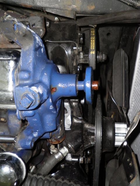

    Not sure if this helps but if I can I'll post a couple of shots of the old blue short water pump and the new one I installed on my 283. Lately I've had to post the text then go to edit to post photos.

    I couldn't see the pics also, but a quick check if you can sit the pump in place is the short pump will almost touch the timing cover. JW
  20. Still kinda hard to see, but most likely the new one is a long pump. Is that right, Gary? My CRS is kicking in and I can't remember if you have a long pump. :oops: (Why do I just KNOW someone on here is gonna make me regret that sentence!) I can't see the gap between the pump and the timing cover, but I "believe" only the long pumps had that angled heater hose boss (to clear the Alt. mounted on the front of the p***. side head.

    I can and its a long pump and the alternator bracket is also for the long pump only. JW

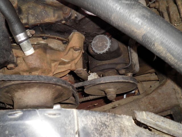

    This is the car I got all my long pump parts from to put power steering on the 283 in my Ply. I didn't use the steering box though I found a rebuilt 605 on ebay. Great little P.S. box.

    Oh **** more UGLY hoses. Actually after I put that hose on I regretted not putting a smooth one on it. Actually I think I have a smooth one that would fit in my hose box. The smooth one I had on it was too short (maybe a personal problem) after I moved the radiator forward to clear the long pump.
    You know after all the talk of ribbed hoses breaking radiator outlets I just might change it. Okay you shamed me into it.
