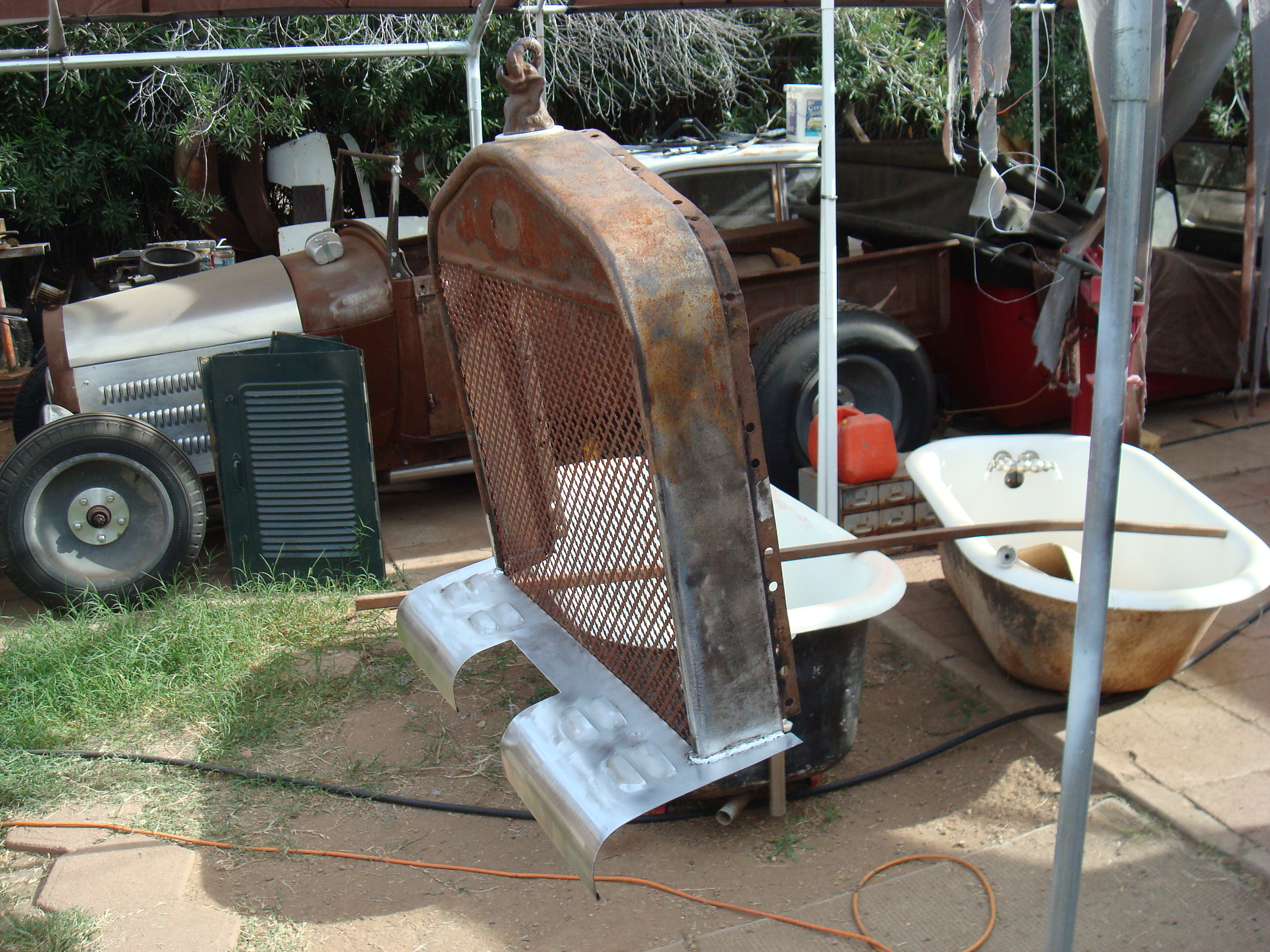

    So, I teased earlier that I actually accomplished something today! Well, I did! I even named the picture file T-Bucket progress... REALLY!!!

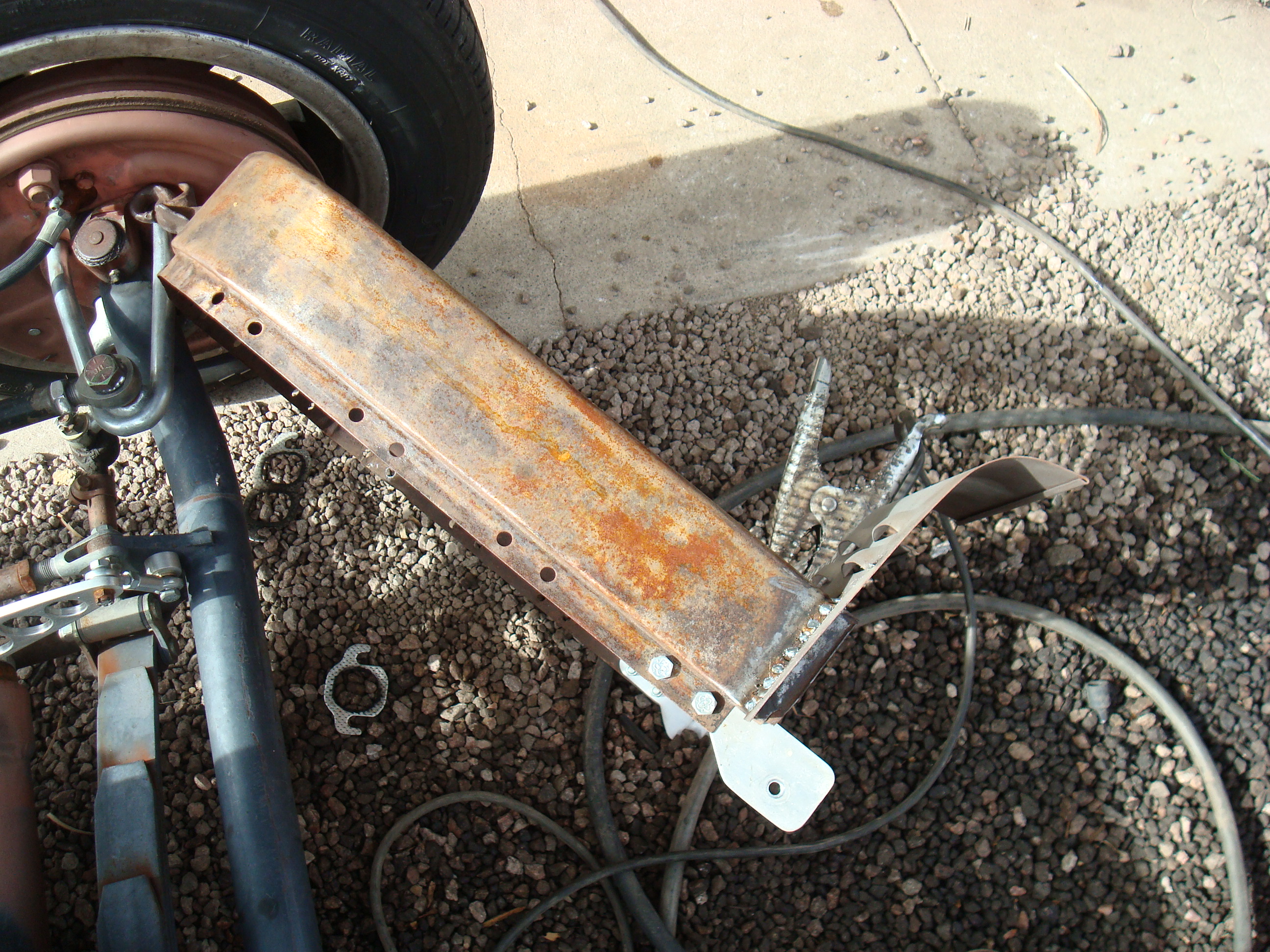

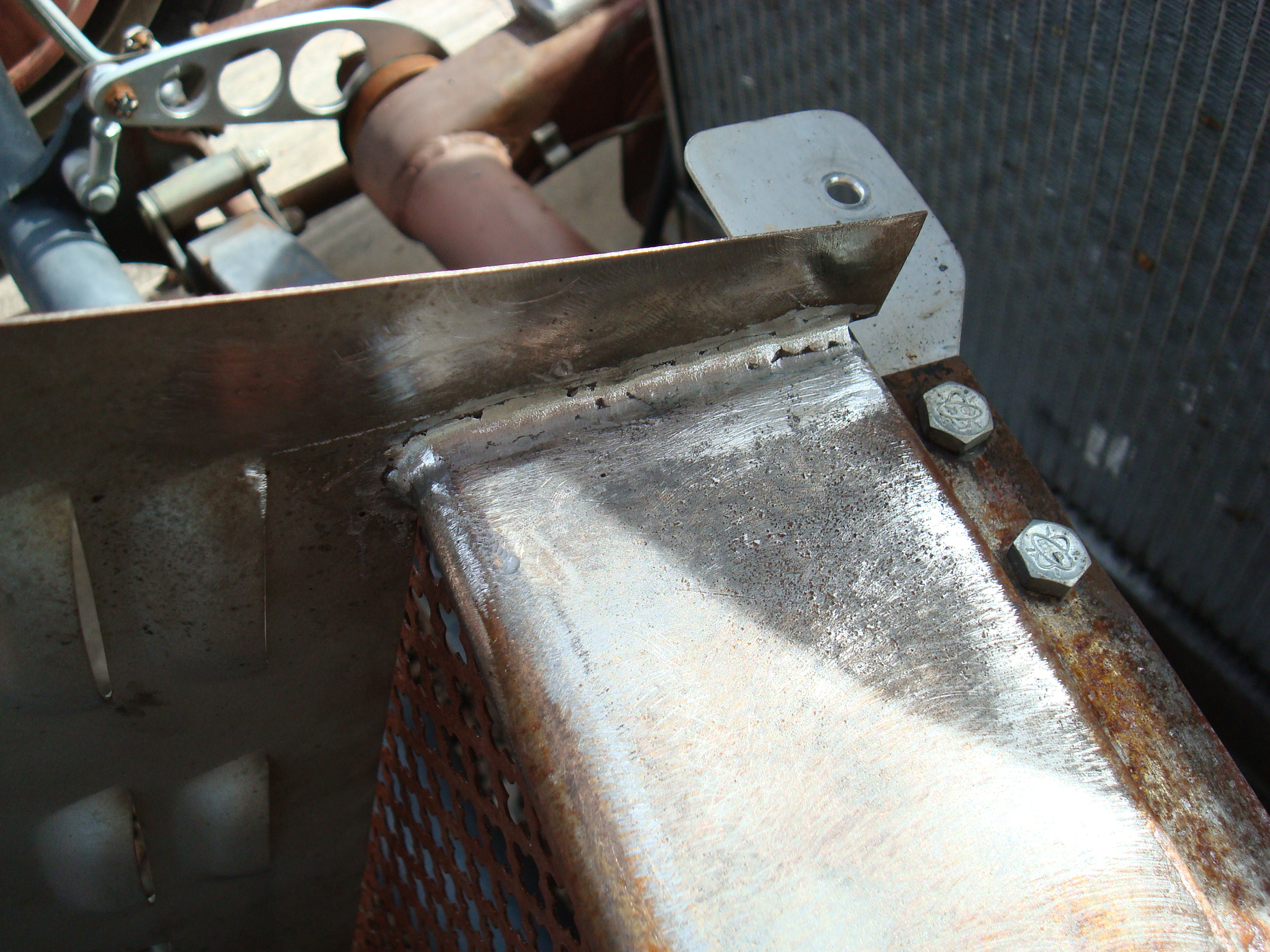

    I took some time today and decided that I would weld the roll pan onto to grill shell. I had to blast the roll pan, as it has sat so long on the porch it started to surface rust.
    Basically, I had thought about how to do this well for quite some time, and what I came up with was to tack a section of straight tubing to the pan, lay it on top of the rails, futz with what was needed to make it fit straight, and weld it in. I am happy to say that it went exactly like I wanted it too! DSC02169.JPG
    The welds were done with just a bit more oompf than you would normally put into sheet metal, just to make sure I got some penetration. I hate to admit it, but I don't have a tig welder at my place, so everything gets migged. Done correctly, there is nothing wrong with that. in this particular case, it worked even better than tig would have because of my gaps. DSC02171.JPG
    Each tack was done as far apart from the last as possible, alternating from side to side. Every tack was done in the same hand motion as well, pointing straight at the grill shell then rolling down to the pan. This put the heat build up on the thicker material, "catching" the lighter stuff momentarily. DSC02173.JPG
    After all was solid, I took my 3/8" olive shaped burr in my die grinder and shaped the weld into a nice fillet shape. In the end it'll get a finger full of schmuda to finish stuff off, but truth be told, under a quick coat of primer it doesn't look too damned bad. DSC02175.JPG

    Well, she's still cookin'.

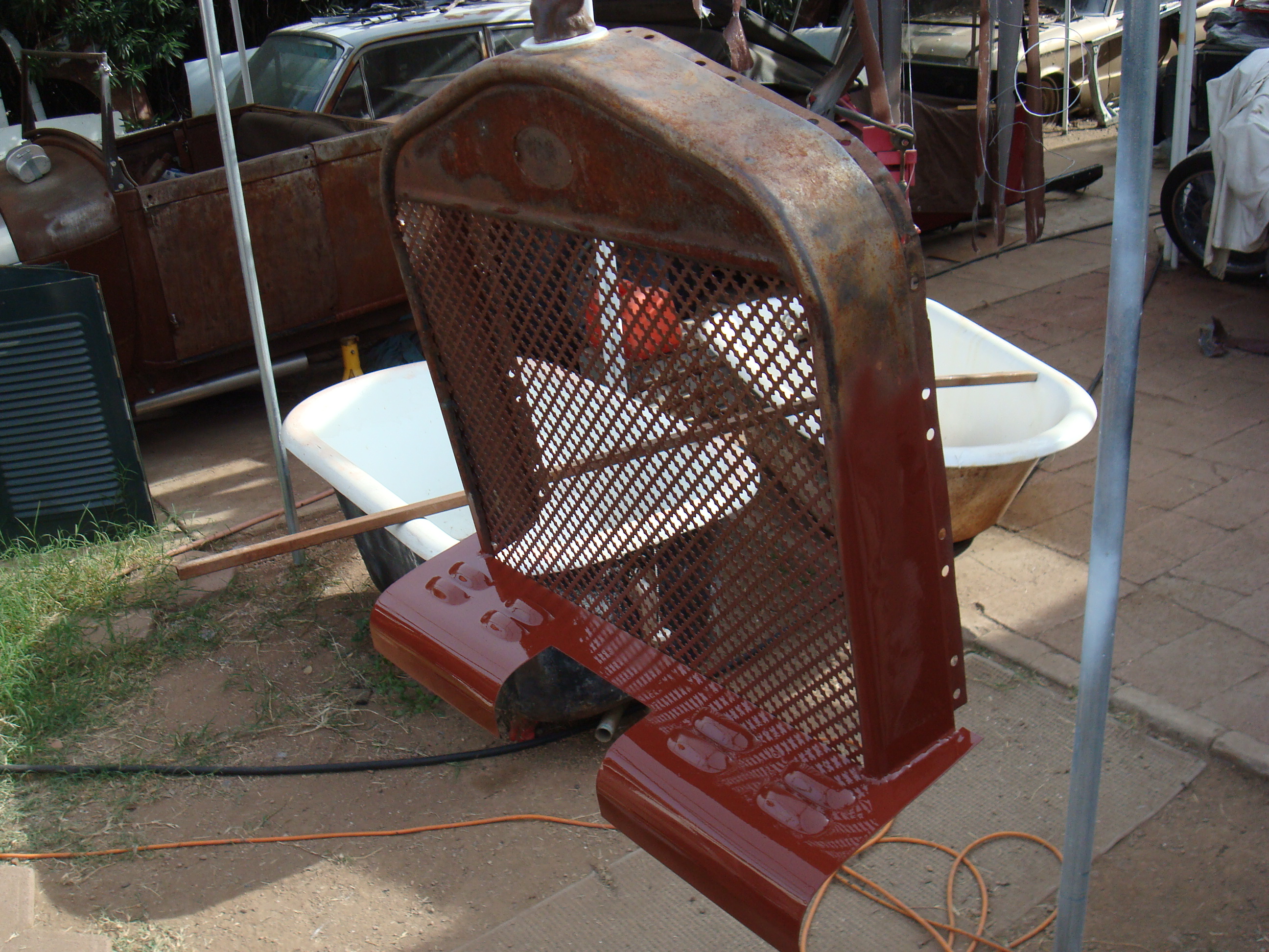

    My elephant came in handy to hold it all up for spraying! The big bummer of the day though was now it's too big to go back into the blast cabinet to get cleaned up... ****! gonna have to farm that out now. DSC02179.JPG
    A bit of last second grinding, a bit of wipey-wipey, and it got some of Rust-O-Leum's best... DSC02182.JPG

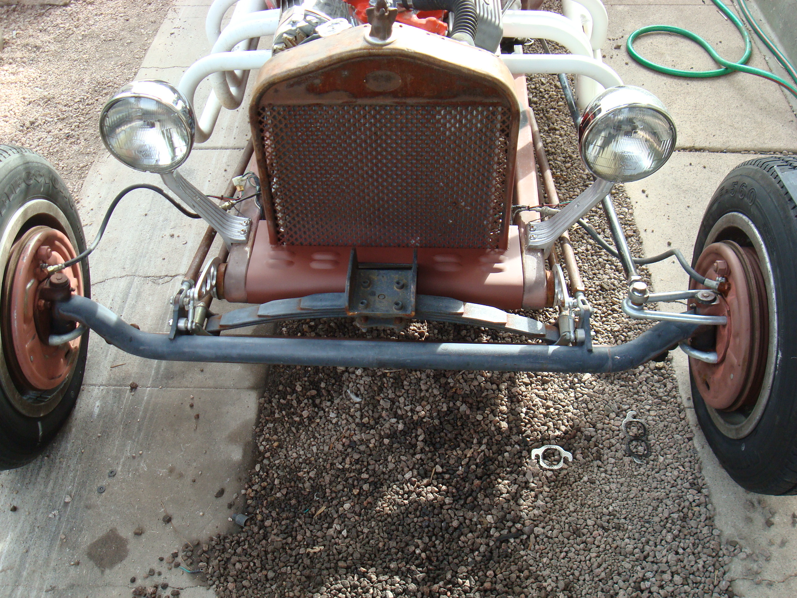

    A tiny bit more over the knee and over a piece of exhaust tubing adjusting, and this is what we have.... DSC02191.JPG DSC02189.JPG
    A bit mor t******* and some more futzing and it'll be done.

    that looks just the ducks nuts:D As you say a quick swipe of filler round the edges to smooth it out and it'll be:cool:

    Chip, it looks good, same as everything else you have done, not the least bit surprising, I may add. ;):)

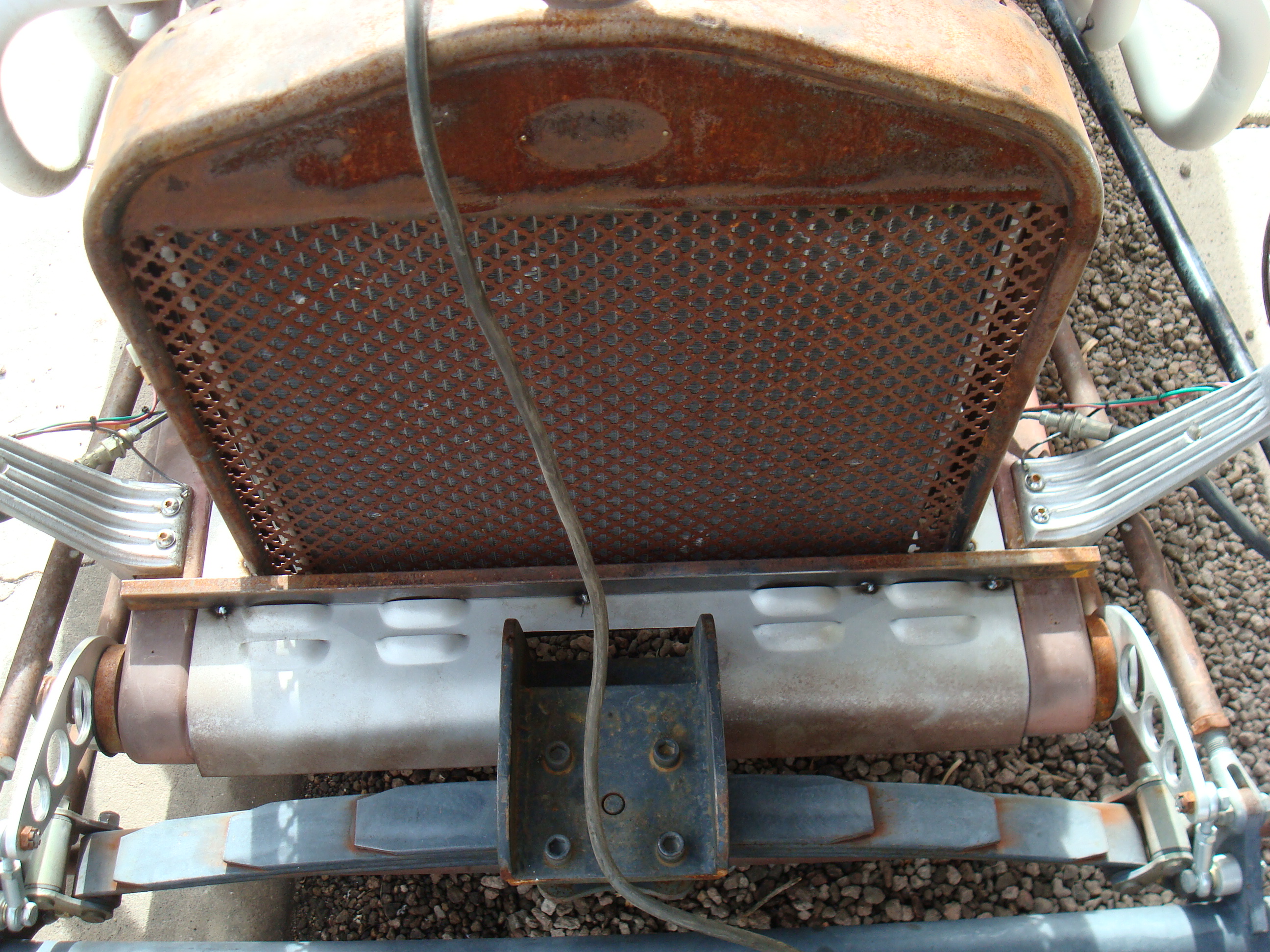

    Chip, couldn't help but notice bolt on heim joint, that holds steering arm, LET"S TALK !!

    It's a grade 8 fine thread bolt with a hardened spacer and grade 8 Nylock nut. It was trimmed from a longer bolt so that the unthreaded shank goes all the way trough the Heim, spacer and steering arm leaving just enough thread for Nylock engagement. What do you see that's wrong that I'm missing? For once I'm not being a smart ***! I'm always open to other views as far as hardware.

    Chip, im thinking the lack of a washer in case the joint pops.....or maybe something else:)

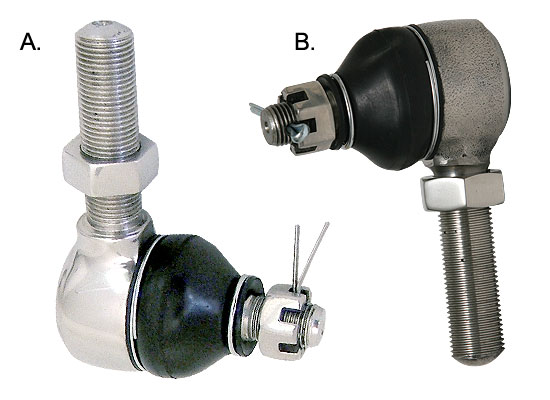

    I think I'm in the agreement with the safety washer thing. If the head of the bolt would hold the body of the rod end in place when (or if) the ball socket of the heim failed then you are probably good without the washer.
    I know plenty of rods have run heim joints on steering however I think I prefer a proper tie rod end.
    If your heim is a 5/8" thread size, So Cal sells tie rod ends in that thread to replace heim ends.
    http://www.est1946.com/tierodend-58-18thread.aspx

    Yeah, Larry, you can get those from Speedway as well. I`m more worried about Chip`s shot with the His and Hers Bathtubs in there--kind of like all those ****** TV ads....:eek::D

    I know your "open" Chip, why I felt comfy bringing it up. Lost two buddies in a 29 roadster PU when the heim ***embly came undone..https://www.pegasusautoracing.com/images/M/3068.JPG check this site and then decide..
  24. verde742
    Joined: Aug 11, 2010
    Posts: 6,588
    verde742
    When a rod end or spherical bearing is mounted in single shear and is not positively retained by the surrounding structure, most sanctioning bodies require large-diameter retainer washers to prevent loss of control in case the ball or race separates from the housing. Plain flat "fender" washers are large enough, but they restrict the motion of the bearing. The washer needs a bevel to allow full freedom of movement at the joint.
    Our Safety Retainer Washers are specially machined just for this purpose. The plated steel washers are available in SAE bore sizes of 1/4 through 5/8 inch and metric bore sizes of 8mm to 16mm.
    Why Use Safety Retaining Washers? Click the link to see how a $3 Safety Retaining Washer could prevent a catastrophe

    Thanks Verde. I get what you are after now. Yes, I normally would run a washer over these, but I felt fairly secure in not doing that as these ends on my car are top quality chrome moly stuff that have a bit wider web to protect from pull through in just such a case. The actual web is quite a bit smaller than the head of the bolt when you look at them, so I thought I was safe. I buy them through a local sprint car and Midget ch***is shop and check them frequently.
    Certainly not a bad idea to double down though on safety, and I will fit a washer over in the next few days.
    For me the Heims are an aesthetic thing more than anything else. I love regular tie rod ends on older forties and fifties builds, but by the time the sixties rolled around, EVERY race car and hot rod you see in pictures was running heims. I have used them quite a bit over the years, and I find there is a WIDE gap in qualities out there. The cheaper grades wear almost instantly, before your very eyes, the more expensive stuff lasts forever.
