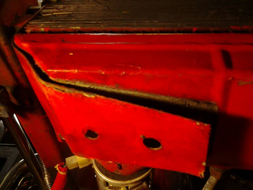

  25. This is the right side that's coming loose
  26. and this is the epoxy looking stuff that was holding it on ( it looks gray like solder in the pic, but that's just the light, it's much darker gray almost black in person, and it has little air bubbles and sharp edges on it that look a lot more like epoxy than solder).

    That looks bad. At the risk of stating the obvious, the rad will have to be removed and fixed properly.
    Of course if it was soldered it was poorly done.
    If it was epoxied then all that needs to be removed and a nice clean surface prepared to make the fix.
    My repair to that would involve removing everything and cleaning to spotless, then I would silver braze the brackets on rather than ordinary solder or anything else for that matter.
    That would be a permanent fix.
