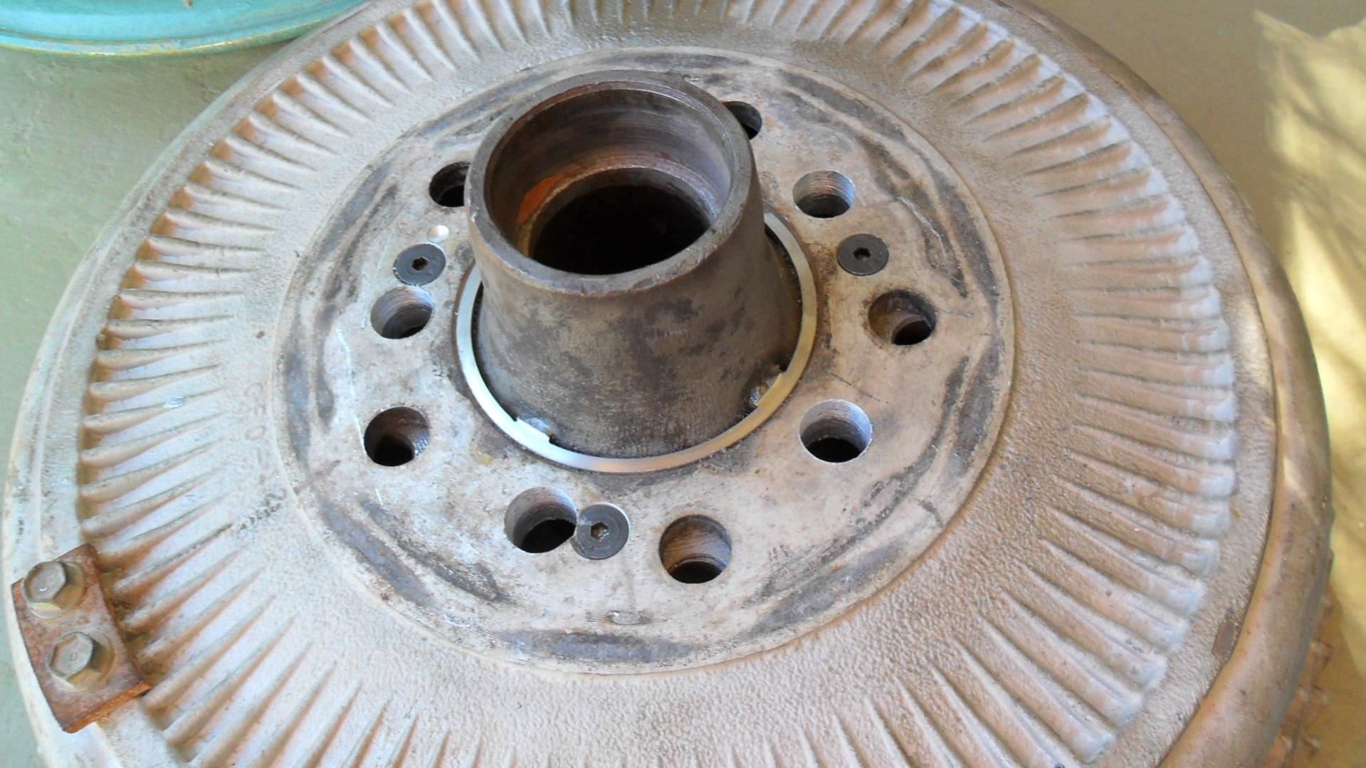

    Just picked up my Buick drums from sir John Evans here in town! He modified them to work with the F1 hubs I have and drilled a 5 on 4 1/2" bolt pattern while he was at it. I'll shoot some pictures later. Hopefully, my radiator will get here today...

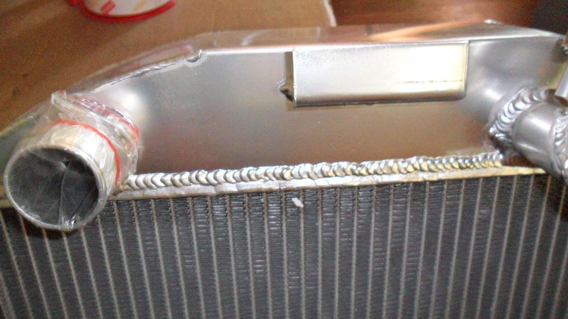

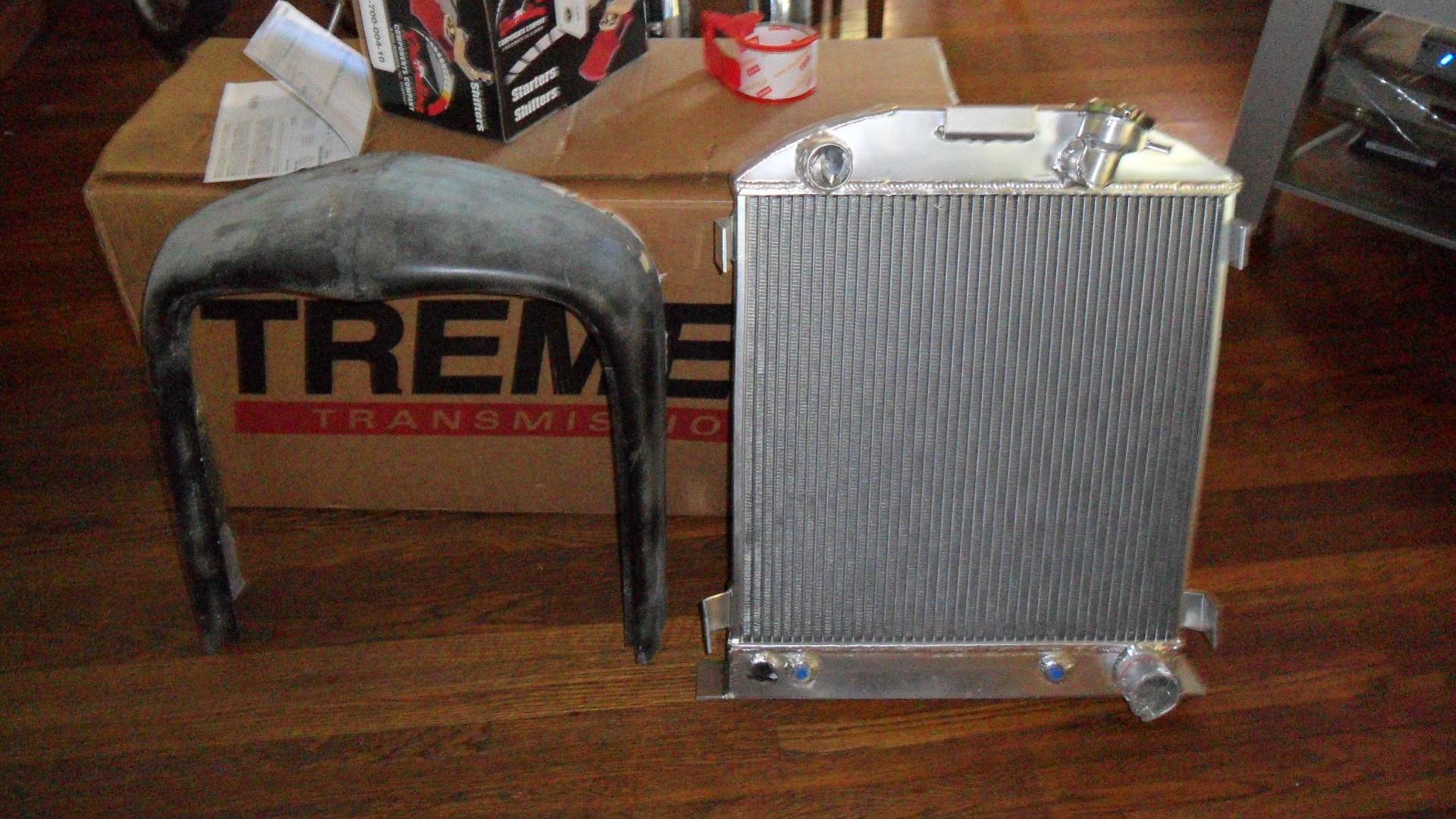

    It's almost like Christmas around here today! I was out looking at stuff on the "T" a bit ago and the big brown truck rolled to a stop with my radiator on board! While being of the finest quality that Judy's cousins can manage, it's not stellar. Not bad, not horrible, but not stellar. I picked it because it was three row,(NOT 3 CORE! I had an old guy boss at the radiator shop I worked at as a teen that would slap the back of my head until I used "ROW" instead of "CORE"!) and had a brazed core instead of epoxy set headers. The company also takes the time to actually cut round holes for the inlets and outlets instead of simple hole saws and blockages. We'll see how it works. If it doesn't fair well, I'll spend the big bucks and have something made. I fit works great, I'll laugh manically at my good fortune for a change! Far better than dodging free falling anvils, which with my luck lately, I fear is next. My dogs refused to move until the picture was finally snapped...
    The other good thing today, I got paid by one of my clients and decided to take some of my new found fortune out to "sir" John Evans and pick up my Buick brake drums set up for F-1 hubs and F-250 self energizing backing plates. Some studs, and some bearing and I'll be rocking this deal! Oh, back into the bead blaster with them before hand.

    Unless someone else has already blasted the drums in the past, a much more "Buick drum" looking finish can be done with aluminum brightener from the big truck wash.

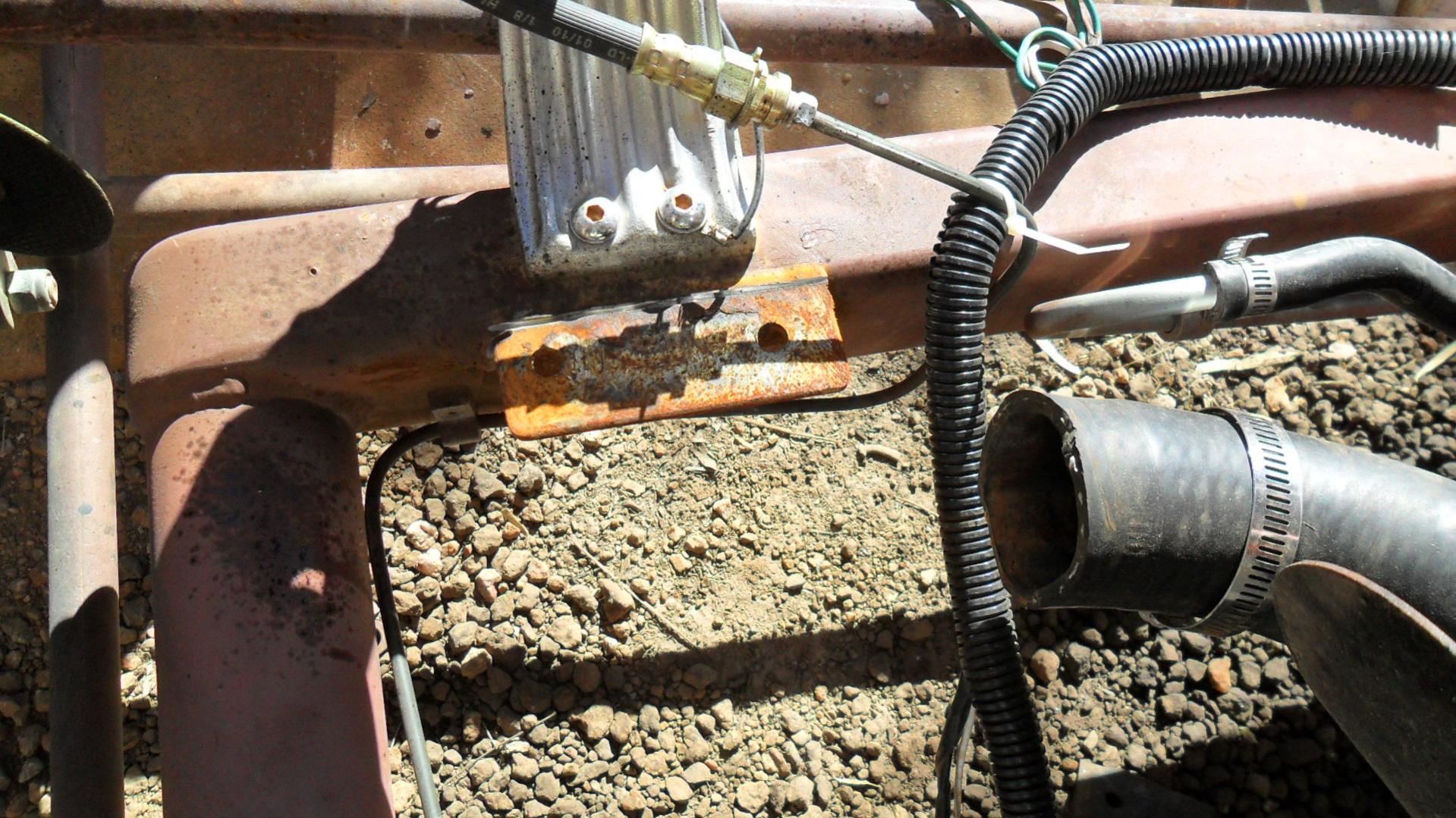

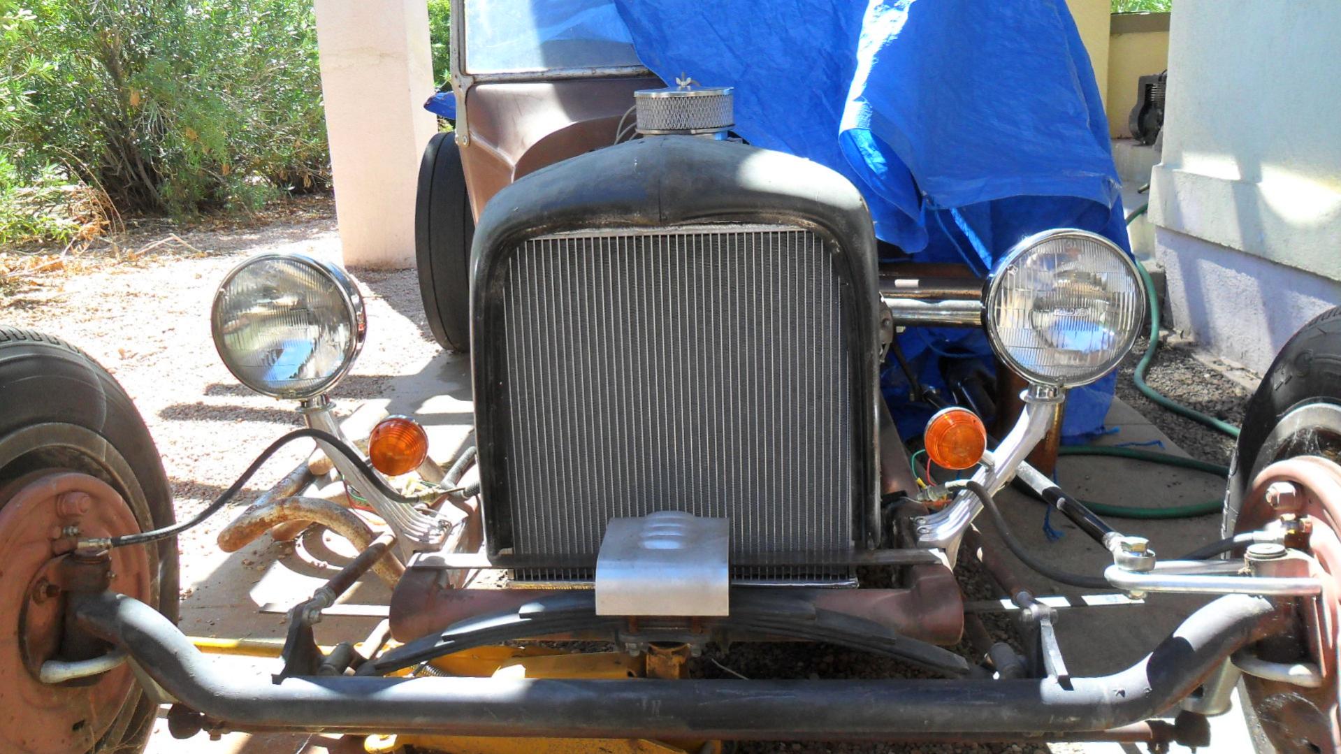

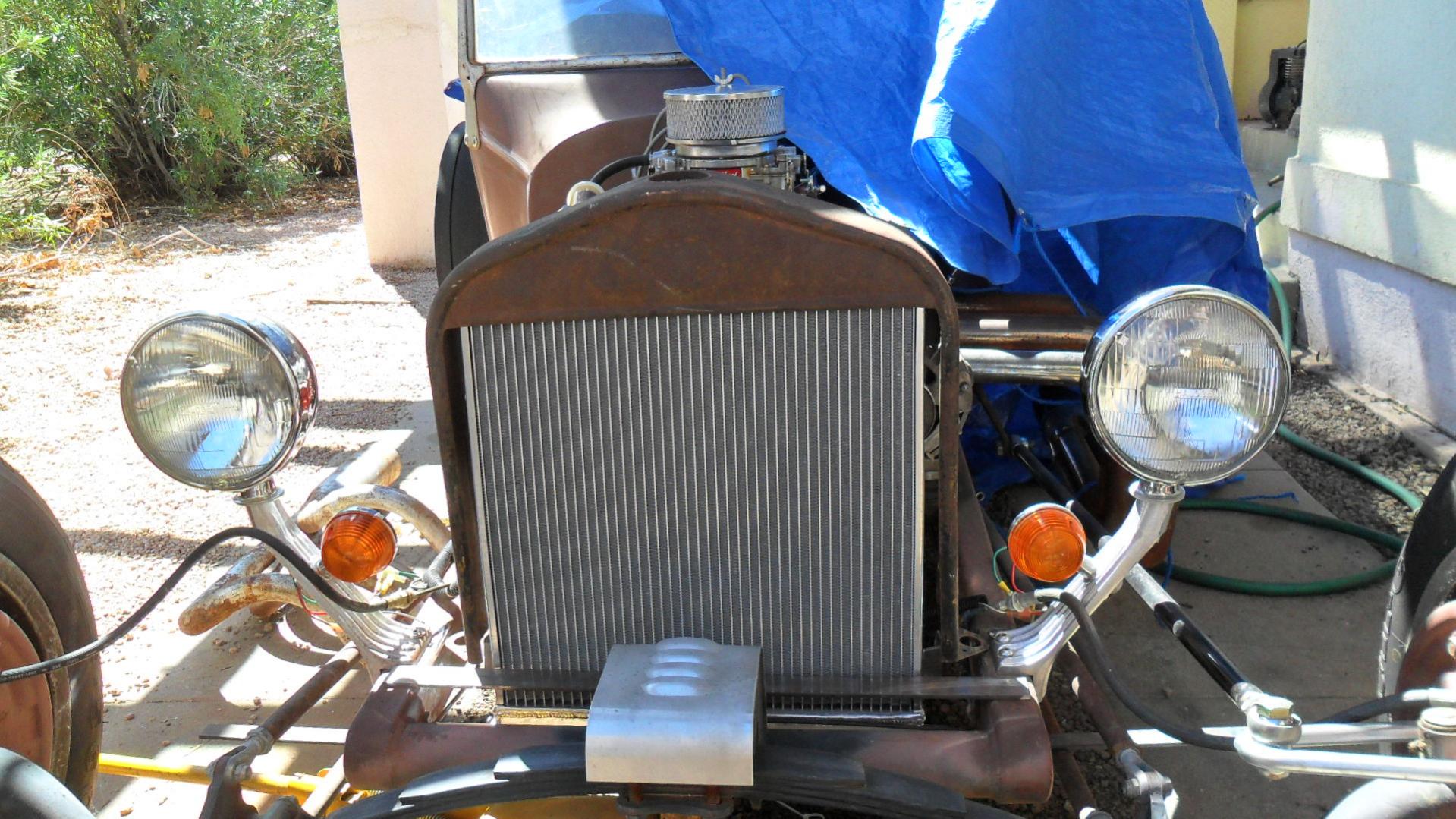

    Okay, I shot some quickies while I was arguing with the insurance company over what cons***utes "reasonable" in regards to the wagon....
    Bare in mind that I will be able to drop this whole deal down about 1/2" more than it is now. I also got out this morning and cut out the two random sized pieces of angle iron that served as radiator mounts in this cars first incantation. What say ye!

    Duece shell are definately used very often on hot rods ('cause they look good), but you don't see them used so much on T-Buckets these days.
    I say go with the Duece shell. It will stand out from the crowd, and as Ron said, it suits the vibe of the machine.
