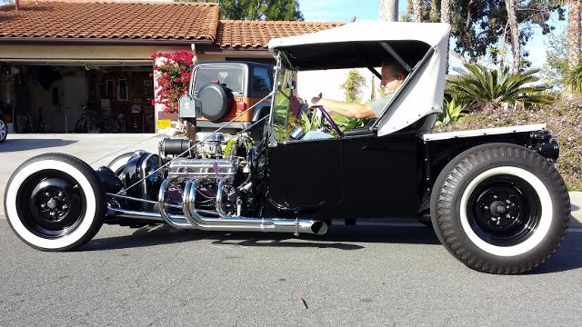

  2. GEGE
    Joined: May 18, 2002
    Posts: 212
    GEGE
    I can drive it fine.
    I made using stock t saddles and steel tubes that slide into the front stake pockets of the bed saddles and i lower it down and it stays connected where stock t hinge point is you can see and sits then in the saddles. It folds pretty thin.
    If i had a short pick up bed you would be right but it looks good sitting down and there is still more bed behind it.
    I will post picks of the saddles and bare top bow before it was covered tomorrow.With the top being white and bed cover same white i think it looks factory as they blend into each other.

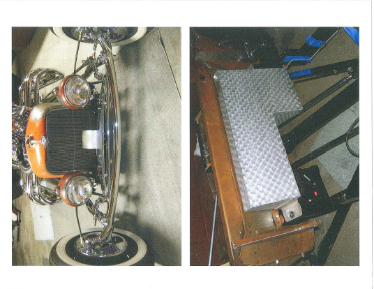

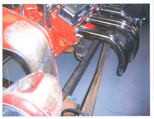

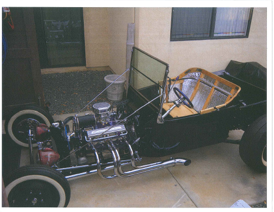

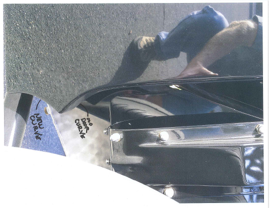

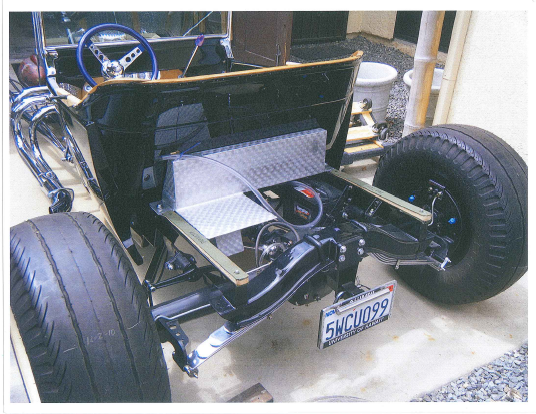

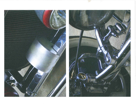

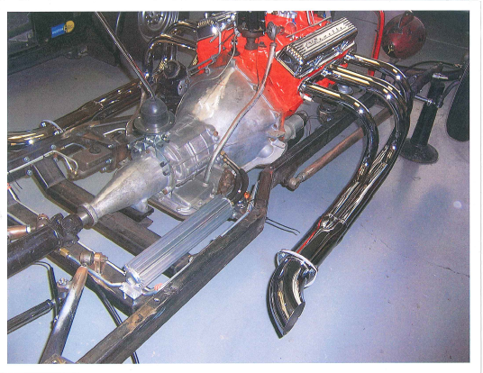

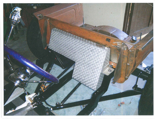

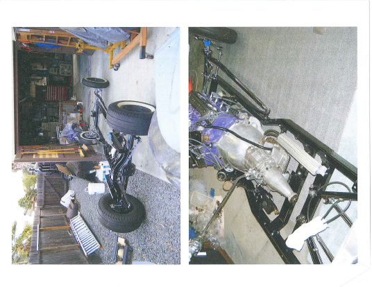

    here are more pics for those wanting to see the folding top ect.
    Also you can see the machined tubes welded into radius rods for spring hangers that allow perfect alignment of front spring to frame spring perch. just don't tighten till weight is on all parts and it seeks being level then tighten up.
    Also to gain a better look of bed to body I placed rear bed end into the 2nd set of bed pocket holes, made a round filler plate and a side plate so when you look in it all blends into black.
    And you can see I made frame to widen just inside firewall so there was more room for things.
    Also the weld on top of radius rods I did not grind off, just ground a little to a point for a fine line detail and with many dips in copper and block sanding it makes for a different look and not lose the weld strength.
