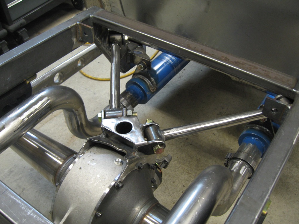

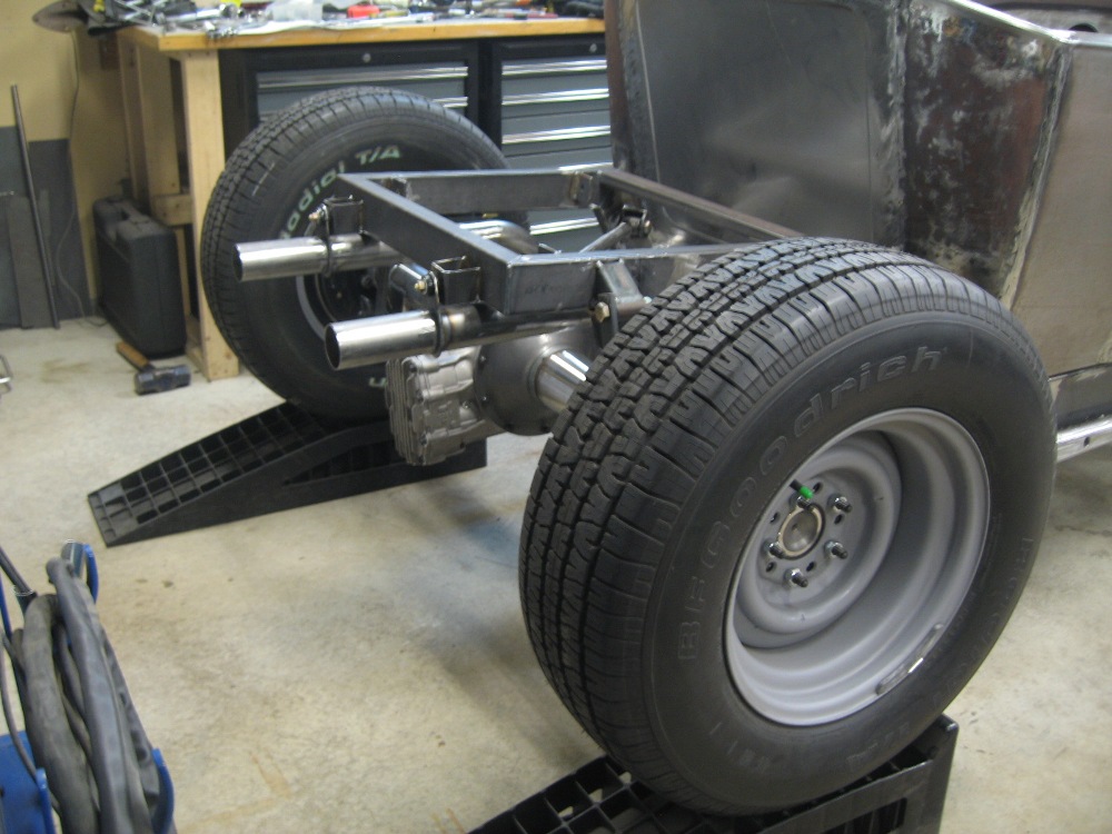

    I wrapped up the quick change install today, next comes a driveshaft. :cool: Larry

    Will the long lower arms and the short uppers combine to give pinion angle problems? I ask because I'm considering changing mine to 4 link as well so I can drop her a little more, and the arms will be about the same lengths.
    It could be a potential issue...but with the limited travel we have??? I haven't plotted it out yet and seeing you already went this route I figured I'd ask. :D

    This is a question that has been dogging me for quite some time. The more owner-designed unequal 4-bar suspensions I see here on the H.A.M.B. the more I wonder how well they actually work when the car is driven on anything other than straight and level. I have owned and driven a car with a poorly designed and executed unequal 4-bar setup and it was, on it's best day, spooky to say the least.
    The problem with my car was that as it leaned over in a turn the rear suspension would cause the turn radius to tighten without additional steering input. The rear axle was being pulled and pushed forward and back on one side or the other as the suspension went through its travel giving the car a progressive rear-steer condition. Spooky.

    Not always easy to visualize the effect on the uppers, that form the triangle. I guess that I'd aim for least wheelbase change due to a body roll. Bar length (and difference in lengths) likely a strong contributor as well. You're spot-on, describing a rear wheel steering 'effect'.

    Good questions and good points, all of which I have thought of during the drawn out time figuring this all out.
    If any of you have followed my build thread at all you will know that this is rear suspension design 3.0 :)
    I made sure that the lower and upper arms are parallel to each other and are at the same plane with each other as they move.
    And yes, because of the physical limitations of the frame kick up the top arms had to be short.
    I worked the suspension up and down, side to side and found that even in the extreme ( bump stops removed and full axle travel up to the frame and down towards the ground - 6" up and 6" down from neutral ride height)
    that the changes are very minimal.
    Side to side articulation is nice and smooth.
    A very small amount of movement that could potentially cause rear steer and less than 3\8" of slide in and out of the pinion yoke at the driveshaft.
    Pinion angle stays close to the 3 degrees that I have built in at ride height through the full range of extreme movement, and it stays bang on in the normal range of limited suspension travel.
    In the limited range of normal suspension travel ( physically limited to 3" by the travel of the coil overs and bump stops)
    There should be no noticeable rear steer or anything like that.
    I think that this little car will handle quite nicely with what I have built. :cool:
    Larry.
