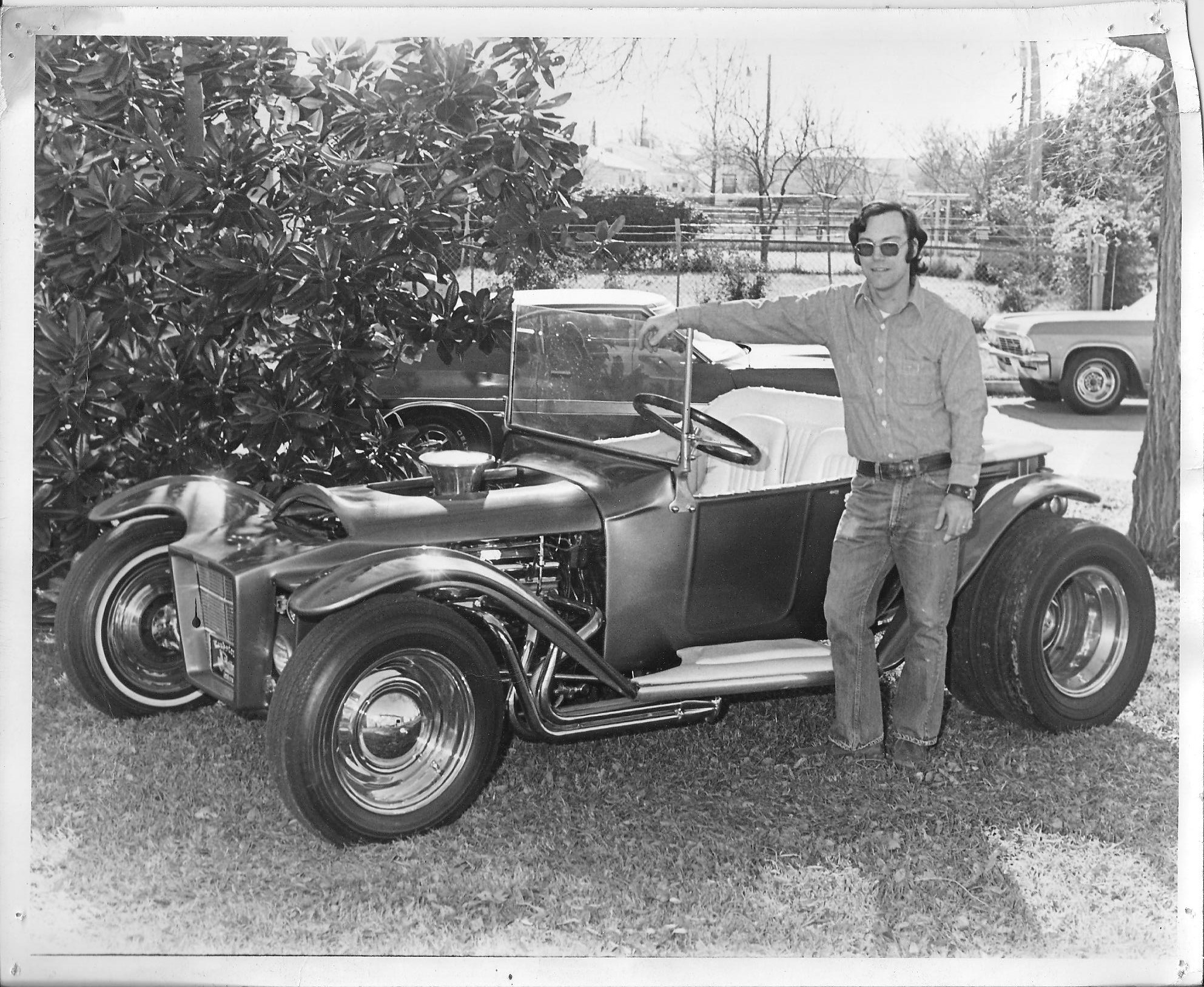

    Ted\'s roadster 1.jpeg Hey rebel how about this for a different post. This was my first roadster, T-Bucket, or what ever you want to call it. I like bucket of ugly. It was an old show car I bought for a song in 1973, Boy I wish I had all that hair back. Anyway it had no wiring, no front brakes 265 eng was worn out and smoked bad.
    Also it had duel cheater slicks on each rear wheel. Wish bones on rear were about 6in long no travel. Took me about a year to rebuild it so it would work but I had fun with it even it was ugly.(I won a lot of trophies with it) Ted\'s roadster 1.jpeg
    volvobrynk, loudbang and k1w1rodder like this.

  28. A fine looking T Mr Mac and you do yourself an injustice by saying it was ugly as it was really upto date back then I would of thought. Different would of been kinder but I like the individuality of it and certainly like the use of the bucket seats, from a Mustang ?

  30. volvobrynk
    Joined: Jan 30, 2011
    Posts: 3,587
    volvobrynk
    from Denmark
    Me Mack
    You don't get more more spot on era wise then that! Front and grill ain't my thing. But there is a lot going for it too.
    Where are the rest of the pictures?
