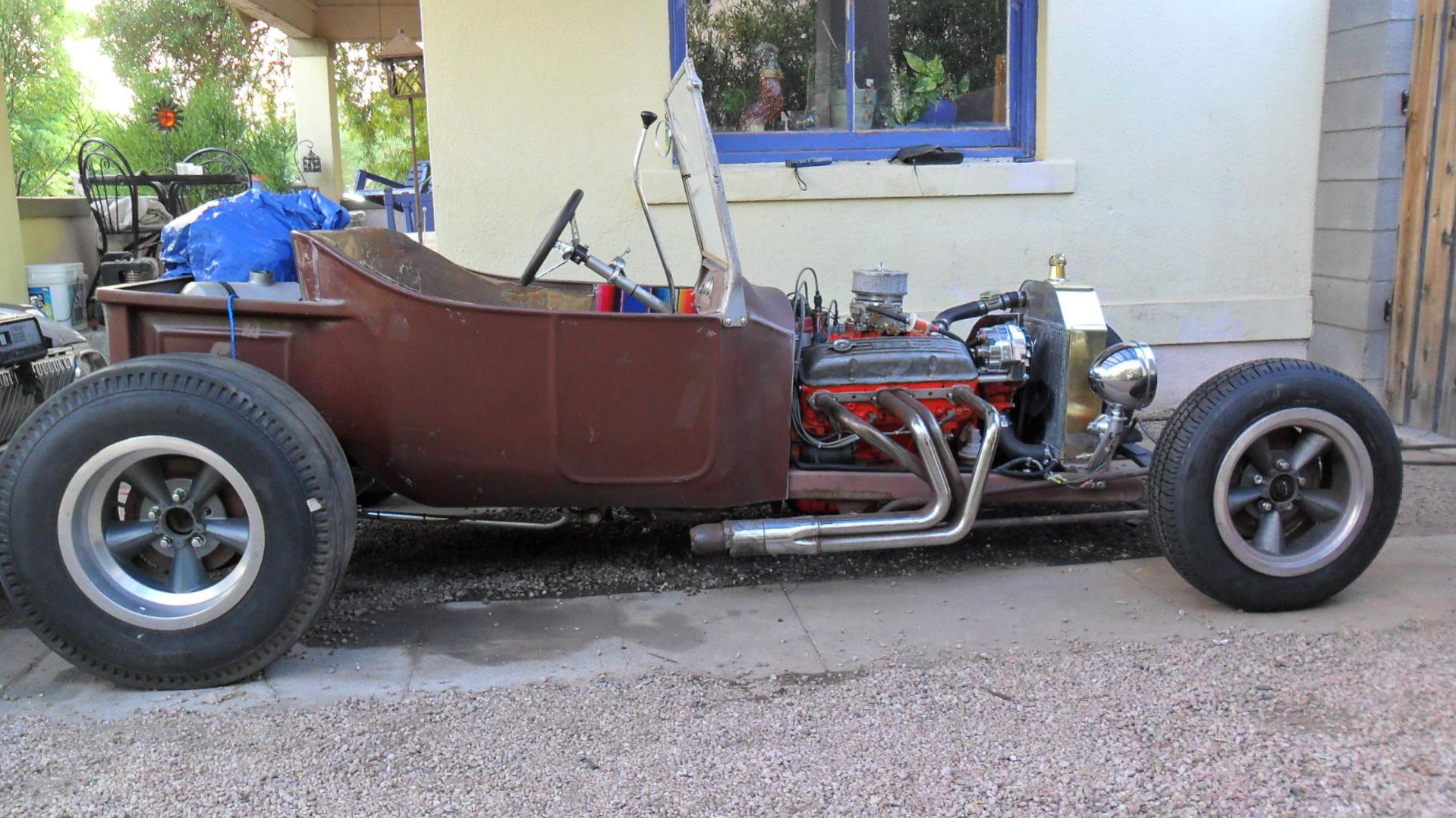

  2. Does that NEED what looks to be about 10* of caster?

    You just hit on something I always preach on these cars, and actually the reason I got the opportunity to do this one. See, the real reason this car was thrown under a tarp in the back yard was neither Roy or Kurt could drive it! When I set up the steering, I always insist on an angled column. I do use quite few reversed Corvair boxes on these cars because they make that column angle easy. Roy had wanted a vertical column, but getting in and out of a car this small with that is damn near impossible. It also sucks to drive with your hands in your lap and using your shoulders to turn.

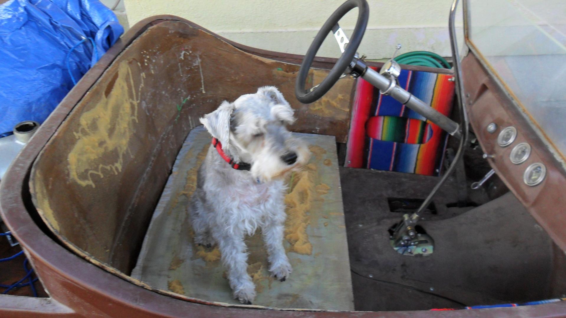

    The biggie with this car though was how the two of them set up the seat. See, when I did the steering column, the body wasn't wooded yet, so we mocked up a seating position and spent a whole day with the three of us getting in and out of the car to make sure there was enough room for everybody to drive. When Kurt started building the seat, he and Roy came over to my place to ask my opinion of how to do it. I said "the seat riser should only be a couple of inches tall at the maximum, and taper back to the floor at the back to give some lumbar support". Roy has an old set of CCR build plans, and it's instructions show a seat riser that is about 6" tall and straight all the way back... Full on, goofy, seventies, "look at me", fad "T" stuff! Guess which one they followed? Yup! with that tall riser, neither could fit or comfortably drive this car. Then they found an old couch cushion, and cut it apart for 6" padding... it got worse! This is how I got to buy the car for a song.
    The ugly assed serape interior I already a memory, and I will soon be doing a write up about cutting the tall riser down to a more human level and angling it so it will be more comfortable. Then it's on to a barrowed "mini walker" sewing machine, and a few yards of white marine vinyl... You really can ride comfortably in a T-bucket if your of average size, it just takes some thought before hand.
    Oh, one last thing. You might notice the lack of a steering wheel in the pictures. A quick release wheel is a T-bucketer's best friend!!! Damn good anti theft device too. Plus, walking into a nice restaurant dressed well and asking for a table for two with a steering wheel in your hand is an experience you soon will never forget....

    See, Phillips gets it! If you look real closely at early sixties stuff, especially Gassers and Altereds, you will see that quite a few ran the first real production radial out there as a front runner, the Pirelli Centurion. I always shoot as close to that look as I can when choosing a radial tire on an open wheels car. These are Firestone F560 155s, and other than a small amount of schmuda on the side walls, they look pretty right. I might try the side wall sanding trick I have heard of to alleviate that a bit.
    Alex, I know you get it!!! But you did raise a huge point that many miss, so I'll highlight it here - ROLL THAT PUPPY OUT OF THE SHOP AND LOOK AT IT EVERY NOW AND THEN!!! Massively important!
    On the other hand, if this does get painted, Bright competition Orange is the dealio!
    Me too man! My parents drove his and hers T-Buckets when I was kid back up in Minnesota, and my dad dragged home an unbuilt "Big T" kit when I was about 6 or so. Even then I wondered why it looked so different than our T-buckets, and I have been obsessed with the '60-'65 'bucket era ever since.
    I haven't checked the caster yet, but it wouldn't surprise me if it was that far laid back. I usually set things up for about 7 degrees.

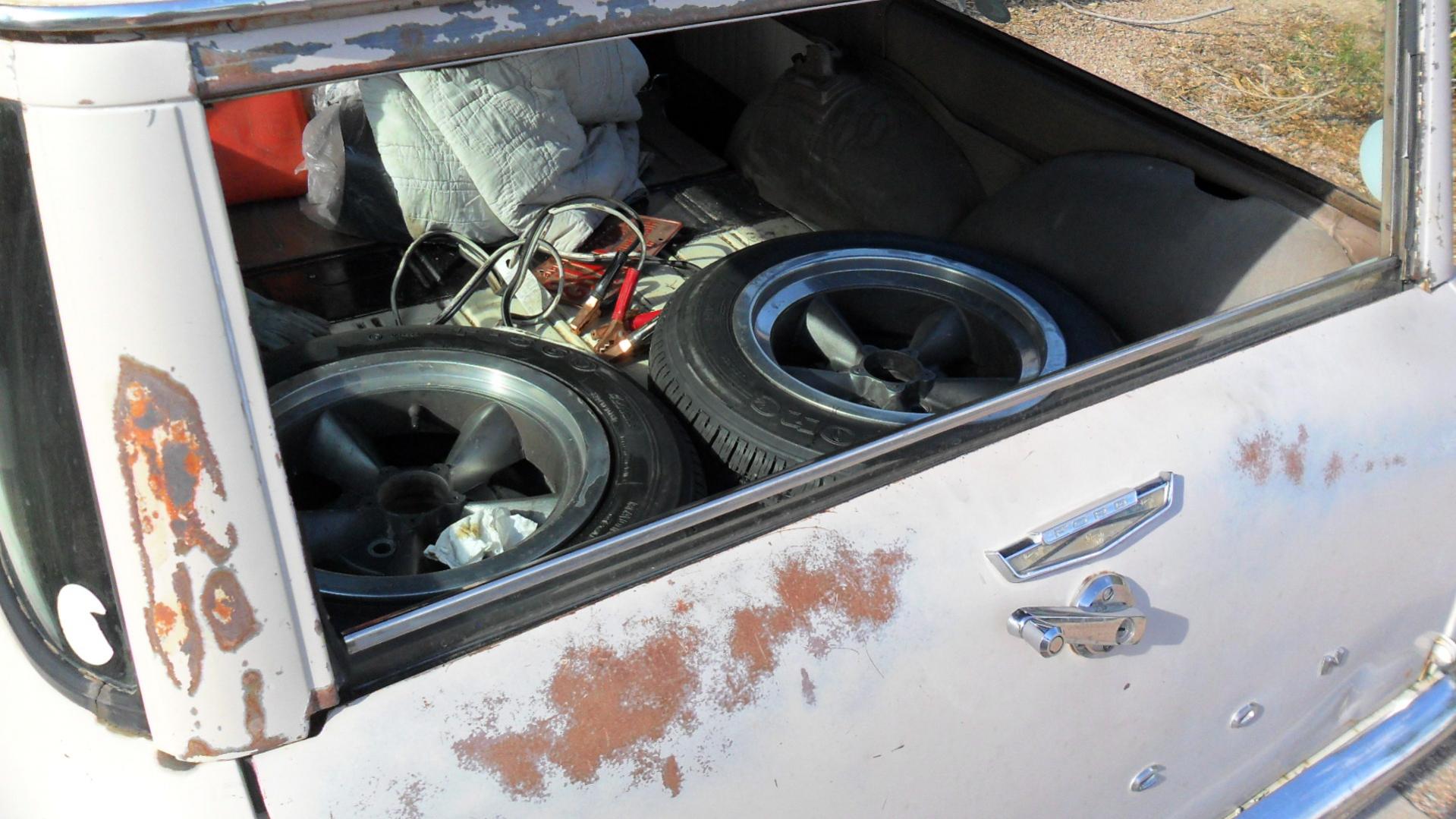

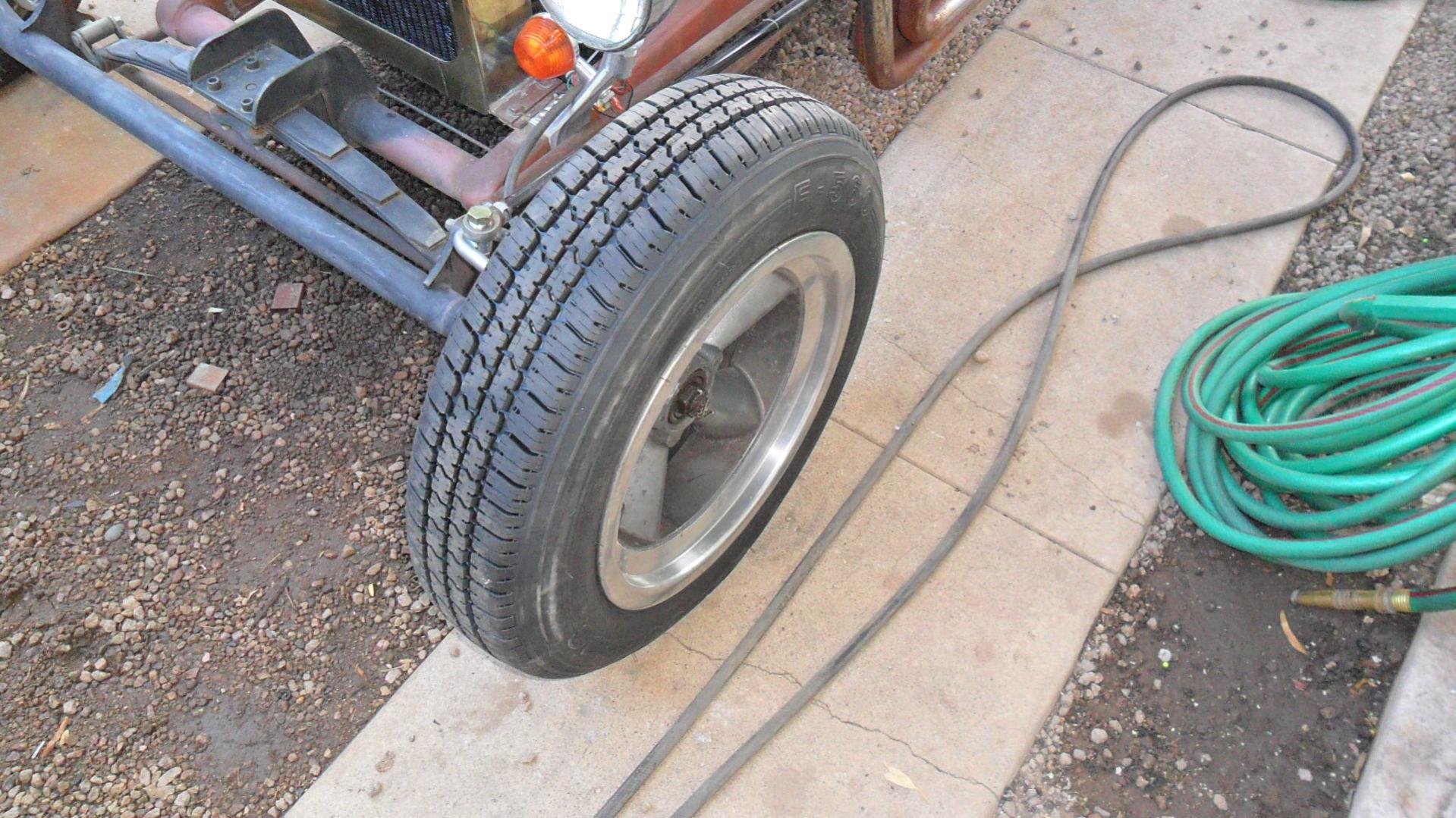

    Okay, so first is the scene this morning in the back of the wagooon... Got my fronts mounted!! TIREWORKS at Central and Pima south of down town Phoenix absolutely rocks!!! I'm serious, if you need tires mounted on something you care about, give these guys a call at 602 252 5732. End of commercial, but they are worth it!!!
    I had a couple of things go a bit awry this morning as I was doing my runnin' around for the week. The Falcon wagon decided it no longer liked it's alternator, so it stranded me at McDonald's about a mile from home. Nothing worse than being "that guy" wandering around a 120 degree parking lot asking for a jump start! It'll be back up and happy in the morning. The next obstacle thrown my way was a complete lack of 1/2" 20 mag type lug nuts. No biggie right? Hit ANY tire store and they have bins of them... RIGHT! Nope, not to be. As a matter of fact, most conversations I had where I asked for "1/2" shallow reach mag type lug nuts and washers" were greeted with one of two answers - 1. What kind of car? (Really doesn't matter), or 2. (and far more prevalent in my part of town) QUE? A quick call to my buddy and neighbor Dave Sexton at So-Cal Phoenix hooked me up with a wholesaler of lug nuts and wheel accessories that will be pulling up to my shire in the A.M. In the mean time, I cobbled as many odd, beat up, old lug nuts as I could to get things somewhat together. Tomorrow after the lug nut guy rolls out. I'll fire it up and park it across the street and take those pictures Flat-and-Low was talking about! For now, here it is!

    I saw the pic of your dog on the seat riser and MY ass started hurting!:D I've seen T Buckets where the top of the seat was only a few inches from the top edge of the body! WTF!
    I made my riser about 5" tall, THEN, I opened it up on the passenger and driver side. I installed webbing and a thin cushion that dip a couple inches into the riser, giving me a final seat height of about 3 1/2" to 4". Like you said, the seat is what kills these things for driving any distance. I'm 6'3" and have driven mine all day without getting out. That's usually 3-4 hours and about 70 miles of driving around Houston and the surrounding area.

    I also know you'll love going with a dropped "I" beam. After my wreck, it was the first thing on my rebuild list. It took a little planning to make it work, but it stands out compared to the typical dropped tube axle.

    Thanks for the comments on my seat riser. That is the starting point, and it will get cut down substantially as this build progresses. I then am planning on doing Exactly what you talked about with the webbing to give some bounce with minimal padding to increase height.
