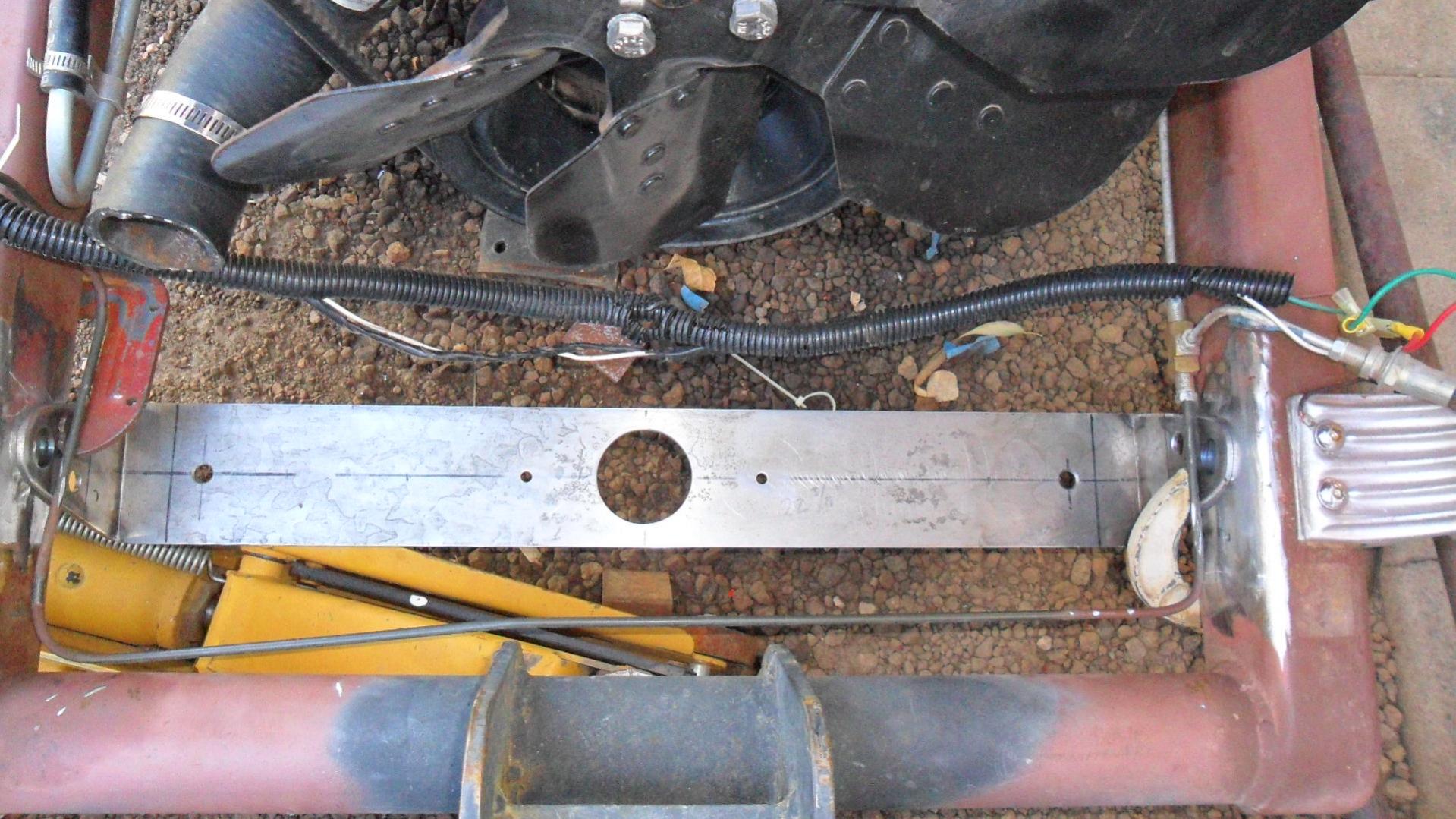

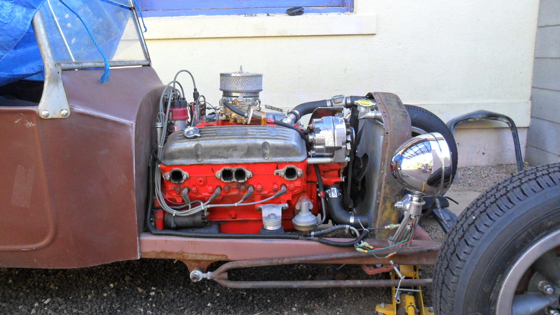

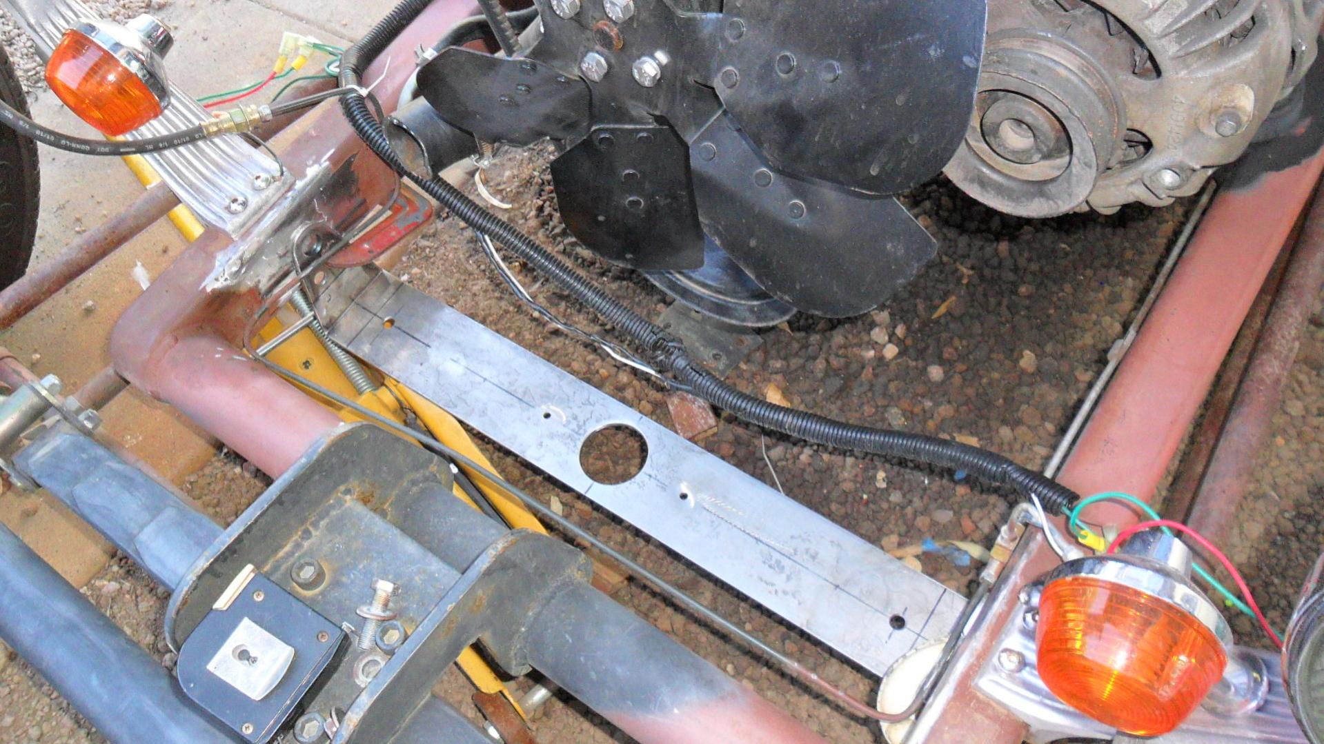

    Well gang, got a bit done today! I needed to get the radiator mounted for this beast, and then this week I need to get some papers on it so I can legally drive it for a bit.
    I decided to mount the radiator a bit differently than most would in a typical T-Bucket application. What I ended up doing was to make a cross member that stretched from frame rail to frame rail rather than just a small pair of tabs as more commonly done. The reasoning behind this is that I have purchased an aluminum radiator for this car, and my experiences in the past have led me to a bit o caution. See, I have noticed if you run an aluminum unit on a flat cross member like a Model "A" or '32, it has a much longer service life than if simply hung off of tabs and unsupported in the middle.

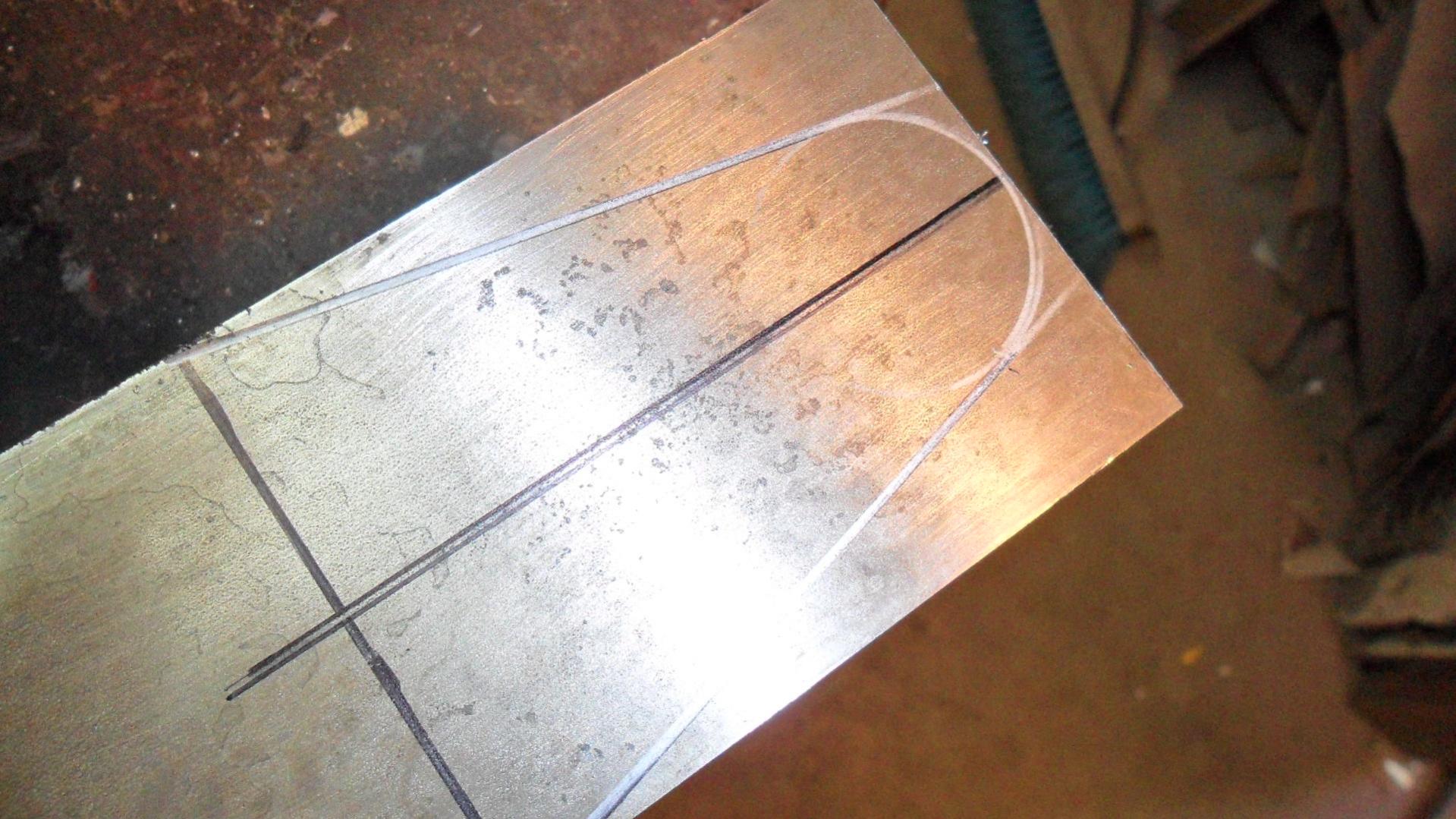

    Basically, I took a piece of 3/16" cold rolled stock 3" wide, trimmed the ends in a pleasing, rounded shape, drilled for the radiator, drilled so I could completely plug weld it to the frame, and took it over to my buddy ElPolacko's shop for a date with his press brake. I made two 90 degree bends so that it would tuck up into the frame, and it did quite nicely. I neglected to take a picture of the completed cross member before I clamped it in place, but I have to pull it out tomorrow and clean up the rails before welding, so I will try to remember to take one then. In the A.M. I'll fire up the welder and zap it in place and get this thing back together.

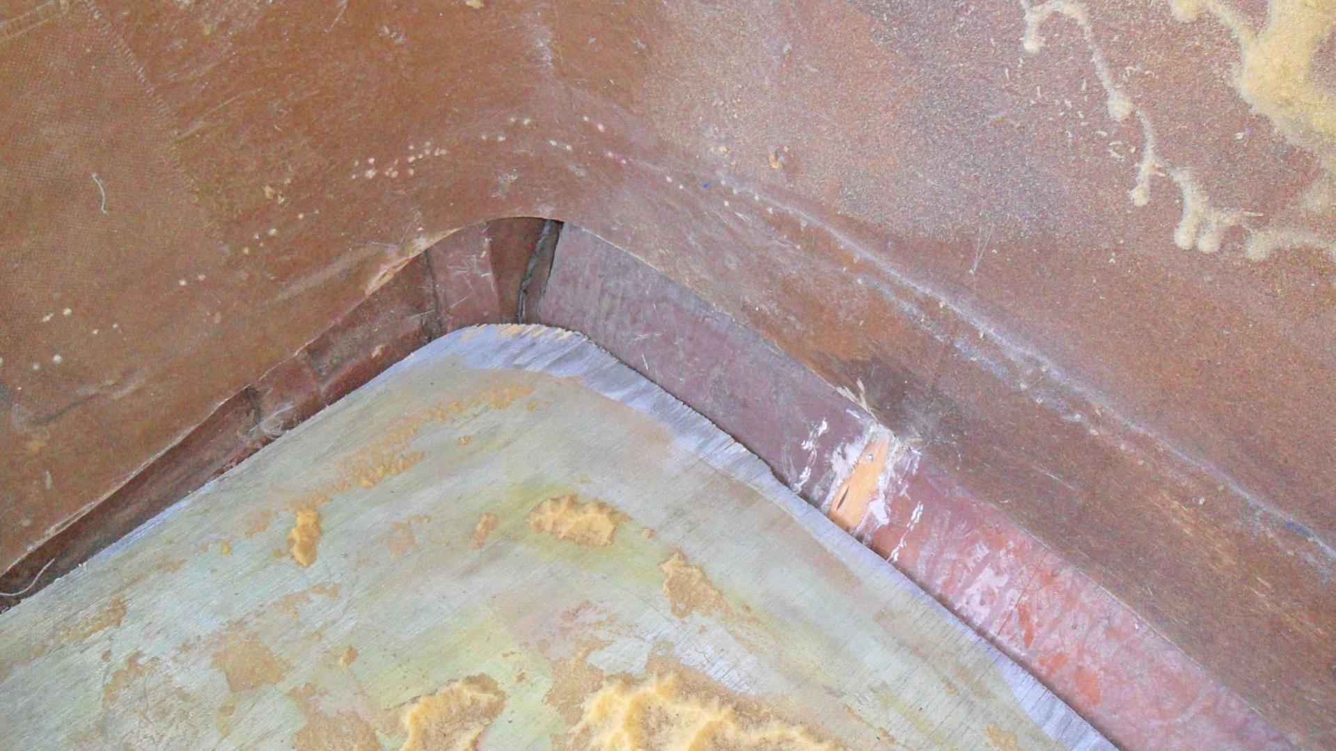

    I got another surprise today. I told you my gl*** half a deuce shell was rough, right? I hadn't told you guys HOW rough. when I started sanding and cleaning it up, I uncovered a seam running straight down the middle of the shell through the nose. A call to the buddy it came from got me the number of the friend he got it from, and I found out this... He narrowed it 1"! ****! That explains why it won't fit down nice and snuggly over the radiator and sticks up so damn high. It also explains the m*** build up of fibergl*** on the inside of the nose, too. Bummer!!! Bummer BIG TIME! So it looks like for at least the near future it will get it's "T" shell and patterned insert. I'll keep my eyes open for a deuce shell or get little less busy and fix this one later on down the line. BOOOOOO!!!

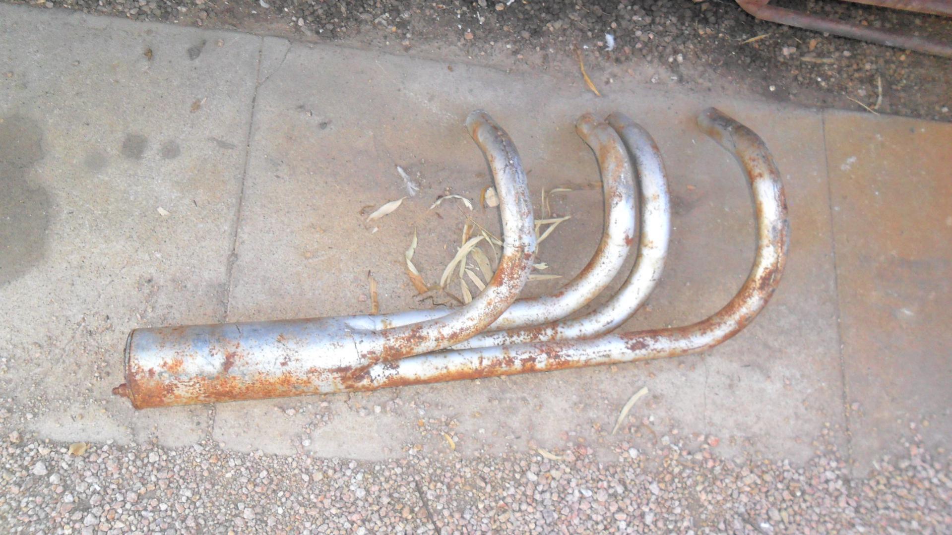

    The other cool thing that happened earlier in the week was a quick trip over to Roy's to look at an issue with another car netted a cool discovery - a set of exhaust pipes that have some genuine local history on a car from the sixties. From what I am understanding, they were originally built for the car that local H.A.M.B.er and sometimes chimer inner to this thread, John Evans built into a nice traditional roadster a few years ago. This car was a fenderless '27 drag roadster that had the driver moved back into the trunk, and was powered by a pretty fearsome Chevy in '62 or '63 or so. They later ended up on another's street roadster and that is were the perforated "baffled" ends came into play. From what I've been told they were p***ed from guy to guy for the last 40 years or so, 'till Roy decided he needed a head flange. I can set that right though. They are a little coby, but I think they will be a neat addition to this car, sandblasted clean, fixed and painted white.

    I really like the sweep of the primaries. Those have a nice look! I'm sort of the same as you Chip, I'm 53, but was reading Car Life and Spotlight books before I was five, and bought my first Hot Rod magazine in '67. I started going to the local road-racing circuit with my dad when I was two, and when my mom went to the hospital to have me, it was on the back of my dads race-prepped Norton international. My grade 4 teacher told my mom that she thought I had some sort of mental problem, because every time a loud car rumbled by (which was every 5 minutes at that time in that neighbourhood) I sprang up in my seat and looked out the window, and while other kids were playing dodgeball, I spent most of my elementry school lunch hours either hanging around Orvilles Garage, which was a gas station/hot rodders hangout beside my school, or across the street at the Hadden bros house, watching Wilf work on his Falcon.

    Those headers are BAD ***!!!!!!!!!!

    Cool, glad you guys dig 'em! I'll run over to Roy tomorrow and grab the left one, too.

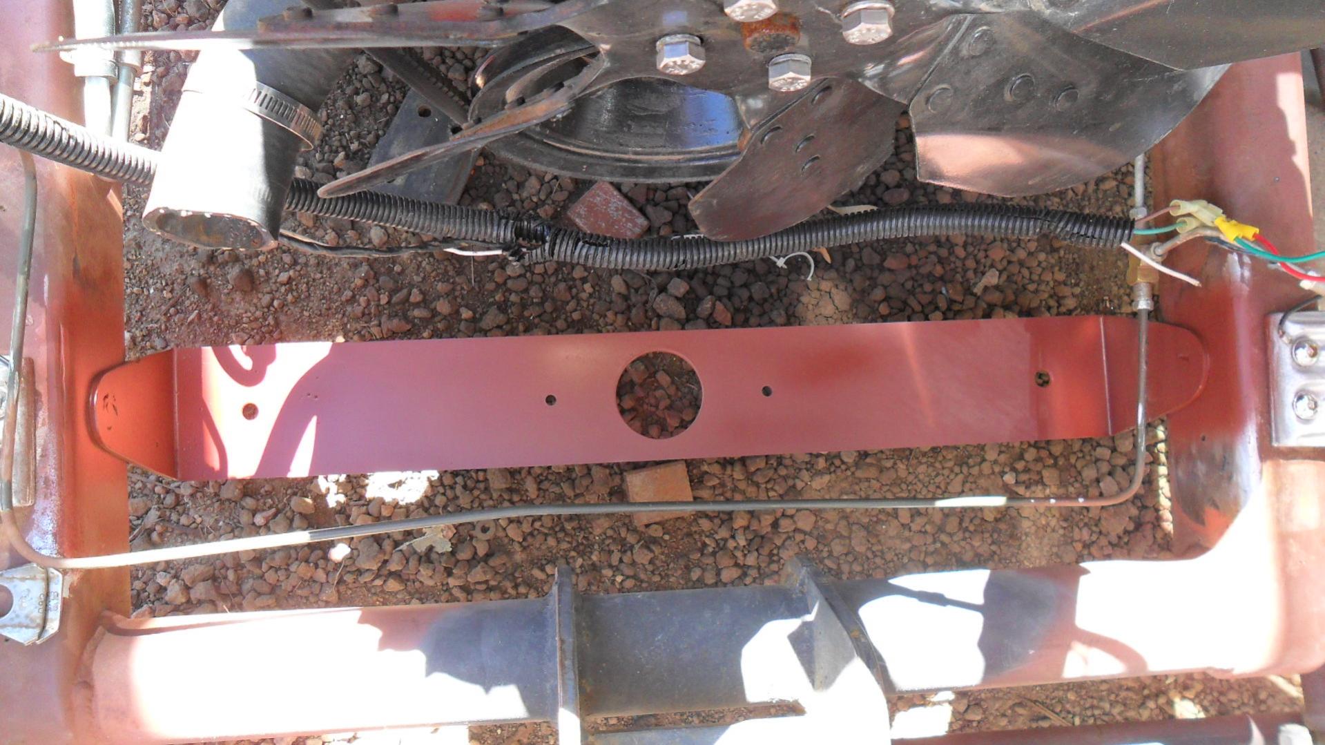

    Got lot's-O'-stuff accomplished today! The radiator cross member is in, primed, the radiator is bolted in place, and tomorrow will bring the search for hoses top and bottom. I'll have to trim the fan a bit to make it all work since everything came down about 2" or so, but it's all good.
