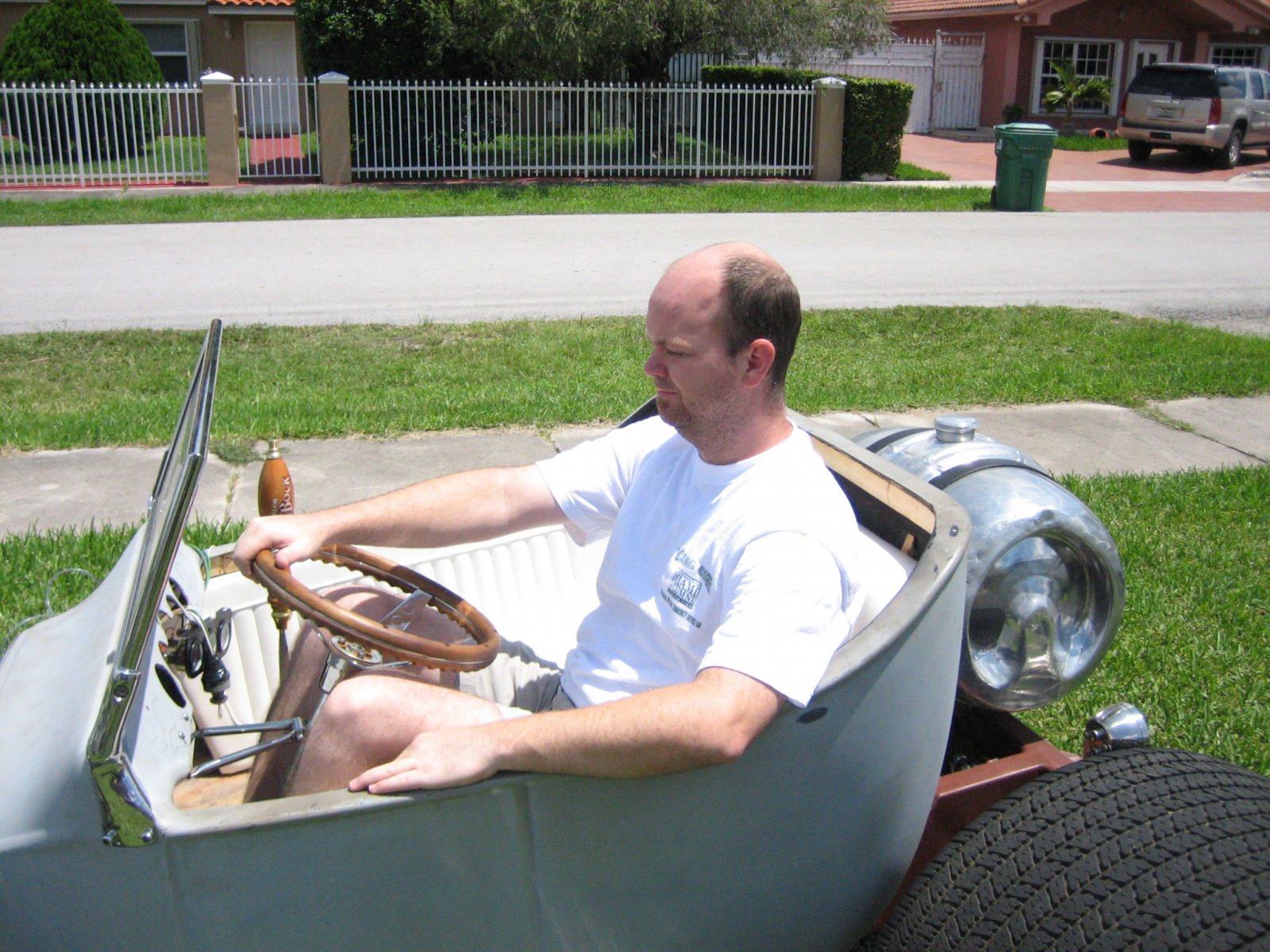

    The Poliform stock size 1927 roadster is roomyer then 23 t by a fair amount,but if still more room is needed in a T,I have for sale behind my garage a Poli. 27 roadster body only that has added 2in. deeper n 3in. wider by someone=lined up nicely but not painted,plus has opening trunk with rain gutters Op. all around inside,asking $600 frim btm line/come get it{cost someone $1400 that never finished body.
    Fitting in a stock size 23 if your 6ft. like me ,can be done but takes carefull planning of all adjustible factors,floor high,seat,steering,pedals so you can still sit in an not one body.http://www.jalopyjournal.com/forum/attachments/img_0756-jpg.1565904/
    The point of this photo of my son's stock size 23 we built,is how deep into body the seat is n how steering wheel n pedals are set up,body at front is chaneled fully over frame,but at back{raked] not coving any of frame=so floor is at btm of body at rear giving good deep seat plus the nice rake

    lance\'s23T.jpg IMG_9984.JPG Stock size 23 T-roadster ,This photo is of my son[5'11"] doing our many test fittings years ago,with what I {6'] thought was too thick, a bottom seat pad of 5in rear to 8in. front,back pad being 4in.thick of softer foam n there angles are very much part of how feel n fit are combind with look,he like more pad vs I was comephy with 2in. less that also so sat lower,he won,its his hotrod.

    Nice looking bucket Dana. I really like how the steering column angle follows the windshield angle and those two angles follow the curve of the back of the body.
    Perfect.
    Not sure if you said but you could take a couple of inches out of the backrest. I find myself leaning forward in mine anyway.
    I actually thought of putting a beer keg on mine early. I even had one in about the same shape.
