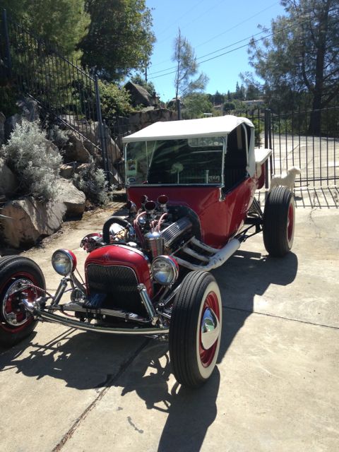

    Yes the weather here is as good as it looks. Took the roadster to the store and a couple of yard sales this morning. Talked to an old guy at one sale. (I say old he said he is 74 I'm 71 now) He said he built a bunch of buckets in the '50. said the cops were always giving him tickets for no fenders back then. The old California 1,500 lb rule.
    Jalopy When I went down to the local steel sale yard when I decided to build my frame. I knew I wanted 2X3 tubing. The guy there said this is what all the guys use to build frames. I really don't know what gauge steel it is. Don't think I have any s****s left to measure. I'll look.

    steel rebel
    Yeah Nitro that's why you are looking at another photo of my car. It's your fault.

  24. Good to see another photo of your Roadster Gary but, may I ask, with all that blue sky, why is the roof on ?:confused:. The other off topic question that I wish to ask is....wait for it.... do you have a pet lamb in your garden or is that one of those Poodle cross dogs with the fine wool coats ??o_O
  25. steel rebel
    Joined: Jun 14, 2006
    Posts: 3,604
    steel rebel
    You know whip I've been asking myself the same question about the top. I'm so ****in old I can hardly get in or out of it with the top on. It just looks so kool I thought I'd try it again. Think I might just take it off again and store it back in the rafters.
    No not a lamb that's Trixie Bell the Poodle dog. We rescued her maybe ten years ago. Not a very manly dog but she is a love and has me wrapped around her little paw.
