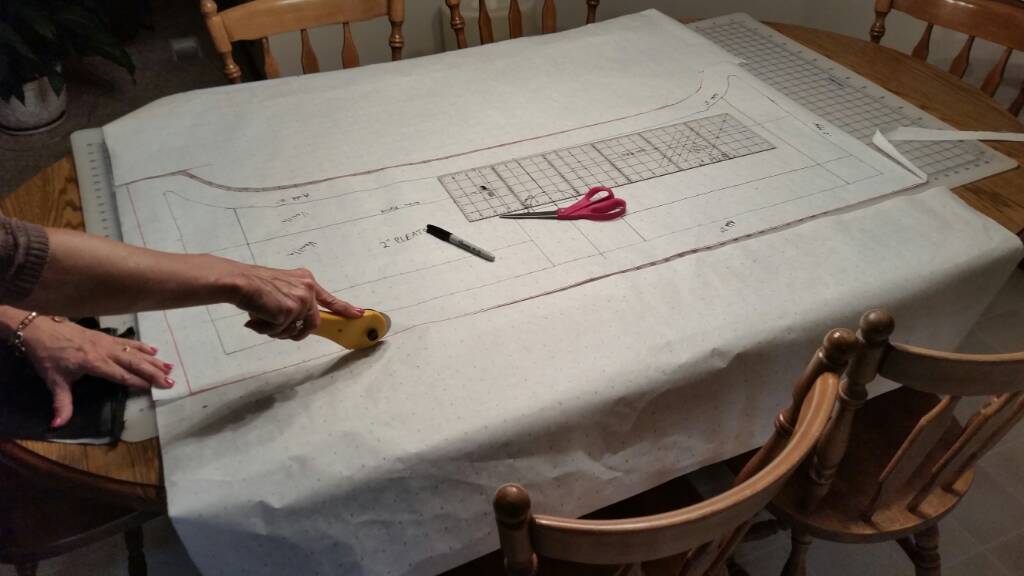

    Using Chip's advice and cutting out the tonneau cover:

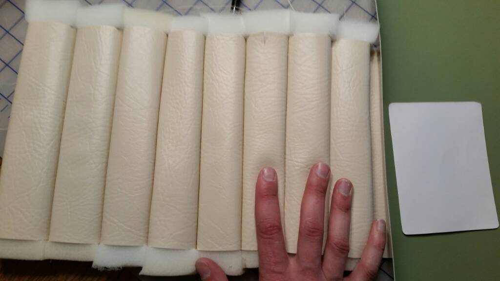

    This will be one of of the pleated inserts in the tonneau. It will be surrounded by that green piping eventually.

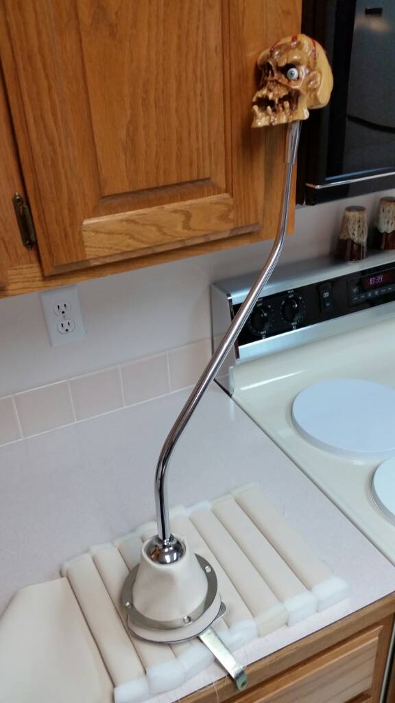

    The shifter boot came out great!

    Damn Tim! Way to goon the family labor situation!!! Good to see mom sewing on a good quality machine too! That Viking is one of the one's I had my hands in the design of when I was a semi-big wig with them. It looks like a computerized 400 or 600 series, which is an AWESOME machine for doing this stuff as you obviously now see!
    Cool thing about Viking's computer machines for doing trim type stuff, Is while most folks would look at the plastic paneled exterior and computerization and think "light duty", VERY much the opposite is true. The machine is built over an aluminum ch***is, which is one of the prettiest castings I have ever seen. Instead of a gear train and timed points to break or slip, all of the functions are run by separate motors, and if one gets "offended", it simply shuts down before it breaks. Turn it off, let it sit 30 seconds, turn it back on and it retimes itself and back to work you go!
    Oh well, that's enough machine rambling for now. Your net results look great! Just tell mom to use every bit of that 6mm s***ch length when she does the pleats and piping... 'Cause that was one of my contributions to that line FOR that reason!
