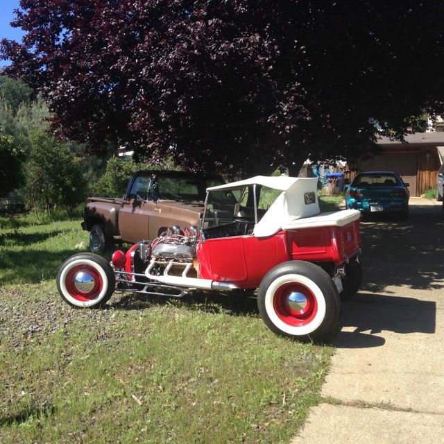

    OT Got it home. Put a good battery in and it started right up and ran great. Think all that might be wrong with the ******. is linkage adjustment. Three in the tree.
    Gary

    Thanks guys I'm getting attached to this little truck. Might be my next daily driver.
    Gary

  27. steel rebel
    Joined: Jun 14, 2006
    Posts: 3,604
    steel rebel
    No **** you are right nothing will replace my roadster although you might see it being towed behind the DoDo brown Stepside.
