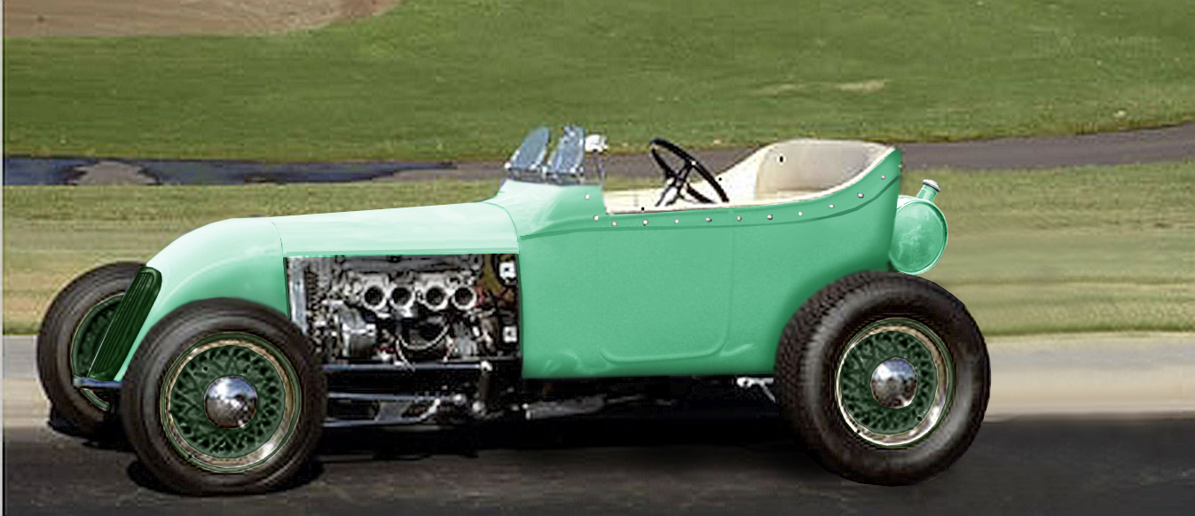

  1. Looks pretty good, Zandoz!

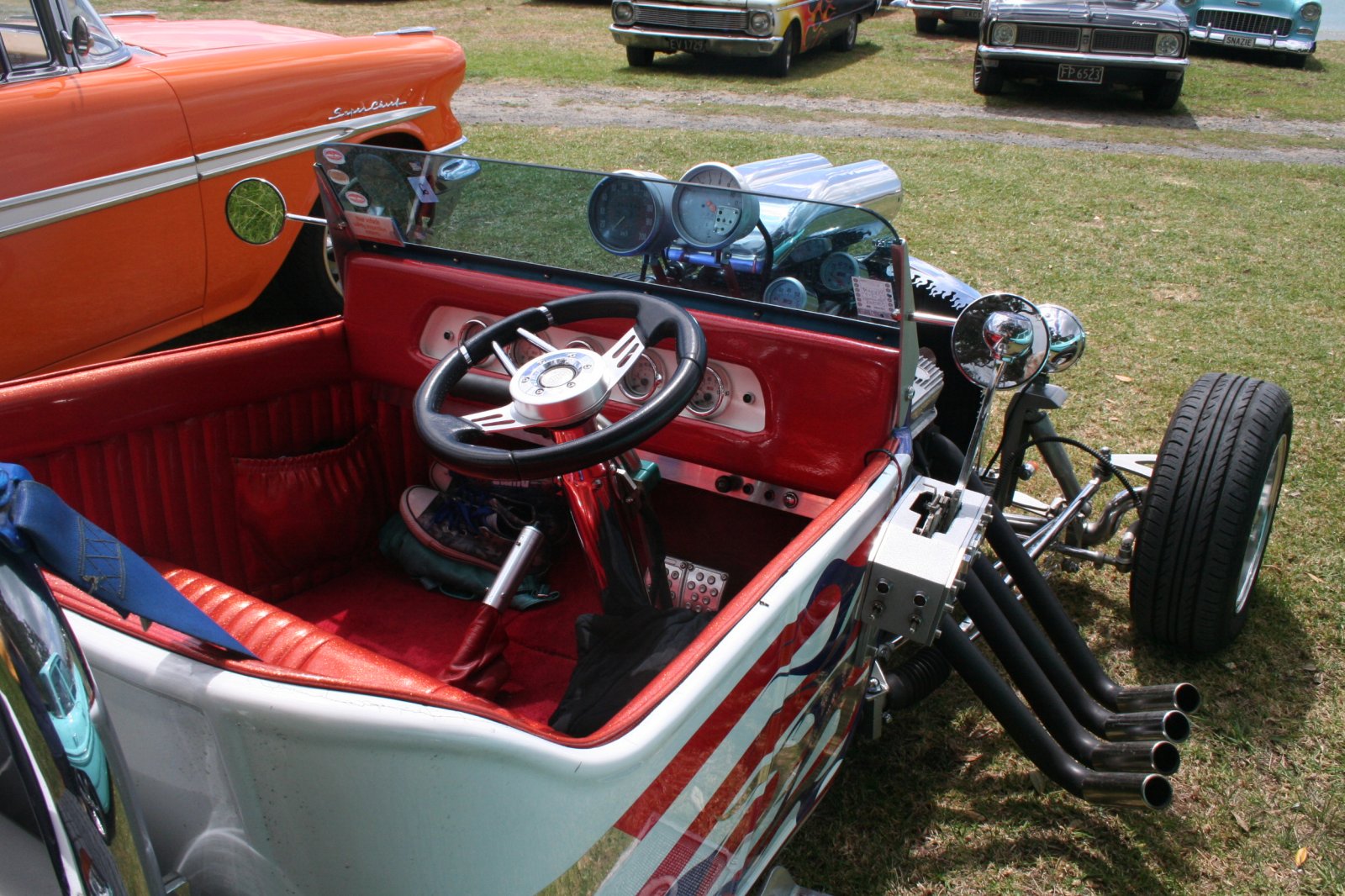

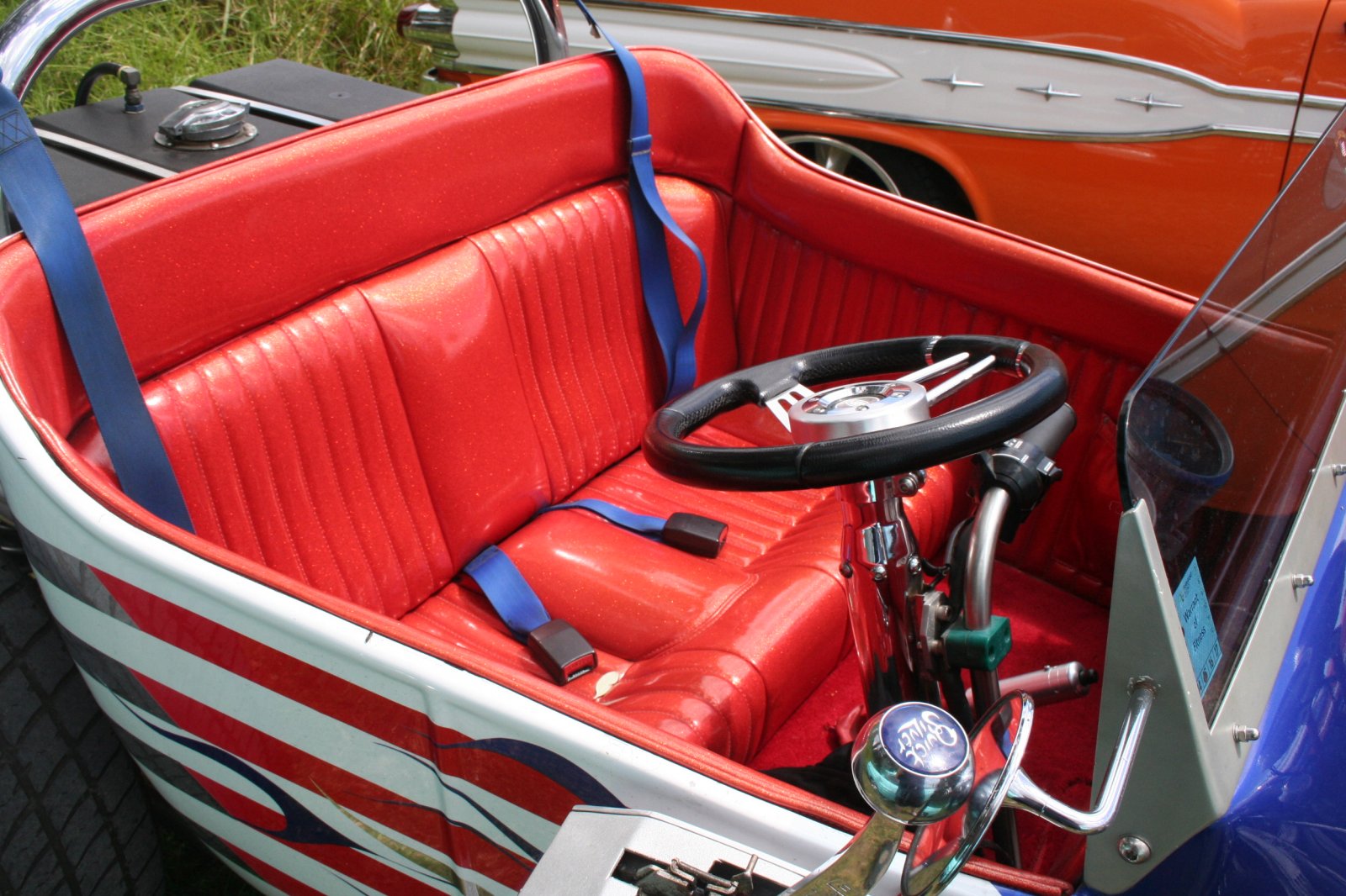

    I couldn't quite figure out the controls on this T the first time but I think I get it now. Still not sure why he mounted the shifter outside the body, but my guess is it's to accommodate his disability (I think I still would have done it differently, probably mimicked a Dragster brake handle, and mounted the shifter outboard under the body, and built / bent a longer handle to hug the inside of the body.). It's most likely on that side since his left hand will be busy operating the combined gas and brake hand control on the left side of the column. It looks like it has a motorcycle style twist throttle and either pushes or pulls to operate the brake. Not sure that's right, but it makes sense to me based on what I'm seeing.

    The shifter is on the outside because he will need to have his left hand on the brake so it doesn't take off when put into drive ( or R for racing). You could have it the other way round but that all depends on the drivers individual requirements.
    There have been some good ideas here on how to do alternative controls but the one where the steering column pulls back to stop and forward to go just will not work. Try grasping the wheel while braking and try to turn at the same time, aint going to happen and to pull back for braking is wrong as your weight transfer will be counterproductive as all will need the steering wheel/column for upper body support if their legs cant do so adequately.

    Back to the photo I posted, sorry,I didn't actually meet the guy who owns the car so I'm not able to say what his or her disabilities are to warrant having the shifter on the outside of the body. I too would of looked at other options for sure.What I do like is that the person can be out and about in his car and be accepted as well as anybody else.

    Herby's deal was toooo E-Z, It had a cable for go, and a rod to a power brake master cylinder, just pull to go, push to slow, (or stop)

    Got it and I agree completely it needs to be there, I was just saying I would have found a more (aesthetically pleasing) way of doing it (ie. locating it inside the body). The shifter he has (B&M Quick Silver) is very similar to the B&M Mega Shifter in the fact that the actual shifter mechanism is actually very thin (maybe 1" to 1.5" total width), and all the rest of the area under the box and trim plate is wasted space. I can see mounting it (without the Floor mount box), inside between the body and the upholstery, with just the knob and an inch or so of the lever sticking up out of a slot in the upper body. But like I said, I wasn't there so I don't know the full extent of the requirements to accommodate his particular disability. If this was one you modified (I'm pretty sure Marc said you had been involved in converting some? If so, GOOD on you for helping someone to enjoy their car, and I may need to discuss further with you for a buddy of mine), I'm not trying to knock the work, just offering an alternative approach. (God knows, you do what you have to do so the person can enjoy their car, the happiness it brings them is worth it! I have a buddy who is gradually losing the use of his legs, and we're slowly making plans to convert 5 of his cars to Hand controls ('28 Roadster Pick up, '39 Plymouth 2 door sedan, '56 Plymouth 2 door hardtop mild custom, '66 (or could be a '67)Plymouth Barracuda, and either a Plymouth Fury or a '73 Plymouth Satellite (he's planning on selling one and keeping the other). Definitely a Mopar guy, and these cars are important to him, so whatever has to be done for him to enjoy them, we're going to figure out!)

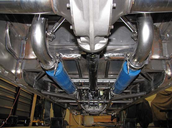

    I had a guy around to do a preliminary appraisal and he took a side on shot of the RPU that my camera isn't capable of in my small garage.
    Also a view from the winters qc looking forward.
    Then I removed myself from the picture :D

    Very cool Larry:D
