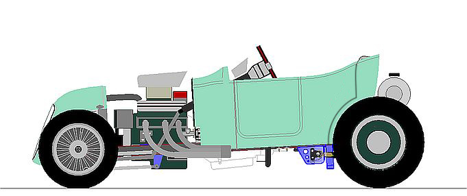

    I understand what you are saying, and I agree that moving the body line would be ideal, but I do not think I'll be able to. As the plans stand now, I'm hoping to do something I've never seen done before. I want to wrap the door opening under, almost to the frame rail. The opening will follow the forward edge of the raised door. The bottom of the door opening will actually be under the car. The trailing edge of the door opening will come out as close as possible in front of the rear wheel, and angle up to where the top of the body starts to curve around to the back.
    With my mobility issues I need as much unobstructed access to the seat as possible. Just moving the existing vertical door line back would result in substantially less opening. I'm hoping that when folks see the wheelchair carrier or powerchair trailer on the back, they'll understand the goofy door.

  14. Now that you have mentioned wheelchairs etc Bill I have a better understanding of your requirements in a larger door. Looking at your diagram, I would think you are on the right track as when the door is open, you should be able to slide from your chair onto the seat of the car and with the door going down low as you mentioned, there shouldn't be a sill panel for you to get caught up on. I will be interested in hearing about the rear suspension you are using as does that allow the car to sit down level for you.
    I hope I'm on the right track here and sincerely hope I haven't offended you if I'm on the wrong track.

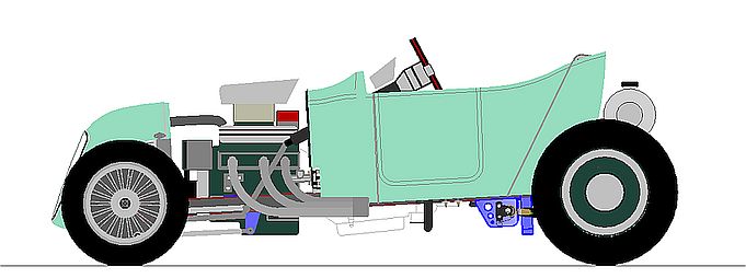

    About the "goofy door"... in my view, it only looks goofy because of the straight line from the top rear to the bottom. If that concerns you, you could make that cut a bit more aesthetically pleasing (to me) by doing something like this...
    Glen.

    I see nothing to take offence at. You are on the right track except for I have regained some ability to stand and walk short distances...but being totally wheelchair bound will be something I have to deal with eventually. For now what I'm trying to accomplish is to be able to sit down, and raise my legs to the level of the floor. Another feature I forgot to mention...I hope to adapt generic trunk hinges like below for the door,, so that the door opens completely out of the way.
    The suspension is kind of hard to explain. In general it's a triangulated 4-link with air bags and conventional shocks. The configuration should allow the car to kneel down about 3"-3-1/2".
    To accomplish that I have an '88 T-Bird Turbo Coupe rear end, with the factory 4-link bracketry. I have a set of Granatelli Motorsport tubular control arms, to replace the factory stamped steel ones. The control arms are configured to work with the factory anti-sway bar. They will connect to the frame with 2" Currie Johnny Joints. The air bags will mount outboard of the frame, directly over the axle tubes. The airbags will be Slam Specialties with internal bump stops. The shocks will be chrome PRO SM600s. The only bad part is the bracketry for attaching the Johnny Joints will be unconventional and will have to be fabricated.

    I had considered that configuration, but it makes the reinforcing ribs for both the door and the body much more complex...and possibly less sturdy. With the straight line, I'm hoping to use one piece of ash cut to the contour of the body, running all the way from the body lip down to the frame. That piece would be fastened into the body and cut when the door opening is cut. With the curved opening the framing would have to be pieced or made from a HUGE piece.
    KiwiGlen likes this.

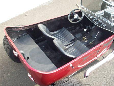

    I also believe I now have a better understanding. I suspect your in much the same situation as my friend here. I see where your going, and I like the modification Glen made to your rear door line, The cars I saw were cut like this (I modified the drawing, with no regard for the body line (they literally cut right through it!). The car would have looked better if they just ground the body line off! Have you seen the Wintec Roadster bodies? They might be very well suited to your needs. Kind of a shortened Tub / lengthened Bucket hybrid.

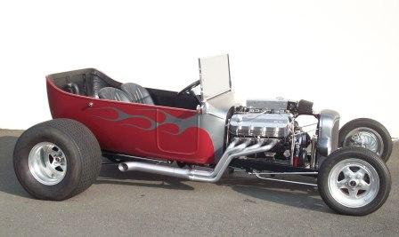

    Ok Bill, I couldn't find Graham but I found his T modified. I think this is very close to what you have in mind and would work on the earlier T bodies.
    Jeremy:D
    greaser and volvobrynk like this.
