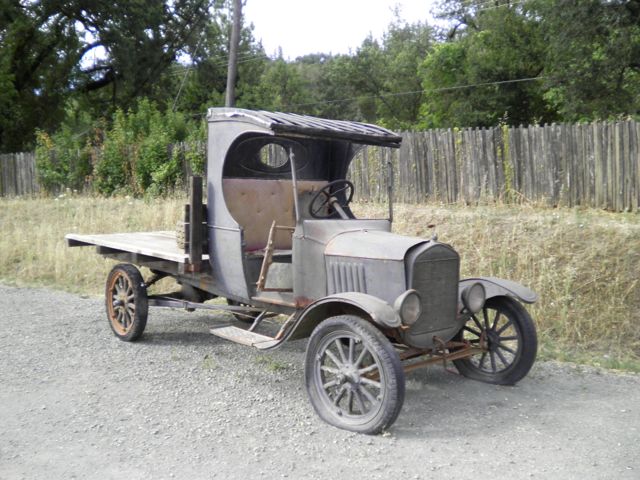

    I'm sorry I didn't take time yesterday to acknowledge you, we got off on some tangents and I forgot. While not a T-Bucket, I really dig your C cab a bunch! That's another "gotta have one someday" deal for me. I had a C cab body about three or four years ago, but unfortunately someone else needed it far worse than I did and was willing to pay for it. I do know where there was a super nice original cab in a very out of the way tiny "townlet" in southwestern AZ, and I have tempted to go back and see if it is still there.

    One in my neck of the woods. I'm sure it could be bought.

    i believe the c cab has touring car doors .bottom rear of the doors are supposed to be crurved not straight. truck still looks good.

    me thinks truck doors are NOT curved at back.....

    That's right, C -cab truck doors are unique, and are square on the bottom corners.

    That would be a big nope! The tourings used the same p***enger side door as the roadster did, and the same cowl. The easy way to tell a Ccab cowl is the door front jambs continue all the way down to the bottom of the body, where the roadster and touring, the jamb curves and runs back at about five inches from the bottom of the body. The other obvious difference is the left and right doors on the C cab.
