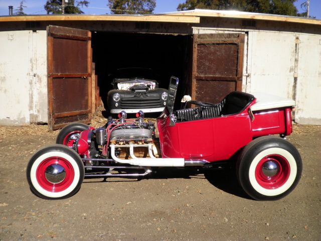

    Think this the same body as mine.

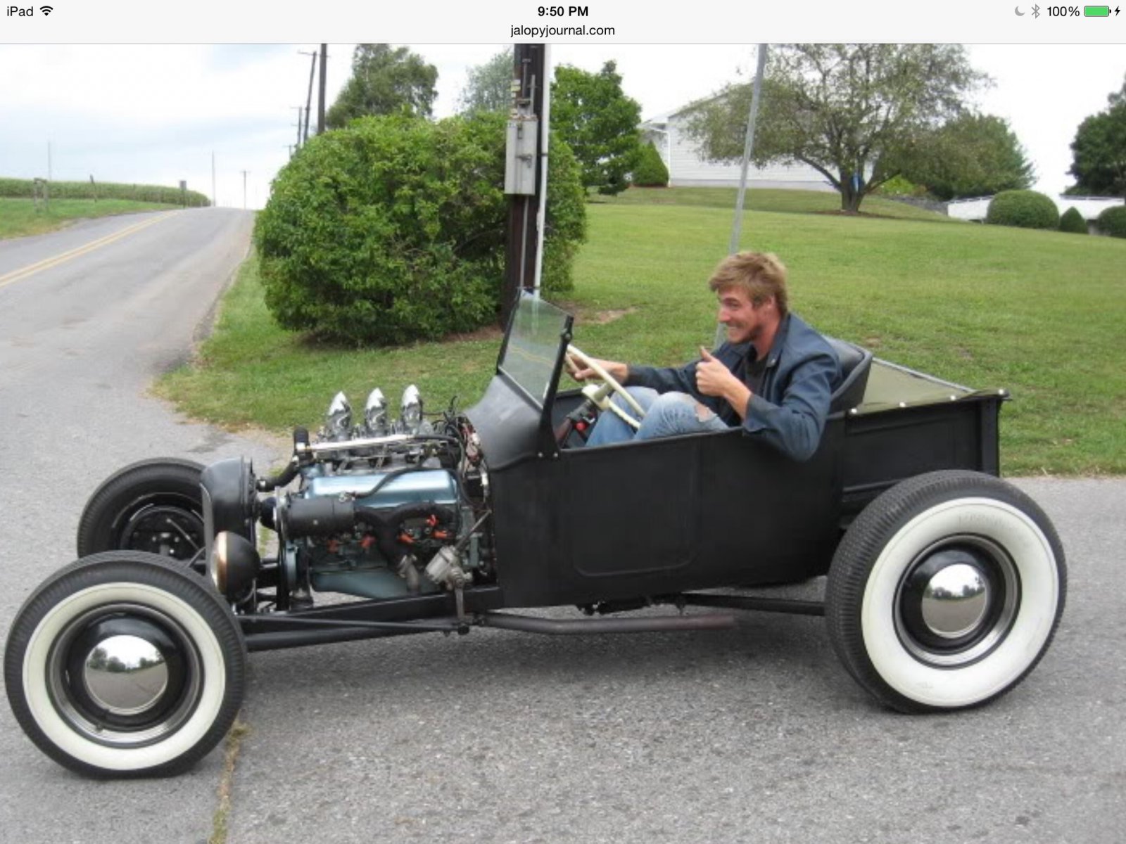

  9. Yes, Chip is extremely busy with his customers work plus helping friends wit their rides. He is only on Faceache long enough the say that too. Atleast he will be making a dollar or two to help get his T finished.

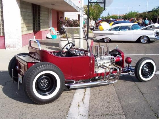

    Hey T guys I'm building a C cab and have a question. I made my windshield support rods out of 1/4" rod and they wobble a lot . Should I use tubing instead of rod.?

  15. One more addition to Gary's input. If your radiator is mounted with springs on the mounts, the rods should run down to support it.
  16. I would definitely would use tube to make the screen supports as it is stronger then solid round. Ask me how I know this...... yeah it isn't funny when the stay breaks down the front end and tries to dig into the tarseal as you drive down the road at 35mph. Luckily it happened on the drivers side so I could reach around the screen and hold it up until I could stop.

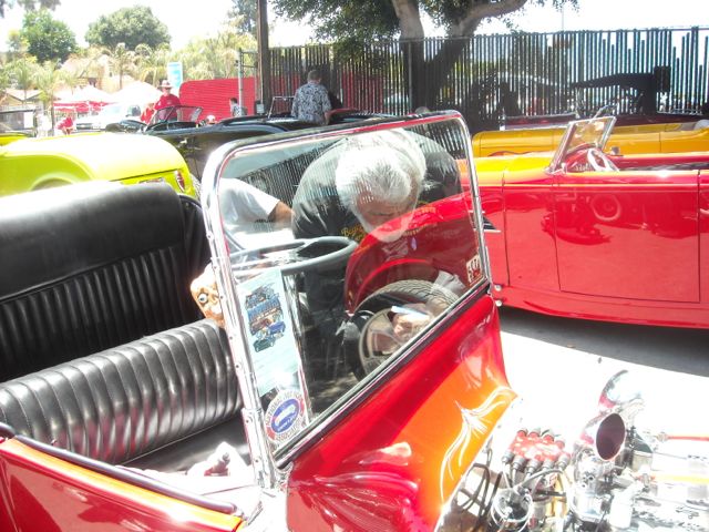

  24. I definitely think their necessary on a roadster with a tall top (parachute?!??!)! As it is, the top half of my windshield keeps slowly working it's way back to about a 20-25 degree angle due to wind resistance. The braces attach at the hinges now. I thought about either a) moving their attaching point up to the top of the windshieid (but I think it will look goofy), or b) replacing the functioning hinges with solid ones (I really dont see me wanting to lay the top half of the windshield back for any reason). Dirt T , your C cab windshield sounds like it's too short. You might want to look at how the wood header panel is on a canvas top and do something similar to your car.

    Actually, Normie told me in an unguarded moment - we were in the Burbank Pickups Ltd. together - that he added the braces because the knuckle-headed actors kept pulling themselves up out of the seat by the windshield and breaking the glass.
