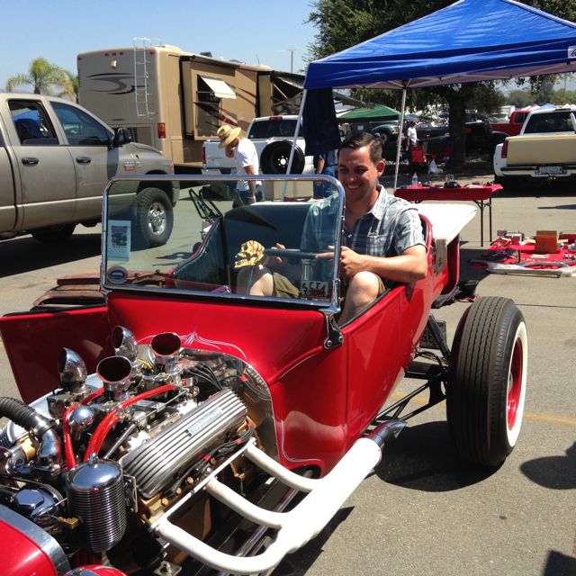

    Might be the only photo I took at LARS this year. Tim with a T. A little inspiration for him. The new red hoses look good in this shot. All went well on the trip. Talked to a lot of old and new friends. Participation was down but it was hot and we're all getting a little older except for Tim.

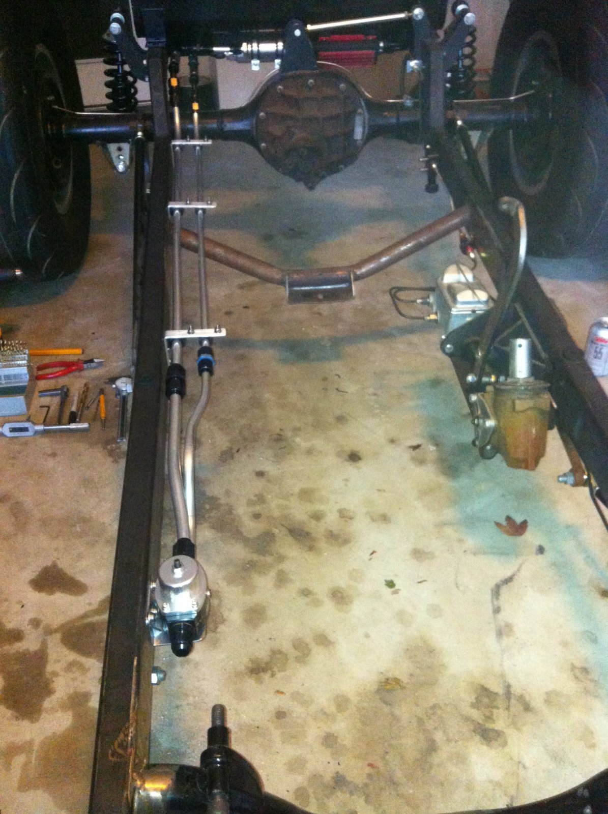

    I don't post a lot but do enjoy this thread. I've been working on a T-Bucket for the last year off and on. It had been a stalled project for ten years when I got it. I kept the frame, body, and axles for the build and utilized a good bit of left over parts I have on hand (some OT for now).
    I just finished the fuel and brake systems this weekend after a month working on it off and on.

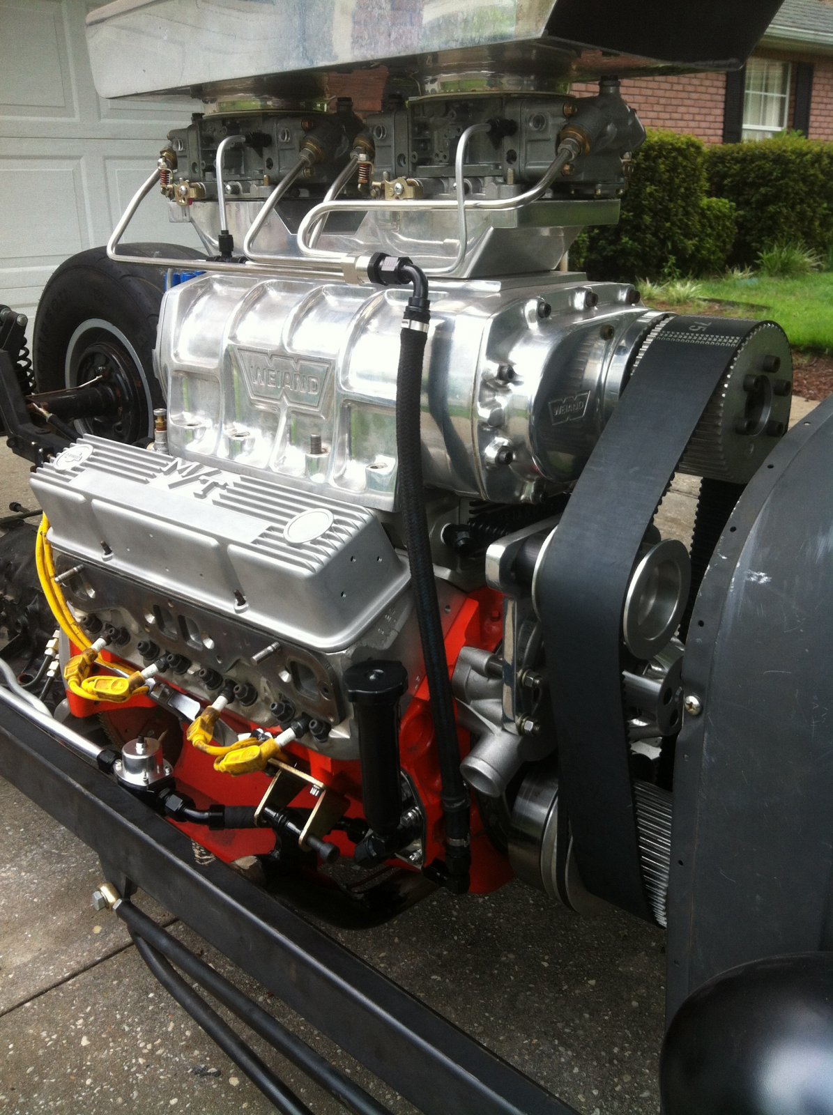

    image.jpg image.jpg So I dropped the drivetrain back in to make sure everything cleared and fuel lines still mated up between the rail mounted regulator engine feed lines.

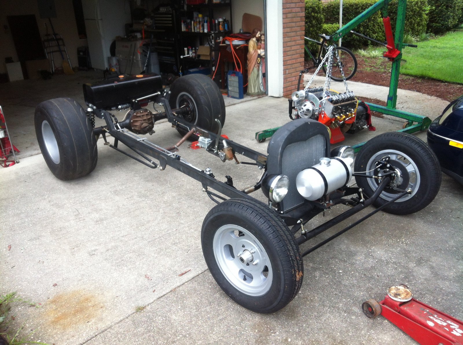

    image.jpg At least it gives the appearance of getting closer with the engine in.
    image.jpg And this is it mocked up with the body. A lot of work yet to do but getting there. Next is driveshaft and loop.

    I'm wondering if that Moon-esque tank in front of the radiator might block airflow enough to cause cooling problems.

    Thanks for the warning about possibility blocking airflow. If it causes issues I'll take it off.
    I was going to use it as a feeder tank to the rear tank. Was going to leave the bed top enclosed with the main tank there and feed it by the "Moonish" tank up front via electric fuel pump.
    I've since decided not to do so. I may use it as a radiator overflow or just take it off. I'm still mocking a lot of things here and there till I make my mind up.

    Olmikep,I like the look of headers too. pretty nice looking T,going tobe great when it gets some shiny paint on it. The moon tank thing is just trendy junk ,except if its a drag race only car,dose not belong on street cars. Your valve covers look like there is some type of vent on the out side wrong place for vents=leak all over the side of motor an make a mess over a fairly short time,vents need to be near very top of high point of cover only,mostly you see them on the intake side or top, not EX down side,you maybe able to just turn them around if they don't hit blower. The steering arm from your steering box is super bad place,some rethink needs to be done on your mount up and placemint{ maybe up 2in. or so/make box come through frame, ,As is, anything you run over that's a little high can crash you,by hitting the arm and steering the rod hard right out of control. Headlight are just a little too low to work well,up only a few in. makes a big def at nite lighting the road. Take this as helpfull info

    Nice looking T right there but please loose the tank in front.JW

    Agree w/Dana. The front mounted tie rod can be a challenge to get Ackerman effect correct. The car's lines look great.
