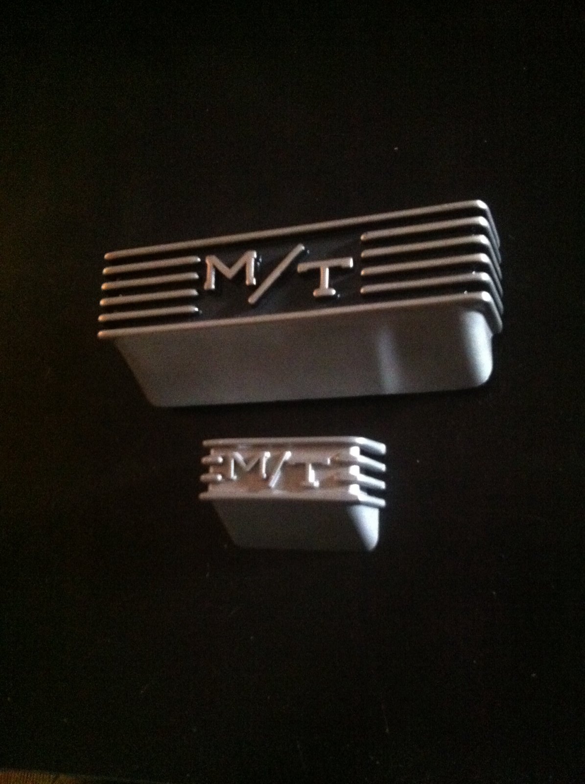

    I understand what your saying but I believe the internal baffling/gasket design will prevent leakage. I have seen some of these vintage Mickey Thompson breathers run this way in the past and set mine up in the same manner. I am also running a PCV set up to use the vents to **** not blow.
    image.jpg image.jpg The gaskets only have a couple small holes in the bottom portion below the baffling.

    AFA the drag link being that low , I'm not a fan , but that's how TP did it forever.... AFA the breathers , if you're running a pcv ,w/o any sort of "media" in the breathers , you'll be ****ing in airborne dust & bugs , not good IMO.....Lastly , unless you really like alot of vibration , fatigued fasteners , cracked welds , etc. I'd lose the solid motor mounts...

    Good thinking, I should be able to make up some filters easy enough.

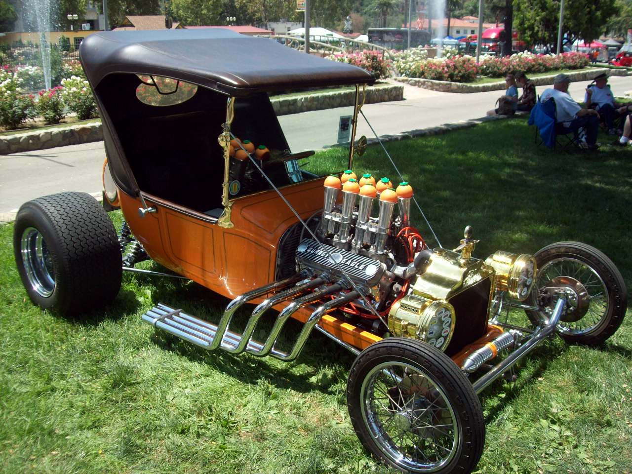

  19. 01mikep
    Joined: Jul 26, 2014
    Posts: 125
    01mikep
    Blownfuel,
    What type of spring set up is on the T? From the angle of the picture I can't see how it works. Looks overly complicated but must serve a purpose.
  20. verde742
    Joined: Aug 11, 2010
    Posts: 6,588
    verde742
    Has kinda of a bell crank on each end, stationary in the middle, as the "L" shaped bell crank, moves, collapses the coils, horizontally.
  21. nobux
    Joined: Oct 19, 2002
    Posts: 648
    nobux
    It's an opposed coil-over style front suspension.
  22. nitrobrother
    Joined: Dec 24, 2004
    Posts: 4,379
    nitrobrother
    Must be a young'un! That's a Dan Woods ch***is...a little past the HAMB period, but here's a thread that talked about it.
