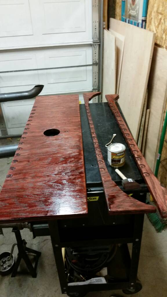

    Tonneau cover progress! It took me long enough!
    Stained the top in hopes of protecting it. Hopefully it never gets soaking wet anyway, but I figured why not?
    Painted the bottom.
    Set up a tape border so I would have a guide for how much to stretch the upholstery over to staple.
    Done. Not perfect, but pretty good for home brewed.

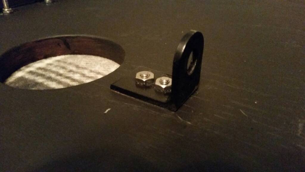

    Wow- nice. What is the piece of angle iron with the hole for?
  20. Tim_with_a_T
    Joined: Apr 30, 2011
    Posts: 1,747
    Tim_with_a_T
    Wayyyyy back, months and months ago, I explained that sorta kinda. I made that angle bracket to hold a striker pin, which will locate in this extra "bear jaw" door latch that will hold the tonneau closed. I used some extra Lokar throttle cable bits to run a cable under my seat. That way I have semi-secure storage with no visible hinges or latches.

    The hinge is up against the back of the body (sandwiched between the foam/vinyl and the wood), and the latch is at the back of the bed. The striker on the tonneau comes down as you close it until the jaw clamps around the pin to hold it in place. I will run a cable through the body on the driver's side to under my seat to open the tonneau. Sorry for the verbal explanations. I thought I had pictures of all this, but I don't.

    There, you can kinda see what's going on in this photo. The latch and pin are on the bottom of the board in the taped area (closest to where i was standing to take the pic). 1441230242053.jpg

  29. I see (I think). Is the part (the points) that wrap around sides of the body a seperate piece? Ie. fixed to the bed?
  30. Tim_with_a_T
    Posts: 1,747
    Tim_with_a_T
    Exactly. The pointed part that ****s up against the body is bolted to the body, and is a separate piece from the tonneau, which is held together with the hinge.
