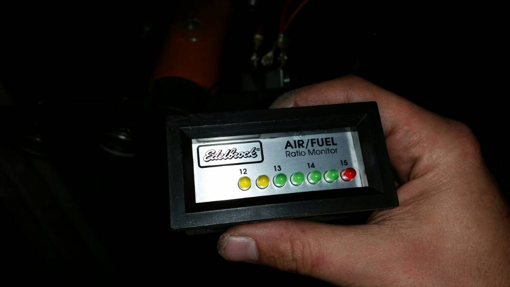

    One thing that might help you out in addition to the vacuum advance unit is an AFR gauge. I got this cheap-o Edelbrock one that seems to work reasonably well. I used it to base tune the primary carb on my ghetto fab / redneck engine test stand, and it proved that I was running very rich! Much cleaner now.
    Pretty simple to install, too. You just weld in an O2 bung to your header. I welded it underneath so it won't be too noticeable, and when I'm not tuning, I can just plug it off. I think I spent $125-$150 on the whole setup - AFR, supplied bung, extra bung and 2 plugs. Is it the best tuning aid out there? Nope. Is it a great tuning aid for the price? You bet.

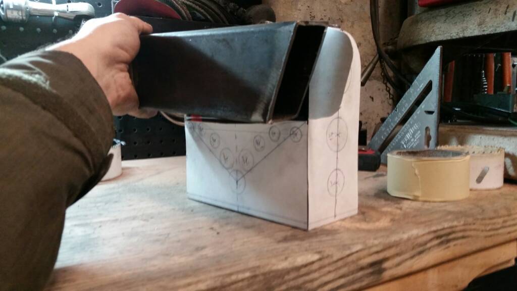

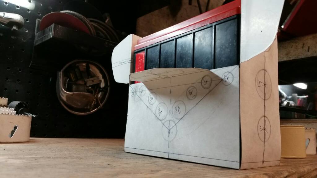

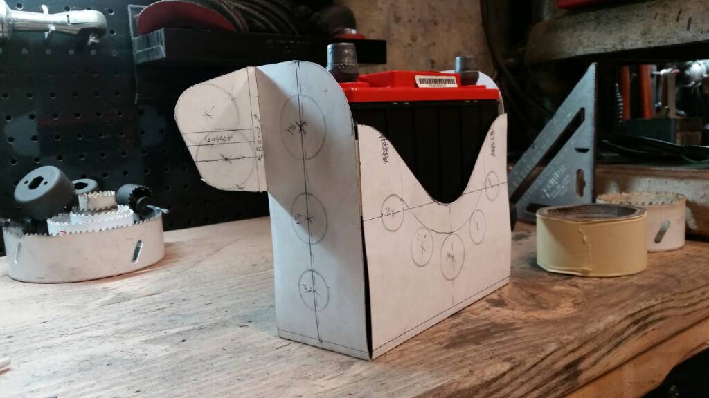

    My next project, which will either end up a complete disaster or total success, with nothing in between:

    Tim, I like your battery box idea. I've had something similar (but not as neat) floating in my head.

    4 MPG?!?! I was around 11 or 12 or a little better but I THINK I'm doing slightly more than that now.
    Got rid of the Holley fuel leaker and, in desperation for a couple more runs, went to an old Quad I had kicking around and it actually drives much nicer and cleaner...but power does seem down a little as well. I can live with that as I don't race the car at all and theres still lots of useable power for the road.
    That must be one hell of an engine you have up front Blownfuel!!! ;)
    Tim...really impressive work you're doing! Cool stuff!!!
    That high tech fuel gadget is interesting.
    Being the eternal cheapskate, I mean Hot Rodder, I'm thinking the same thing could be pulled from a parts car and maybe use an OHM gauge to do the tuning?
    You would just need to know the parameters for the sensor I guess. Bungs are available at parts stores like NAPA.
    I'm not up on this electronic stuff at all but it seems possible! LoL
    I can see that being an excellent tuning aid!

    I hope you're incorporating some means to lock the bat. in place , you don't want it bouncing around in that box ...

    "Being the eternal cheapskate, I mean Hot Rodder, I'm thinking the same thing could be pulled from a parts car and maybe use an OHM gauge to do the tuning?"
    The standard O2 reading is voltage, 0 to 1 volt. Low V = lean, high V = rich.
    You could hook up a DVOM to read, but it moves very fast when operating properly, Oscilloscope fast!
    That's why the little box with LEDs is the way to go. It probably could be built, but you want something that is working properly from the start. Radio Shack probably doesn't have a kit or schematic to build one, and you want something that is right to start so you can concentrate on learning how it works and how adjustments affect the readings.

    I considered using an O2 sensor and a multi-meter to do just that, but I never found an article explaining how to filter out the erratic readings. You would need an oscilloscope or something, kinda along the lines of the info RodStRace posted.

    If everything goes according to plan, the top of the battery will **** up against the surface of the floorboard (wood), and I will have two small port holes I can cover with insulated metal plates under the carpet to access the terminals. I will install the battery by sliding it up underneath. There should be enough play in the box after bending to give the inside of the box some type of rubber bumpers around the perimeter of the battery. That's why I said it will either work out flawlessly or be a total disaster lol. It has to be close to perfect or it won't work. It will be a good exercise of my skill and patience. And quite possibly the s**** barrel!

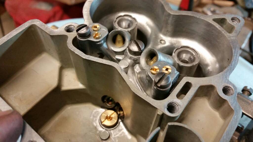

    As far as fuel economy goes, I read quite a bit on the tbucketeers site of other T's comparable to your numbers, Blownfuel. It seems that what kills fuel economy in a T is the steam roller tires under inflated, the unnecessarily high rpm stall converter, the tunnel ram / blower setup, and the lack of vacuum advance. I think you have made good progress to get where you're at. When it was dyno tuned, was the mixture dialed in at cruise as well, or just idle and all out?
    One of the main articles I read that made me want to tune with a wide band was this one :
    http://www.superchevy.com/how-to/engines-drivetrain/0510ch-carburetor-tuning-gas-mileage/
    Warning! Off topic T bucket / HAMB material in the link above! But it has EXCELLENT information. I learned a lot from that. That fancy program they use is expensive, so my cheap-o Edelbrock meter, a vacuum gauge, a tach, and some way of tuning in the carbs will get you close. I even considered a scenario after I get the car running, that I could use my phone or a GoPro to record the readings of the vacuum gauge, tach, and wide band meter under load / while driving. Then after, I could graph ("data log") using Excel exactly what that program does for zero additional expense and using what I have laying around. You can even download an app on your phone measuring G force, so you really could do the whole package with stuff most hot rodders have laying around or could borrow.
    This is what I did internally to my tri power carbs after reading that article:
    I modified the Rochester carbs to accept Holley screw in air bleeds, Holley jets, and I have an ***ortment of Rochester idle tubes I drilled various sizes. I'll try to get a picture of that stuff if anyone is interested later on.

    Nice work on your carb , I'll be looking forward to seeing how it dial'sin
