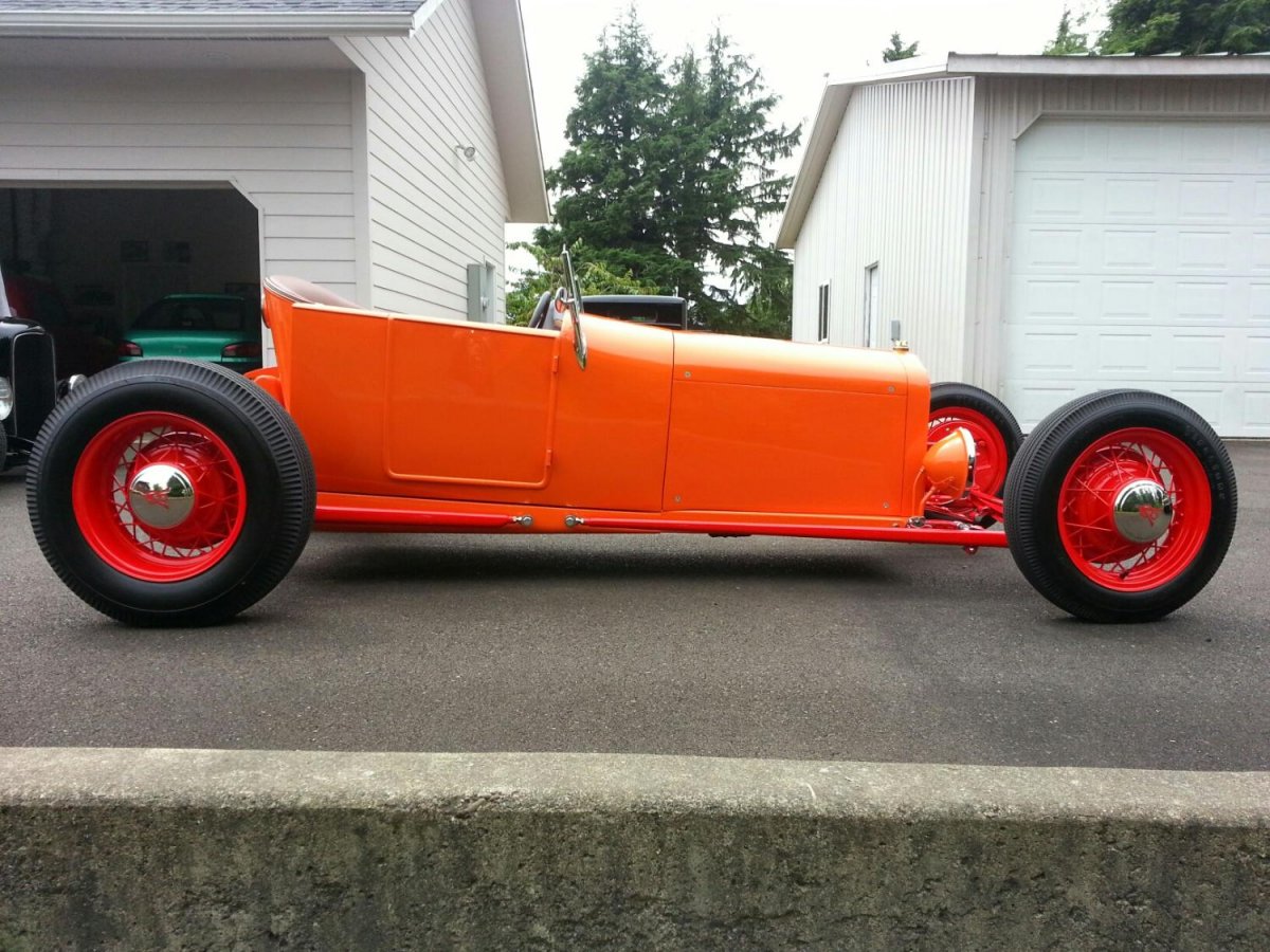

    Steel Rebel: The old Bo Jones modified, if I'm not mistaken; lookn' better than ever! It always looked real neat parked with his matching "T" sedan.
