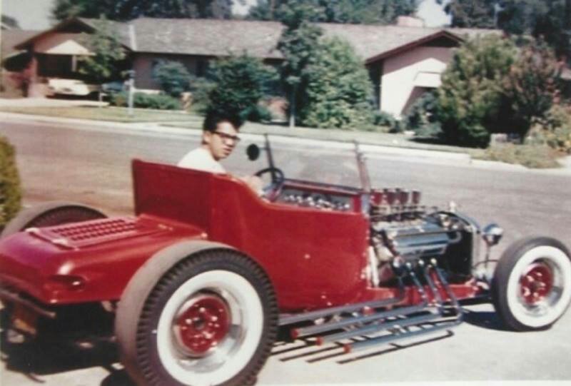

    That is the Gene Chan T bucket, you can see more about it here
    http://www.jalopyjournal.com/forum/threads/gene-chan-t-bucket.808757/

    Ooooooookay......... Here's the first of many episodes in my new build where I serve myself a nice, hot dish of CROW. I called Diana at CCR and she explained that the frame used for the stretched body is the same as the frame used for the standard body. They move the motor and ****** mounts forward to make up the difference in body length. This also closes the gap between the radiator and front cross member, that a lot of T Buckets have. I never understood the reason for that 6"-8" of empty space. So, I ordered a set of their blueprints, since I'm going with their body.
    So, I'm eating a crow sandwich and following the advice some of you guys gave to go with a 105" wheelbase. Mmmmm...... crow and fries!
