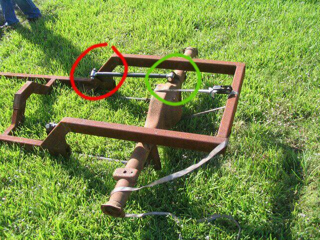

  1. Yip, you did, maybe its a rubber torsion suspension thingy.o_O JW
  2. Ha ha - pretty shiny rubber!
    Steve

  4. Rod end circled in red appears to be mounted at a 45 degree angle, rod end in green looks parallel to the ground.
  5. I'm thinking its not mounted in the front, looks to have a strap holding the housing up?
  6. Ok after a second look YOU are right. I'll look a little closer next time

    Maybe, but look at the other side also. Mounted the same way. I don't know, maybe builder left the jam nuts loose & allows the rod to rotate/articulate through the threads. Except that it's hard to see if there are any jam nuts.
  8. They appear non adjustable and are mounted at both ends. JW

  9. Looks like a do-over
  10. Looks like a "listen here I done sawr this on the Interwebz and it was goowarranteed to work good" effort.

  11. Well, it's a good thing Fred wasn't planning to use that frame (just the rearend), I just wonder if the previous owner gave up on it because he couldn't get it to work?

    Right you are. The person who threw this crap together didn't know what he was doing, but he had an idea of what he wanted. All I wanted was the housing. I'll be cutting all that other crap away this weekend and with any luck, when I take what's left to the scales, I'll have enough money to help pay for the posi 3rd member I plan on using.
