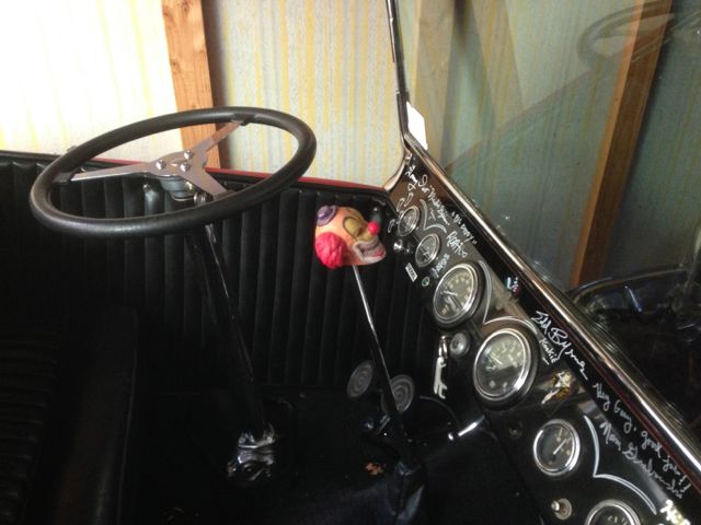

    Yeah Fred that's how i used to have do it. They have fixed something I haven't had to do it lately. I'll try to post something and see if it works. Yeah the Klown posted right up.

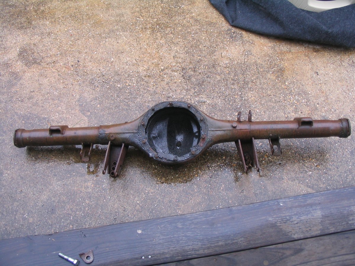

    And so.... the madness begins. Starting small and taking baby steps........ for now. Since this is the offspring of the first madness, this film clip came to mind.
  8. DDDenny
    Posts: 22,486
    Got it Fred.
    You were right, it is the later housing, nothing wrong with that.
    I've "carved out" a few of them myself, used cut off wheels and grinders, had a guy do one for me once, he used a torch, was not pretty, took some finessing to save it.
    That will work great for you, nice round, consistantly shaped tubes for welding on your mounts, etc.
    I don't recall what you plan on using for wheels, you may end up having to narrow this housing. When I built my roadster, I did not want highly positive front-set wheels due to using true knock offs, I actually added 1&1/4" to one axle tube.

    I'm really not far enough in to consider tire and wheel combos. When I see that bridge approaching I'll consider wheel offset or narrowing the rear. My next job will be building the frame. The issue is the weather. The frame table I'm using is heavy and getting to it will have to wait for the rain to let up here. It's in a guys garage and where the table is located is surrounded by a soaked lawn. Not willing to risk getting a trailer stuck, he's waiting for dryer conditions. If it was up to me, the frame would be done by now, but I'm being VERY patient. He's doing me a favor by also supplying the metal for the frame. So, I sit doing research and planning.

    Good score on the 9". I sorta did the same thing as you, but mine came from a 1968 E100 van haha. I think I gave a friend $50 for it, then sold off the 3rd member as it was 28 spline 3.23 open carrier for $50. I ended up narrowing it quite a bit, and I had 31 spline axles made for it (Dutchman narrowed it, put on new bearing housing ends, and made the axles). If you end up going this route, you can upgrade to the larger drum brakes some of the 9" had (which mine didn't have initially). They just build it into the axle offset. Anyway, a few things to consider if you find yourself heading down that road.

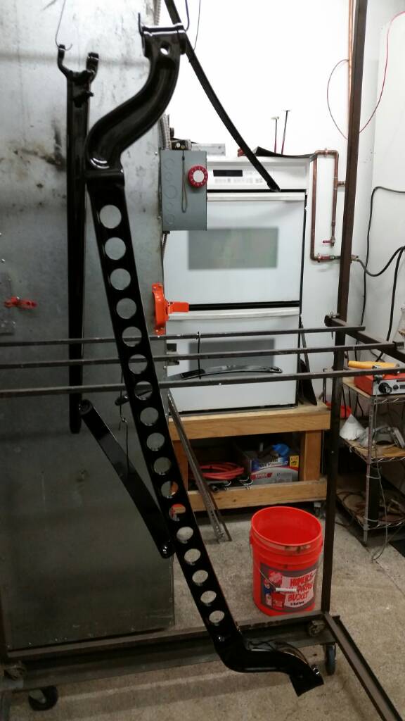

    That powder coating looks nice. Still trying to figure out my own powder coat oven because up here our powder coat shops charge too much for what they do.
    Was your guy expensive or reasonable ?

    Thanks guys. I'm stoked. And whip, you're right. This pile of parts sets the bar for the rest of the build. Guess I should get back to sanding soon lol.
    I'm going to publish the price I paid because I think he did an excellent job, especially considering the price. Not at all trying to brag. Keep in mind I did a lot of the prep myself, but he gave each part his finishing touches. As an aside, he also powder coated my wheels (which were in really sad shape) for a totally reasonable price, and I left all of the prep work on those to him.
    I paid $265 for the front suspension pieces to be powder coated all one color, which is the gloss black you see above. We are experimenting with the two tone antique white inside the webs of each part, so I'm sure the price will go up for that haha. But totally worth it.
    If any of you are interested in using him, his name is Russel, he does this on the side for fun, and he is in the Portland, Oregon area. PM me for contact info.

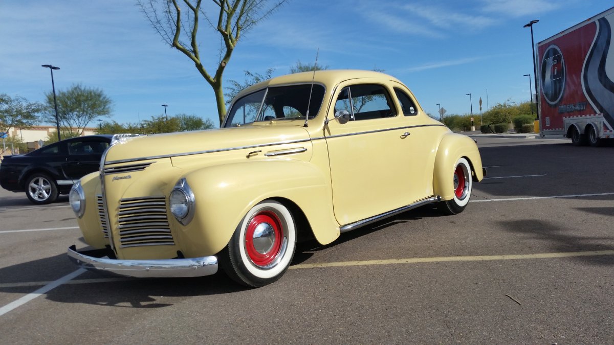

    The coupe got a new garage-mate today! It's a '40 Plymouth that'll be my daily driver....it's got AC!!! Arizona is gonna see a lot of this one.
  22. nitrobrother
    Joined: Dec 24, 2004
    Posts: 4,379
    nitrobrother
    Right off the transporter...
