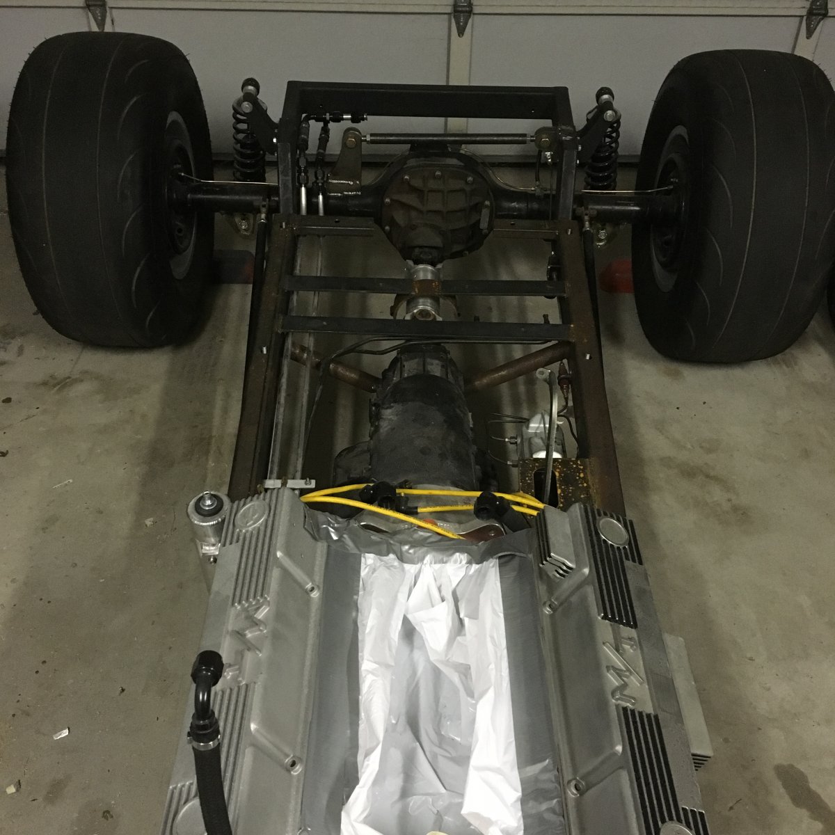

  8. 01mikep
    Joined: Jul 26, 2014
    Posts: 125
    01mikep
    The A body mopar 8 3/4 is a perfect fit as is but are not real common anymore and certainly pricier than a 8 inch ford when found.
  9. 01mikep
    Posts: 125
    01mikep
    Here is my non centered ford rear.

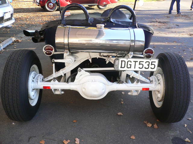

  17. 26 T Ford RPU
    Joined: Jun 9, 2012
    Posts: 12,603
    26 T Ford RPU
    I feel in love with this 27 T modified, but that love just couldn't include that rear end.:( JW
  18. tfeverfred
    Joined: Nov 11, 2006
    Posts: 15,788
    tfeverfred
    An illusion of mis -proportion caused by the spring. I'll bet, if this same car had a coil spring set up, you may not even notice. What say ye?
  19. tfeverfred
    Posts: 15,788
    tfeverfred
  20. 26 T Ford RPU
    Joined: Jun 9, 2012
    Posts: 12,603
    26 T Ford RPU
    Fred, with a coil set up I think you are right........carry on.;):D JW
