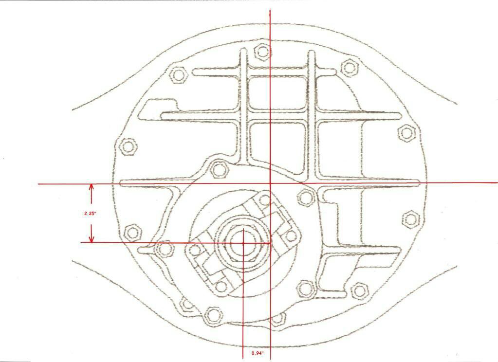

    Tim........ guys bear with me, I just re-read your build thread and saw your 9" set up. I'm rethinking going with a 9"....again. :rolleyes: Trust me, guys, by the time I'm ready to get a rear end for my T, I'll have so much info, I'll be an expert.... an expert example of over thinking and indecision.:D

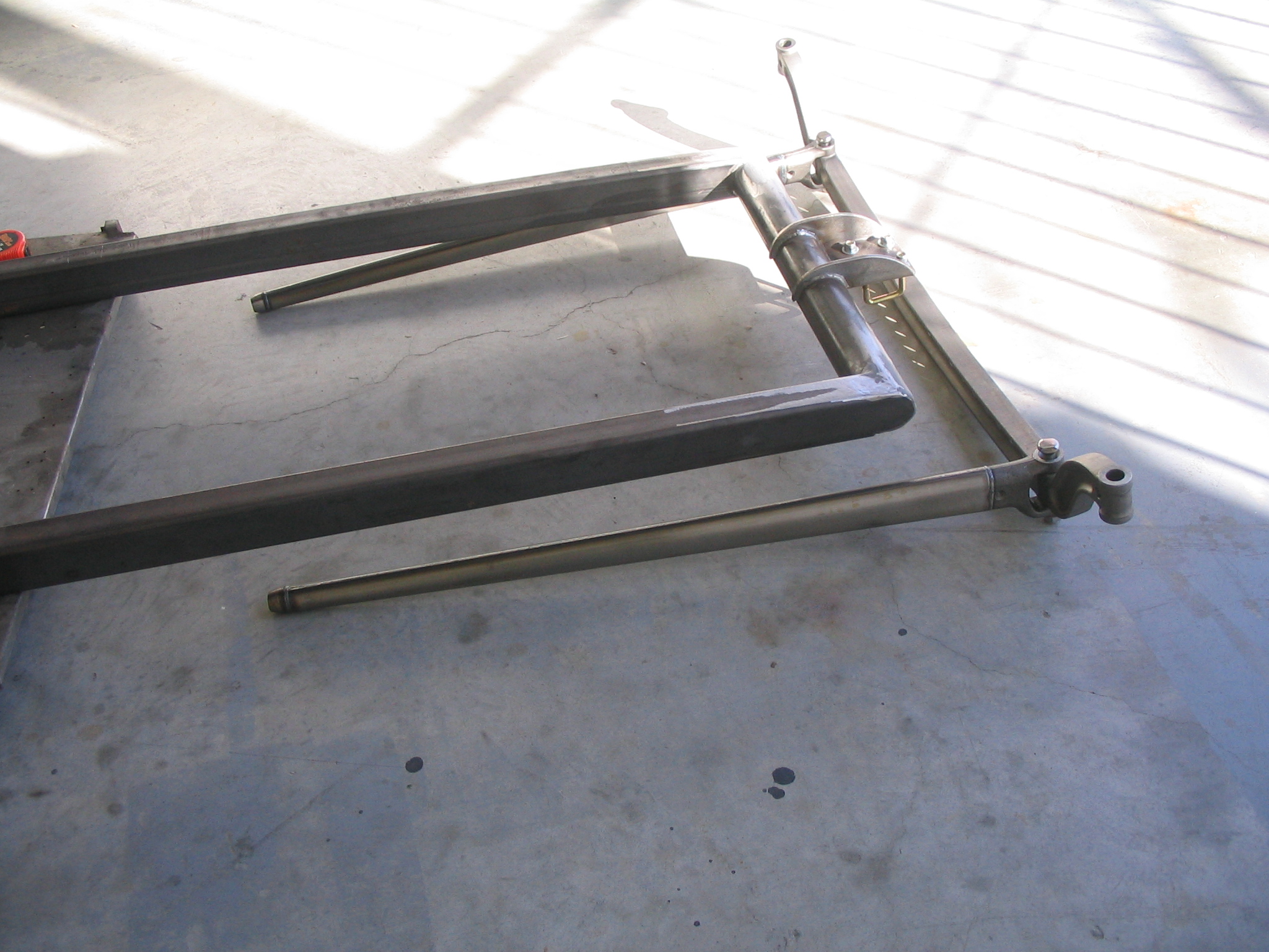

  27. tfeverfred
    Joined: Nov 11, 2006
    Posts: 15,788
    tfeverfred
  28. Here you go Butch but I must say that getting a clean shot at it with the exhaust, spark plug leads and the dirt was rather frustrating,and then add to the fact that my knee replacements don't allow me to bend down as much as I could when I was a young man. Hope you can see what you are after. You may notice the the inner wall of the frame has been scalloped out to allow the box to sit in tight. Also note that the drop arm and all steering shafts u-joints are stock factory manufactured by either Suzuki Carry Van, ( box and drop arm) and Honda, connecting shaft with u-joints as we have very strict inspection and certification system to build too and comply before we can register the car as a scratch build vehicle here in New Zealand. IMG_0746.JPG IMG_0747.JPG IMG_0749.JPG IMG_0750.JPG IMG_0752.JPG
