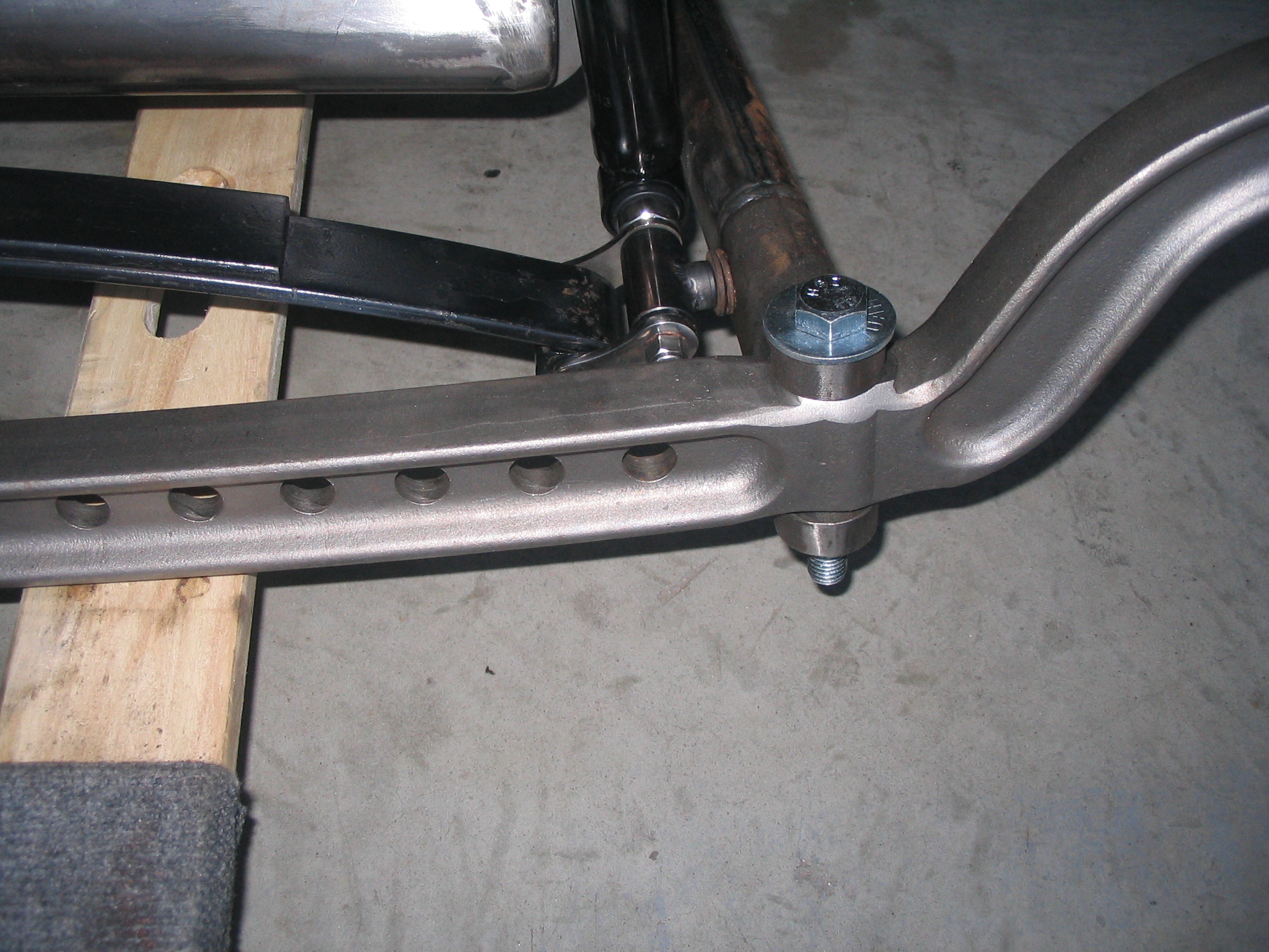

    Got my new spring and here's how it looks.
    New angle to the dangle.:eek: Oh.... those 5/8" bolts are for mock up purposes ONLY. Although I used some on my other T Bucket, for a while.

    That looks awful familiar to me Fred, :) Should be perfect.

    That looks perfect.

    Fred, what are you using for bushings to go thru the wishbones for the shackle hangers?

    I was discussing these 'bones and spring hangers with a friend and a question came up: since the the spring hangers screw into the threaded hole in the wishbone; how do they end up both tight and correctly "clocked" at the same time. I saw that they also make a set-up with a thru bolt on the spring hanger; wonder if they start the same yoke casting.

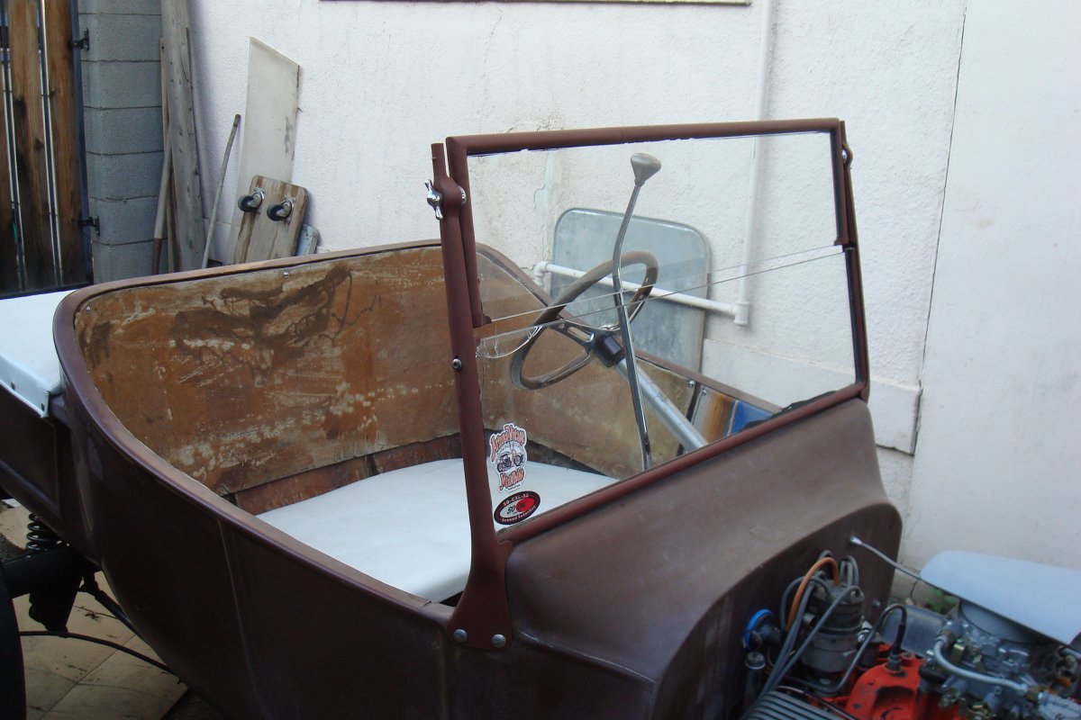

    The 'Bucket's upper windshield took a pretty heavy rock hit early last year, and I have been wanting to chop it a bit, too. So I took a day last week and handled the first part of the chop process. I cut an 1 1/2" out of the upper posts, and a like amount out of the frame. 'Course, since the frame was kinda cheesy '70s repro stuff, I chased cracks all over the place, then had everything sandblasted. Now stuff is looking decidedly cleaner than the old, silver paint over rust, tweaked posts and ****py chrome frame... The lower will find itself chopped and re-gl***ed soon. DSC06654.JPG

    How? Trial and error or maybe living the good life.:D The spring hangers are set at 5* and are threaded to the wishbone. I used a couple washers to get very close to the right spot. If you expand the pic, you can see that. BUT....... with a little time and patience, I will "clock" them without the washers or I'll keep the washers.
    Again, this was and still is, a fitment exercise. When it's DONE....... it'll be DONE.
