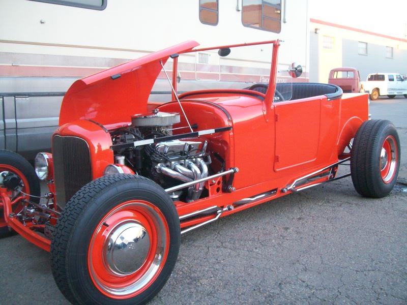

  8. Blue One
    Joined: Feb 6, 2010
    Posts: 11,506
    Blue One
    from Alberta
    When I built the bed for my RPU I started with a reproduction model A tailgate and then narrowed it 4" to better fit the back of the T body that I had created from the touring cowl and doors.
    With the 56.5" winters it has come together nicely.
    My rear wheels are 15X8 steel smoothies with 4" backspacing.
    I also have a set of American Racing salt flats, same size and back space.
    Good idea on getting a look at another car built using your planned body etc., Fred.
    Then you will know for sure what to do based on how you like what you see.
    Larry.

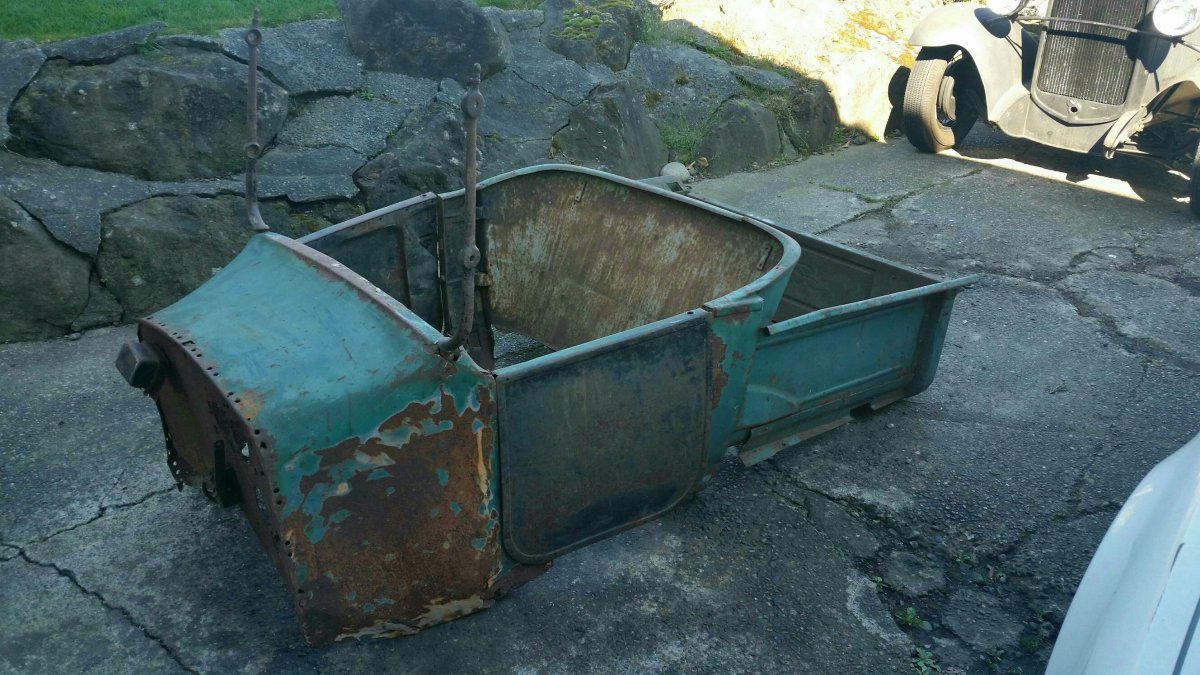

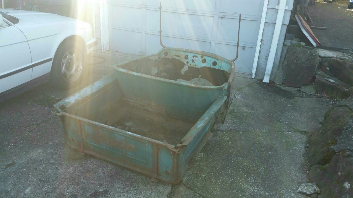

  18. verde742
    Joined: Aug 11, 2010
    Posts: 6,586
    verde742
    I have a excellent 1919 Dodge touring, its had a really nice job of shortening the rear doors out of it. Hard to tell it wasn't made that way from factory.
    Looks a lot like a "T" for fat guys,:D
    Body,doors, firewall, and W.S. post.
    $ 3,500.00 cash. :oops:Unadvertised, :eek: It just occurred to me: I will probably never do anything with it.:rolleyes:

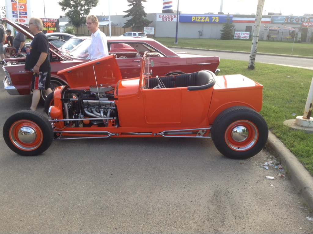

  21. Blue One
    Joined: Feb 6, 2010
    Posts: 11,506
    Blue One
    from Alberta
    Looks like you will fit fine there Fred. I'm 5' 9" and in my RPU with the extra 4" I added behind the doors I fit nicely.
    That along with the proper toe board angle and it's actually great. My bomber seats are right on the floor and my seat cushions are 4" thick.
    My buddies stock length RPU is too cramped for me. It fits him perfectly as he's about 6" shorter than me. :D
    This car inspired me, I love riding in it. :cool:

  26. Blue One
    Joined: Feb 6, 2010
    Posts: 11,506
    Blue One
    from Alberta
    Hey Fred, when Dave built the car he wanted to incorporate the mounts for his hairpins and added the rails using square tubing to add a space frame look to the rectangular tube frame.
    He just sort of put it together one day and it looked good so he went with it.
    I like it, it adds a unique touch.
    You can see the ceramic coated exhaust too.
    That little car is full of innovative stuff and really nicely built.
    It moves along really well too with the 351 W and C4 power.

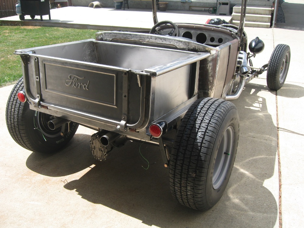

  27. That's a wooden bed too, right?
    Steve
  28. Blue One
    Joined: Feb 6, 2010
    Posts: 11,506
    Blue One
    from Alberta
    Good eye Steve. Dave was more comfortable working with wood so he built the box from wood. He works with wood as a hobby and builds some neat stuff.
    His cars are all well built.
    Looking at the box it has a super smooth resin coating before the paint was put on and it is finished very nicely.
    Fit finish and detail is really first class.
