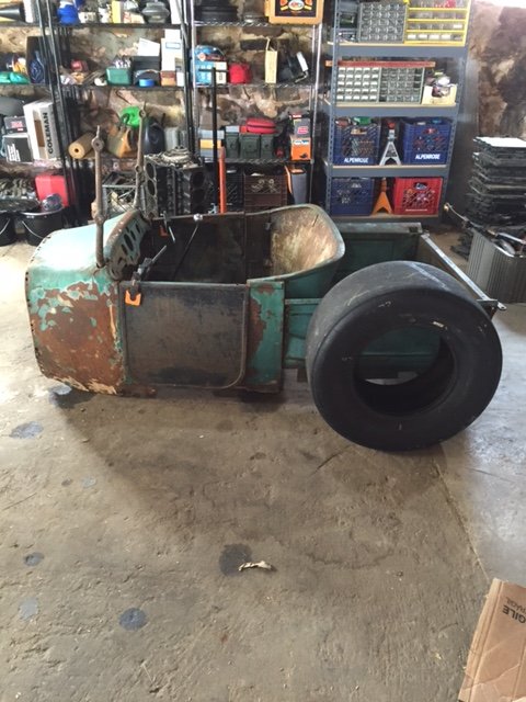

    I think I started something here.....

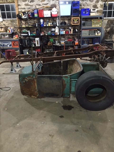

    Gonna look like this someday....

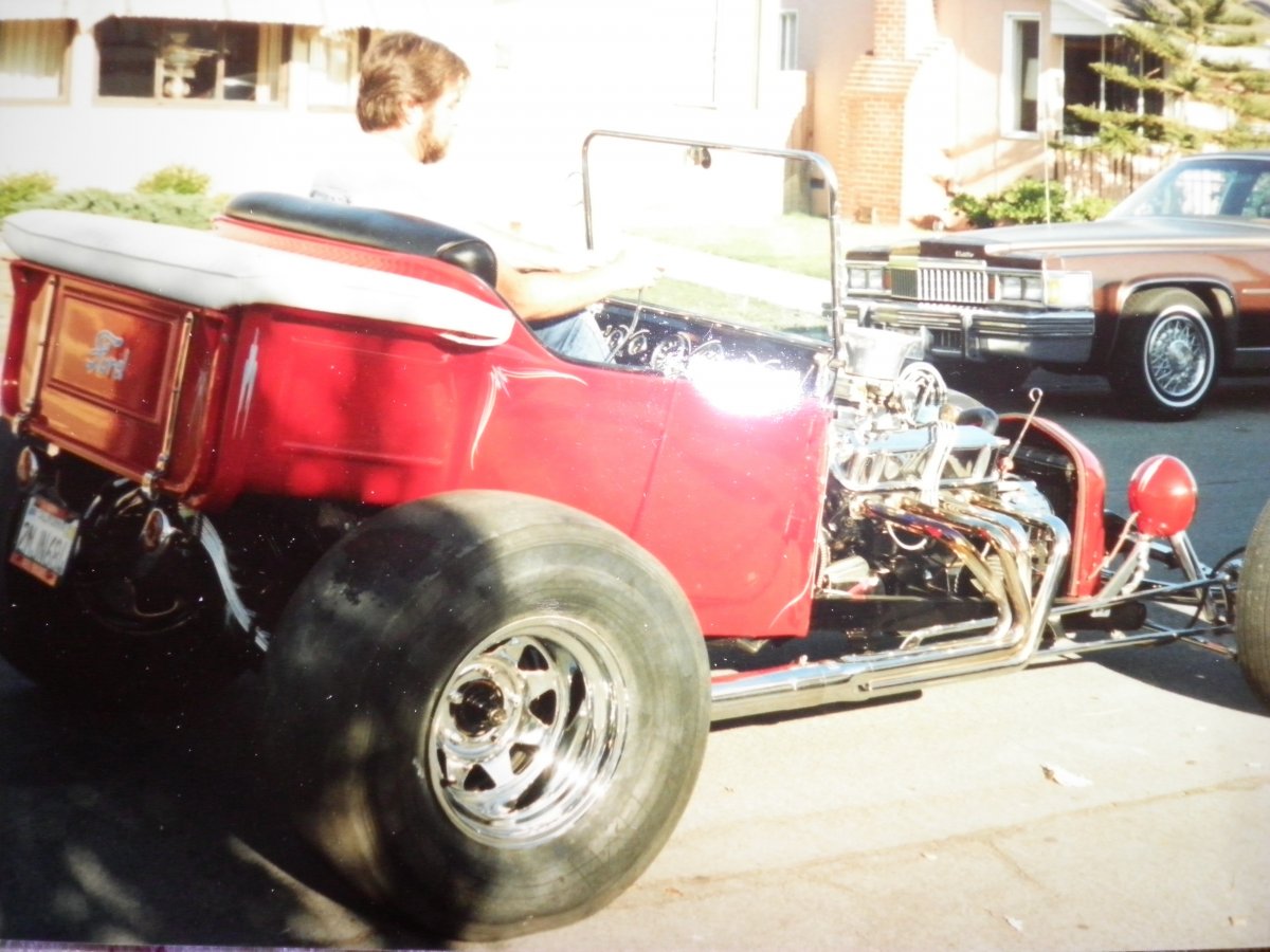

    My roadster has seen many changes. These didn't last too long. Like around the block once. They just bounced.

    Gary, WTH were you thinking?

    Fred, who knows what I was thinking. Pretty early in the finished build (early '90s). Look how dark my hair was. "growing pains"

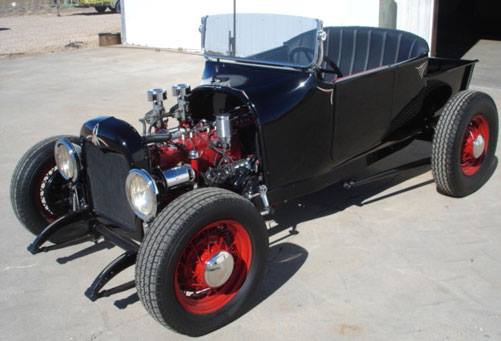

    This is collection of pictures of that Dodge, great little car.,

    Great roadster but the Ackerman is all up the ****, you can actually see the outside tire toeing in on the curves. JW
  21. verde742
    Joined: Aug 11, 2010
    Posts: 6,588
    verde742
    Ackerman is always messed up when tie rod is IN FRONT of kingpins...with a straight axle.
    Most won't ac-know-ledge it.
  22. 26 T Ford RPU
    Joined: Jun 9, 2012
    Posts: 12,595
    26 T Ford RPU
    That is incorrect, the arms need to be moved out toward the backing plates, same principle with the line from the rear axle centre, through the king pin and the through the tie rod end centre. JW

    The car is an old Prowlers car and is currently on display at Bill Smith's museum in Lincoln Neb. At least it was last Tuesday
    when I was there.

    It might be incorrect but doing what you said isn't easy to get done properly and even then I have always disliked how it looks.
  25. 26 T Ford RPU
    Joined: Jun 9, 2012
    Posts: 12,595
    26 T Ford RPU
    How can you ruin the looks by bending them out to where they SHOULD be.
    When that setup turn a tight corner one tire WILL break traction, but hey it looks good, not to me. JW
  26. Blue One
    Joined: Feb 6, 2010
    Posts: 11,512
    Blue One
    from Alberta
    I simply mean that having the tie rod out in front of the axle just looks wrong to me regardless.
