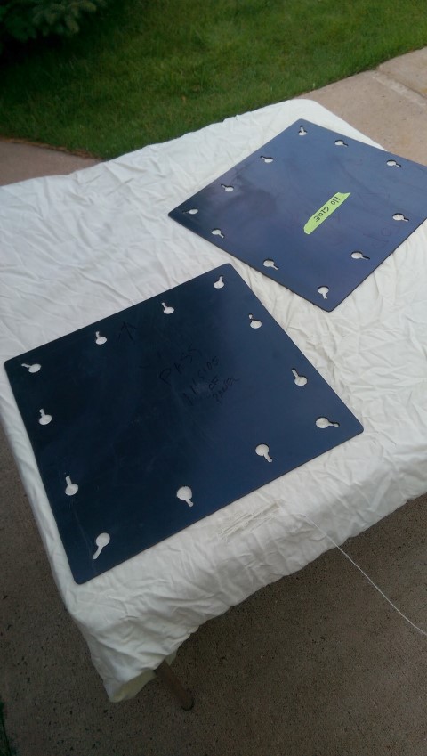

  5. Took a break from some other projects today and made some "door" panels for my T. Still want to add a pocket; but think I will run them this way for now. Maybe have to run over to Jenny's tomorrow and get some carpet for the kick panels. Next project; find where I put the end caps for the hide-em welt.

  6. 2OLD2FAST
    Joined: Feb 3, 2010
    Posts: 5,971
    2OLD2FAST
    from illinois
    That's alot of clips to hold that small panel , on my T doors I only used 4 per panel , my backer is 3/16 door skin [ply] w/ a coat of resin ......they've stayed in place for 14 years ...

  8. Blue One
    Joined: Feb 6, 2010
    Posts: 11,497
    Blue One
    from Alberta
    As you likely know a T door has a curve to it in both directions and if you want a plastic panel to follow that curve then you need the clips.
    It's more than a matter of staying in place.

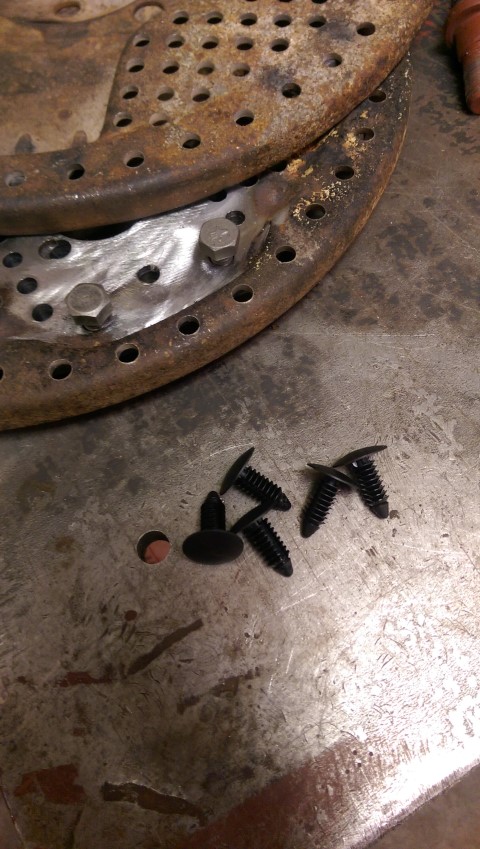

  11. I thought I would try something different and used push in fasteners. They were only pushing into some flimsy 1/4" luan plywood; so I opted for overkill quantity, besides it was kinda fun making keyholes in the ABS.
