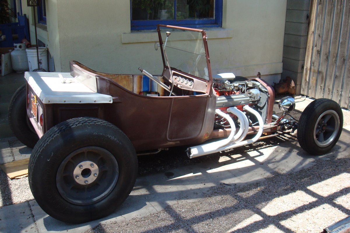

    Well, the 'Bucket got a new/old look back again this week, as one of my slicks decided to pack it in last week. the Halibrands were taken off the RPU, and duly bolted down again.
    It's funny, I slowed down posting over here a year or more, not because I didn't like the way the thread was going, not because I was mad at anybody, but simply because the demands of my business took my time elsewhere. And truthfully, I hadn't gotten that much done on the car to report. Then i took a look at an old photo from the last time the Halibrands were on, and I realize that since then, I've - Chopped the windshield, made, louvered and molded to the grill shell the front roll pan, built the grill shell insert, mounted the big tank with the center fill spinner from Halibrand Steve, made the teauno cover, properly mounted the license plate and club plaque, did a bunch of wiring, etc. Lots of stuff really. Sometime in the coming week I need to finally get the finned Buick front drums and F-2 brakes installed and tuned, too.
    Been busier than I thought on this one...
