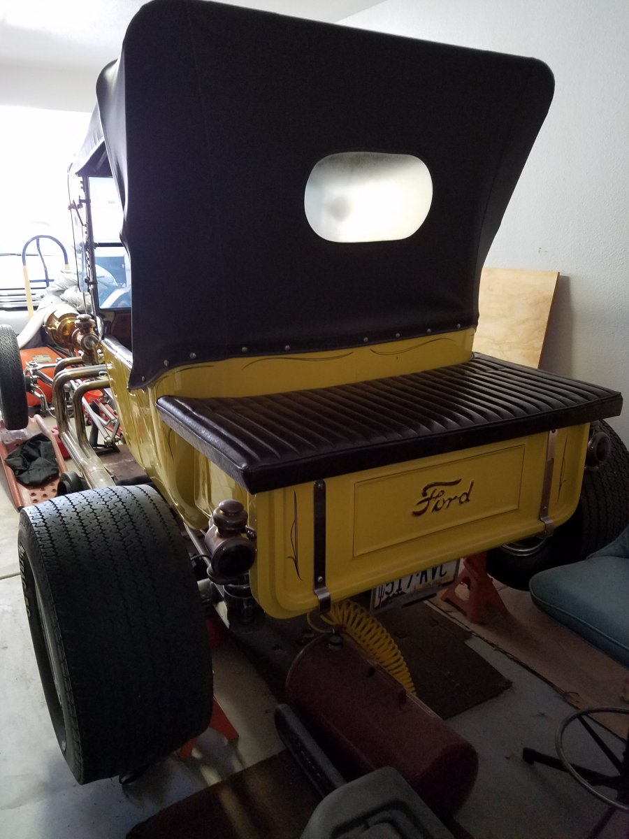

  2. Sorry it took so long after the teaser, so stuff went wrong at work this last weekend, and we've been on 12 hr days since sat. to try to get things back on track. Anyway, here are the pics (and yes, I know the coil spring front end isn't exactly attractive.). The cars for sale for $13,000.00, and is located in Lake Havasu, Az. 20160602_162656.jpg 20160602_162757.jpg 20160602_162632.jpg 20160602_162725.jpg .

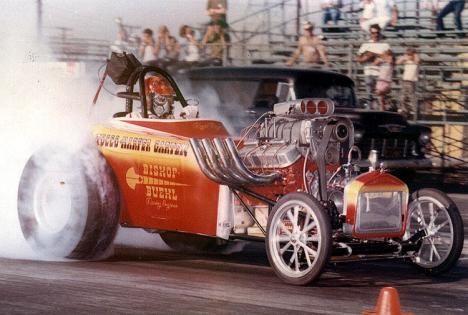

    Like it or not, if we're exploring the evolution of the T as an expression, it's worth a brief side trip to see a set of awesome cousins, don't you think?
    Hey, at least I didn't post the image of Ray Higley's "transformer" T altered that I was fortunate enough to wrench on! :eek::D

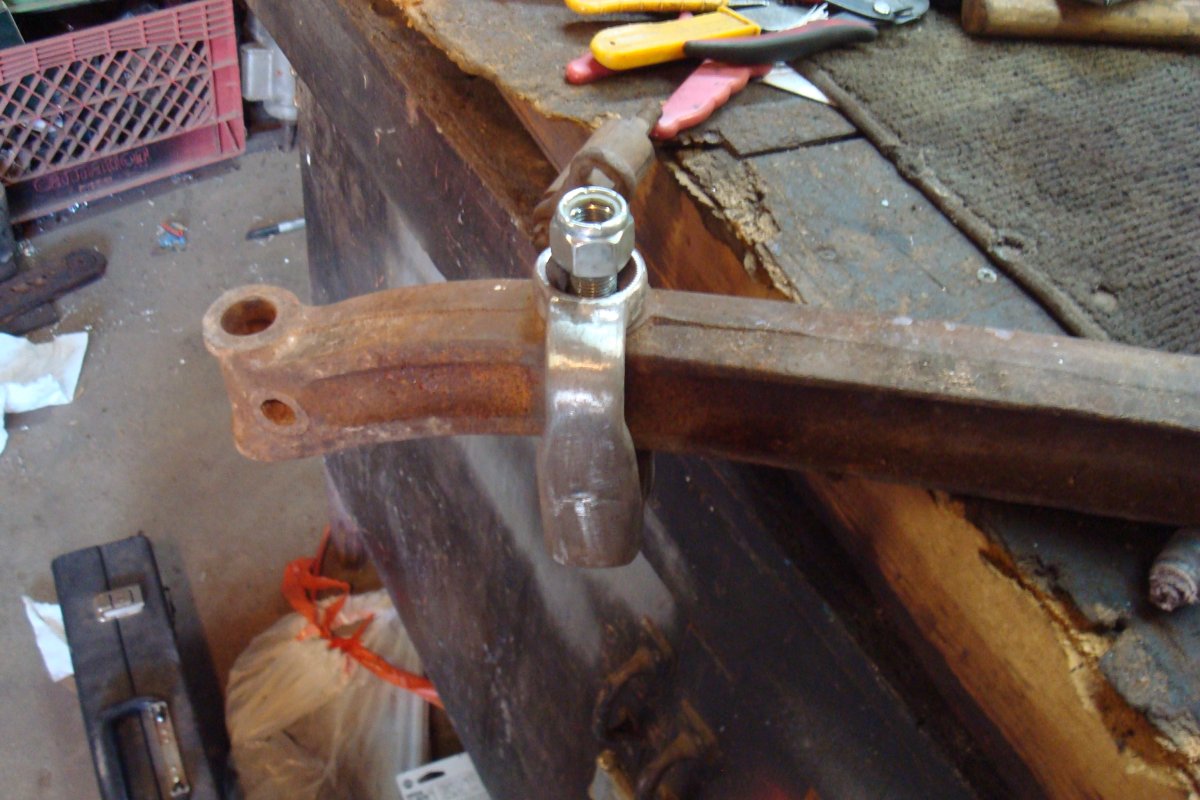

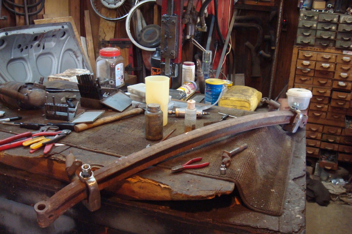

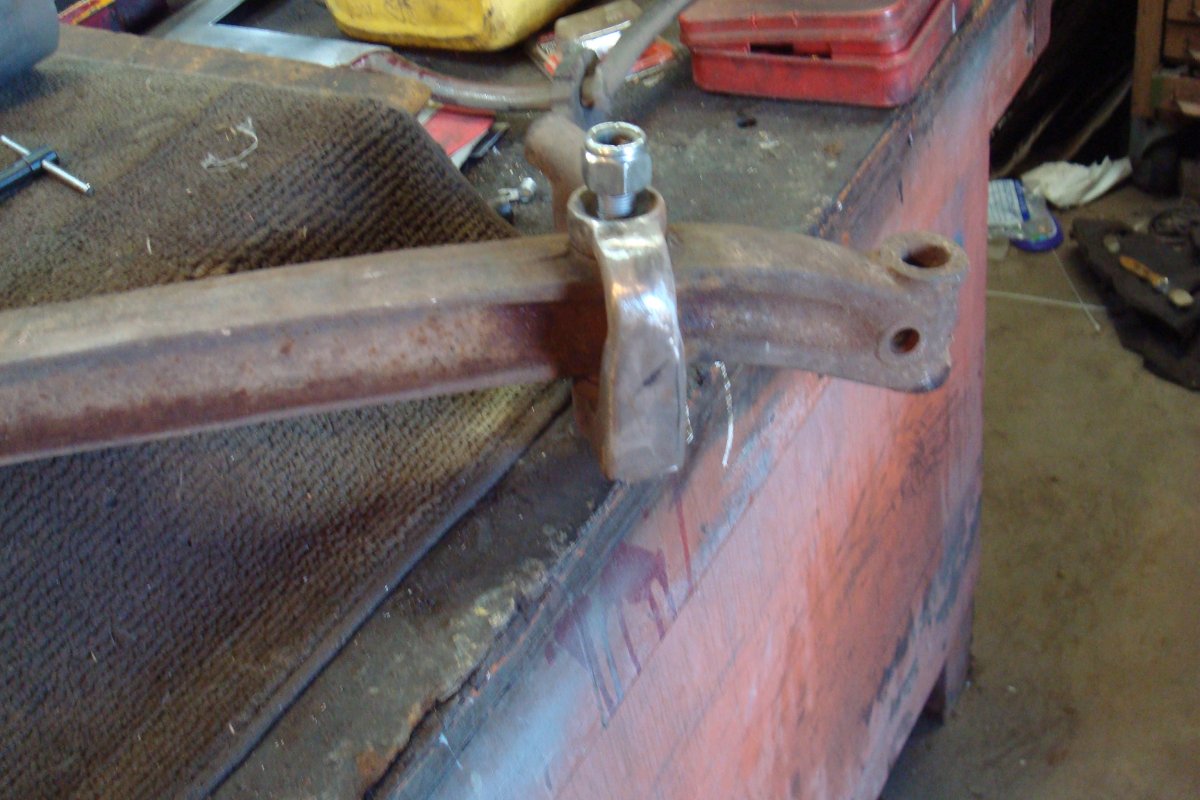

    Had a few minutes to myself in the shop the other day, and I am finally thinking about doing the '37-'41 beam axle I yammered about at the very beginning of the thread. I have a pair of front mounted hangers that will be trimmed and cleaned up quite a bit more, that will be turned around to mount the spring behind, ala Ivo's and Grabowski's car. I worked out the drill spots for the axle today, too. The "tricky part will be designing a pair of batwings that will be welded to the axle to pick up the existing hair pins.... Pretty sure I can get ElPolacko to zap something out on his magic plasma table after I design it.

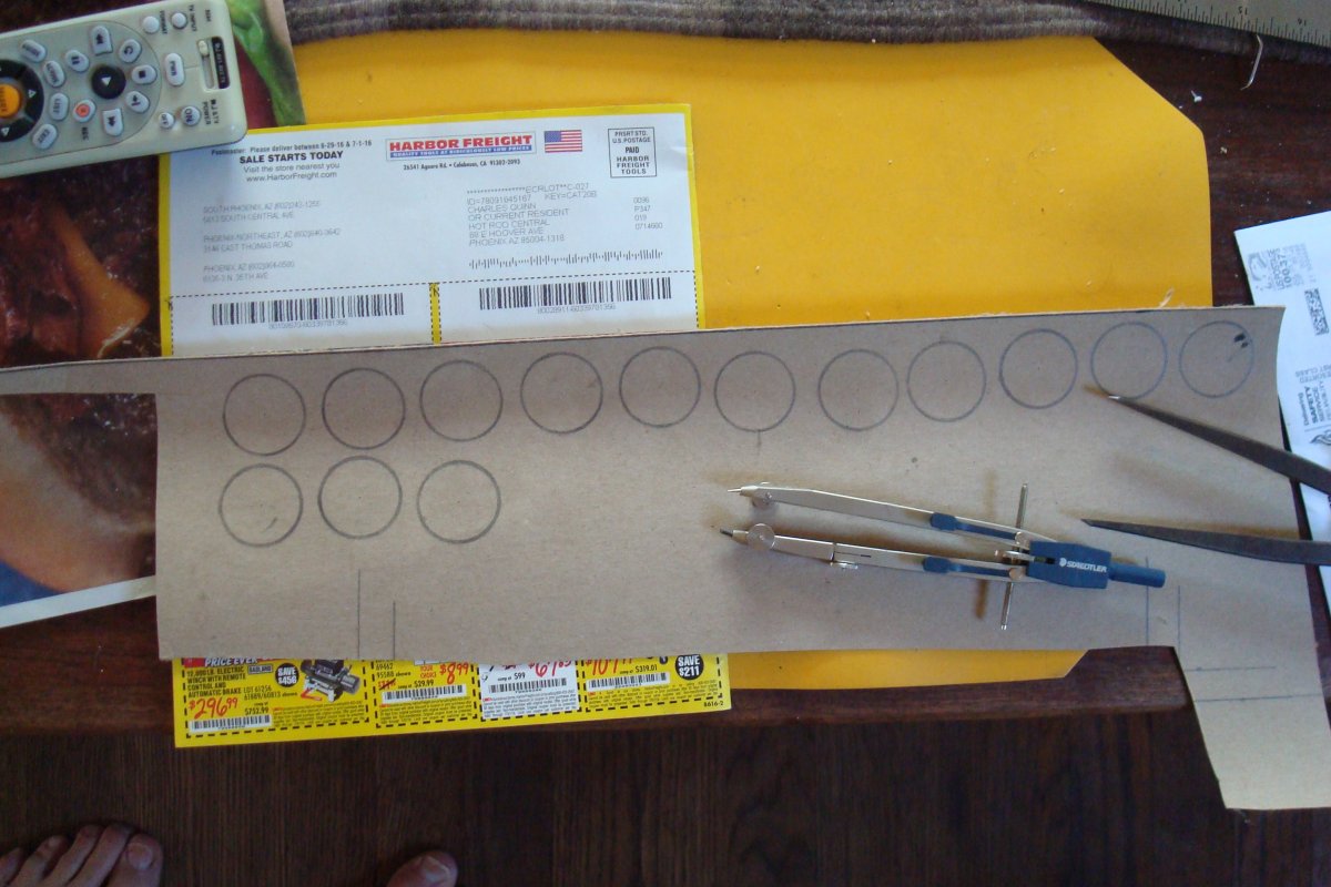

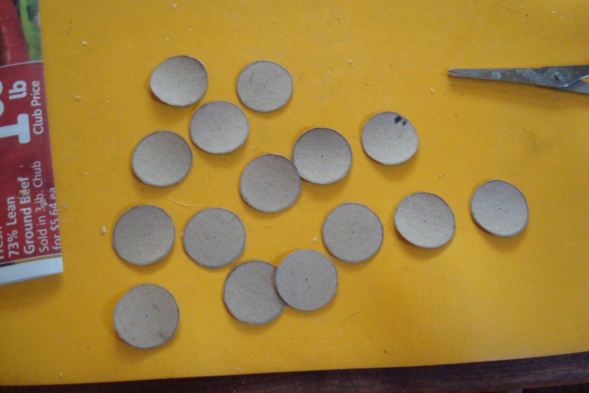

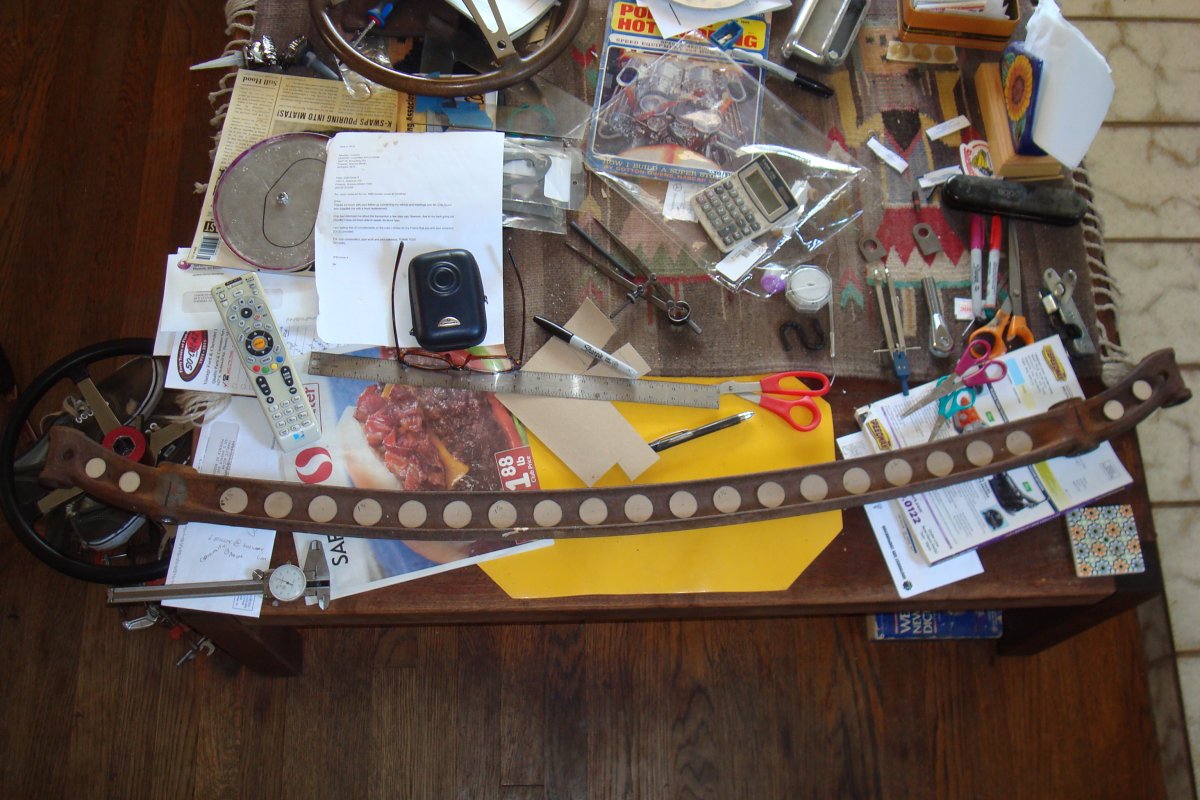

    So, with the temps running about 110-115 this week by noon, I've had some inside afternoon time to play a bit with my stuff. I figured out the hole spacing for my axle the other day. I do this a bit differently than most, being a visual kinda guy. Cutting out a batch of "holes" is the first step, finding center, and then trying several different counts and spacings are next... Pretty sure the last picture is what is going to be the finished look.
    What do you think?

    :D Neat.Looks like a go.
    Good luck.Have fun.Be safe.

    Looks good to me Chip. Kind of a nice surprise your changing the front suspension. Another nice look on a bucket is the stock Ford axle "SMILE" (heard that expression from Franko.) a lot of people leave off their Buckets.

    3/8" flat washers make good hole patterns too; 1" OD and you don't have to snip them out.
    Please don't drill the holes beyond the perch bolts, makes it look like you're trying too hard in a r*t roddy/Rolling Bone-ish kinda way. Just saying more isn't better.:)

    Chip- I have a '37-'41 axle originally intended for my T that I drilled almost identical. If I remember I'll snap a photo later.
