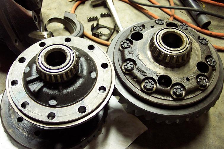

    I've been holding out. This is the other part I received. Now, if you guys remember, my original plan for this car was to use a 9" rear end., but finances kept that from happening. Some time after I started my build, a good friend in a chat room I frequent made me an offer on this Ford 9" pumpkin with Trac-Loc. I turned him down, as I had decided on the S10.
    A few months ago, I changed my mind and took him up on his offer. It took a while for him to send it, but since it was a GIFT, I didn't rush him. My plan for it is, to take my time and build a 9" rear end on the side. When it's done, I'll swap it in. I'm in no hurry, so updates on this side project won't come any time soon.

  9. Hackerbilt
    Joined: Aug 13, 2001
    Posts: 6,250
    Hackerbilt
    Ewwww....Sorry Fred...but that doesn't look like a Traction-loc or even a Posi.
    Some 9" opens used a 4 spider gear setup and center block but they still aren't a Posi...just stronger.
    It's always possible someone could have put an aftermarket "lunch box locker" inside the case but it isn't a Ford based posi unit from what I can see.
    The bolts holding the crown gear would be partially sunk into a higher inner bulge that contains the single clutch pack setup.
    You can see the difference here. :(
    Open on the left...Traction-Loc on the right.

    I got in touch and it's an after market posi and he's fairly sure it's a locker. Thanks. I spoke with him and he set me straight. He says once he gets his shed cleaned out, he's sending me a Auburn unit for it. And since I know NOTHING about these rear ends or the components, I'll be a Googling.;)

    Good stuff! :D Didn't want to see you spend good money on setting up a 9" housing and then discover it wasn't what you wanted after all!
