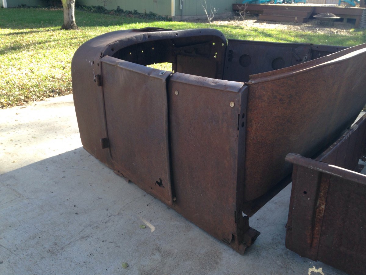

    I started with a rusty old T touring front half, threw it on an A frame I had sitting in the shop. The look kind of grew on me. image1.jpg 12821386_823578647754510_1522295415493224236_n.jpg

    14937338_979682168810823_7259352434357947527_n.jpg 14695514_969985793113794_5245735961221156941_n.jpg 14725763_969985986447108_8830342319138186357_n.jpg A bunch of time and spare parts later it is starting to look like something. 14937338_979682168810823_7259352434357947527_n.jpg
