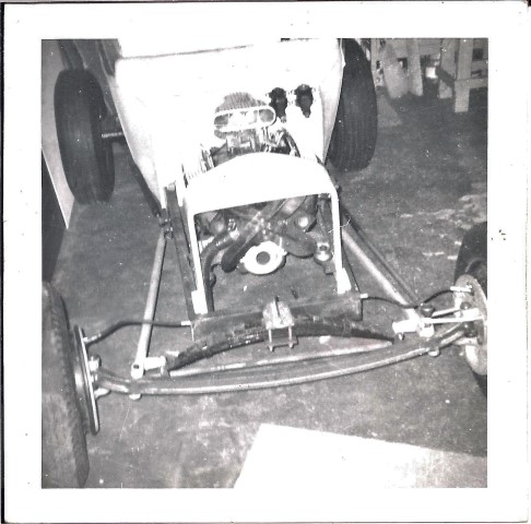

  10. RICH B
    Joined: Feb 7, 2007
    Posts: 5,953
    RICH B
    I do have to disagree with the idea that guys were using regular bolts back in the day; here's a picture in my mom's ba*****t circa '65, early T bucket project with hack sawed stock perch bolts.
    Like 26 said, regular bolts, bushings, and tapered cone washers will do the job and
    like you said most civilians wouldn't notice. So don't go thinking about abandoning this thread, we want to continue to see your updates and progress.

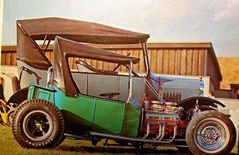

  27. need louvers ?
    Joined: Nov 20, 2008
    Posts: 12,901
    need louvers ?
    Nah, Fred, keep runnin'! there will always be those that disgree with the way you are doing things. That's their right. Doesn't mean you have to listen... You are doing fine!
    A friend asked that I post this picture over here. It popped up on Hot Rods Of The 1960s this morning...
    Blownfuel, Tim_with_a_T, Tim and 3 others like this.
  28. tfeverfred
    Joined: Nov 11, 2006
    Posts: 15,788
    tfeverfred
    Now I REALLY need to go back and put a smiley on that.
    I like the T, but you know what? I bet I can count on one hand, the number of T Buckets that have a nice top. Why does it seem so hard to get that right?

  30. RICH B
    Joined: Feb 7, 2007
    Posts: 5,953
    RICH B
    Here's a top I made 30 some years ago, kinda after some pictures in the R&C T-Bucket etiquette article, thought it looked OK without getting cartoonish. Came across the car a couple years ago, the Hartz cloth is shrunken and weathered; but still holding up. Too bad about the color and all the geegaws other owners have added to the car over the years. I liked it black. Kinda scary that it still has the same Mickey Thompson tires on the rear, now on wires instead of the Fenton Gyros. old t.jpg
