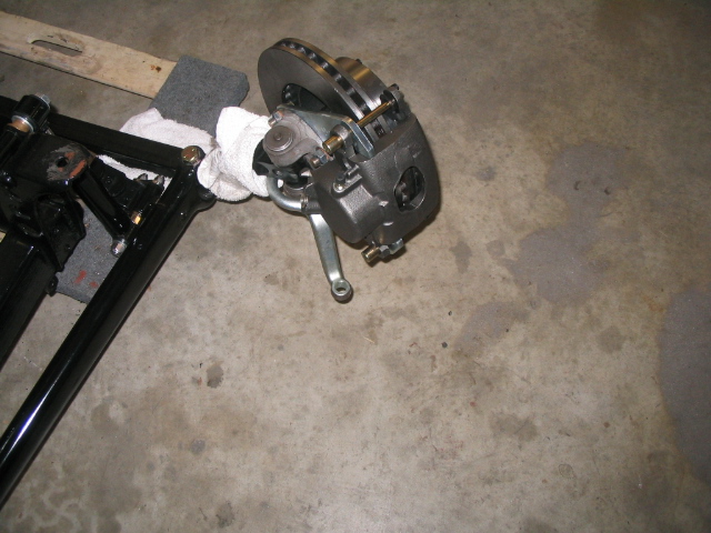

    Well, here we go. Other than demolishing an inner seal, it was a trouble free install. My only complaint is the mounting of the steering arms. I'd really rather have the bolts go through the arm and use a lock washer and nut. I'm not sure if anyone makes them or not. It's bugging me so much, I may just go with flat arms out front. Any way, here are the pics.

    The up side to those arms is there is more thread than a nut. Cross drill the heads of the bolts and wire them after torqueing, also use a dab of anti seize. If you go out front with the arms you will need to bend the arms out to achieve Ackerman. JW
  5. Looks good Fred. Just use a semi-perm Loc***e on those arms and you will be fine. Check em each time to change the oil or adjust the points for peace of mind

    I used flat arms before and got used to the Ackerman issue. Surely someone makes dropped steering arms that take a through bolt. IMO, it makes for a better install. I'll keep looking.

    The bolts go into threads the same as if you used a nut...except the threaded hole is even longer for more thread contact...and the "nut" can never turn. Use a good quality thread locker and a quality lock washer too if you like, and you're golden! :D
    My car has bad ackerman and drives great on the highway...but it ****S in close quarters.
    It's on the to do list because all the scrubbing etc when parking/backing up drives me right up the wall.

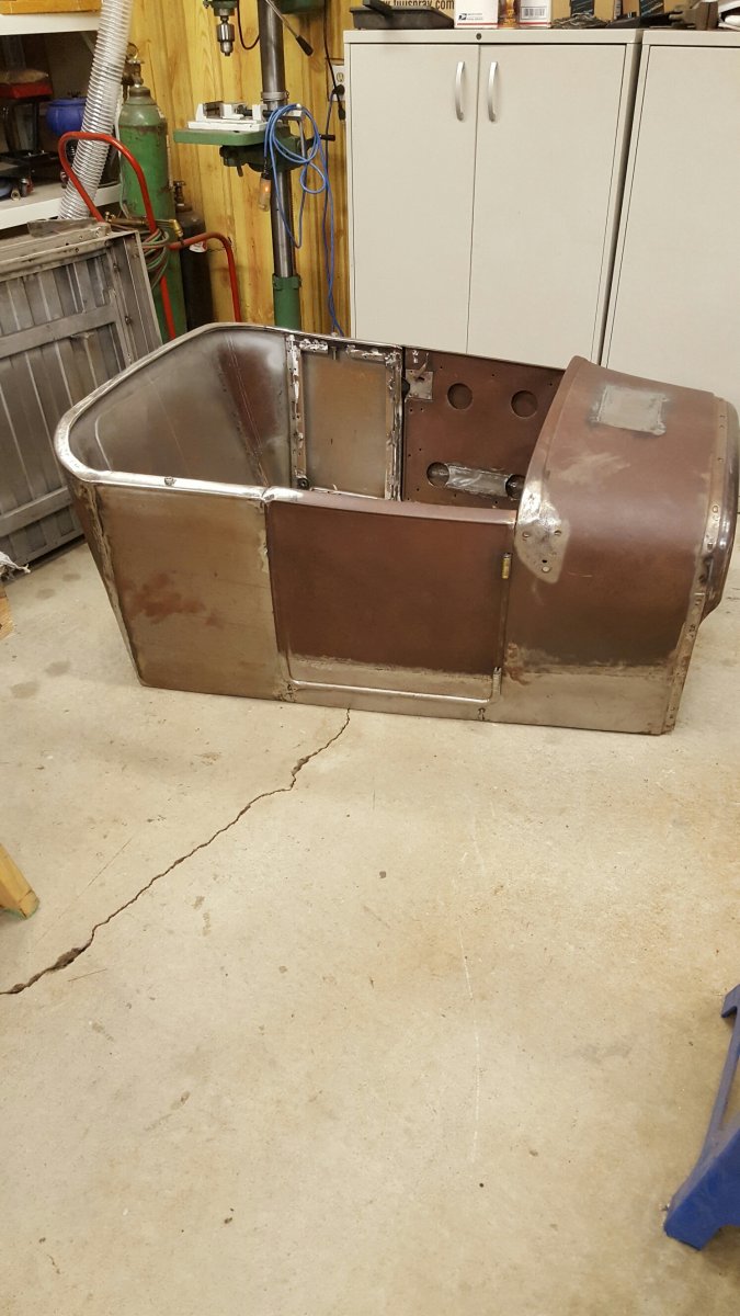

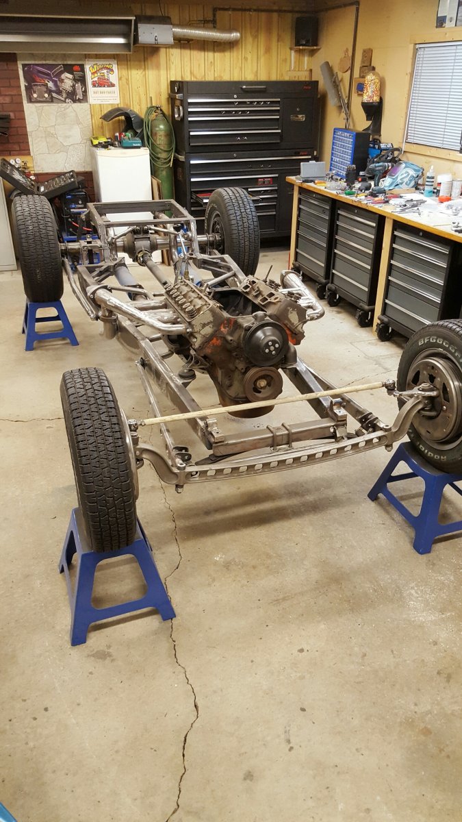

    Today I tore it down to finish welding and start having things chromed and coated and for bodywork and paint.
    Whew :D Finally.
    I'll get it tore down the rest of the way tomorrow and then the fun begins :)
    Larry :cool:

    Those bolt through dropped steering arms should be the same drop as the one you have. From the centre of the bolt holes to the bottom of the arm should be the same as they are both designed for the same application. I say "should" as I only have experience with the ones you have as these are what I have on my T, and with good results . JW

    Hey Fred. my buddy has had those same steering arms on his T roadster for over 20 years,
    No problems with them, Loc***e is your friend.

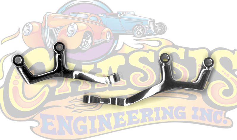

  17. Those CE arms work great and come in standard and deep drop.

    Anders, do you have a source and part number for those? That would be a sure fix.

  24. I prefer those CE arms myself for the same reason you want, bolt thru

    I suspect you are referring to clearance under your spring eye; but if it clears thru the visualized vertical position of your shackle, it won't ever get closer and should be OK. If you do go to the CE arms, they are forged and can be heated and bent for a little more clearance.
    Something to watch for, Speedway's 1-1/2" dropped tie rod ends in conjunction with your deep drop arms would probably get your tie rod well below the scrub line.

    Well, the end to my steering arm drama came down to dollars and cents. Like most things do, when you're building on a budget. The CE arms are $140 for the plain ones.:eek: As cool as the CR arms are.... they're just not in the game plan. So, I'll stick with what I have. They'll grow on me and my wallet will be happy.:)
