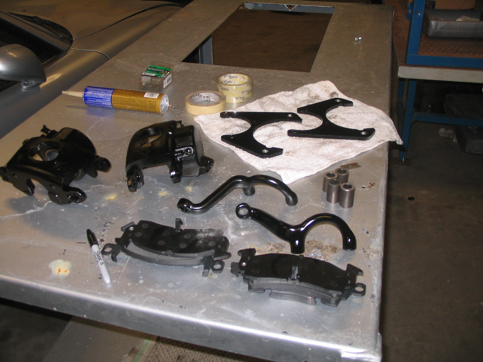

    Houston's weather is so screwed up. It was mid 70's and cloudy today, but may drop to mid 50's tomorrow. I was able to get on a primer coat and the first color coat. I may or may not apply a second color coat in an hour or so. Being that these are small pieces, I rattled canned them. First coat looks good. I took a couple pics, but they didn't come out. Not enough light, I guess. Hopefully, when I get in from work tomorrow, I'll be able to get some good pics.
    All in all, a good productive day.:)

    Second color coat applied! Looks good. Might get some sun tomorrow for good pics before ***embly.

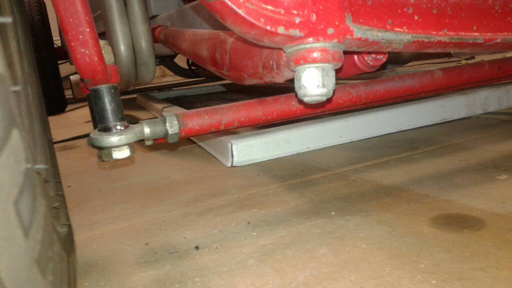

    I'm glad I spoke up. Be sure to check your clearance at full lock, the tie rod moves up and down as it goes side to side. I had to drop mine a little more after I noticed that.

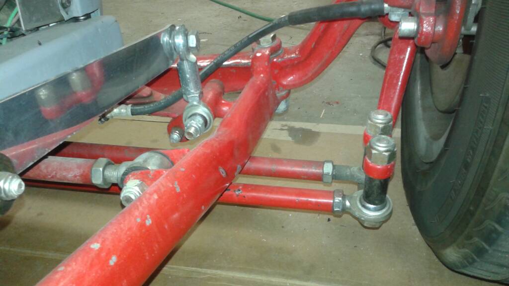

    After some m***aging (grinding), I got the steering arm to clear the caliper. But I'm concerned at where the clearance will be between the drag link and shock tower. Damn...... this hot rodding is some work.
    Taking a break and will install the tie rod in a bit. Kinda cut myself with the grinder, so now this gal has drawn blood. No turning back.:D

    Ouch, gotta be careful with grinders!:rolleyes: Are you having the drag link on to or under the steering arm? JW

    For now, it looks like under. But I really won't know until I get the steering box installed. I'd like the drag link to run parallel to the wish bone.

    And........ done. With 9/16" clearance. Seems close, but I have full movement stop to stop and I'm well within where the scrub line would be.
