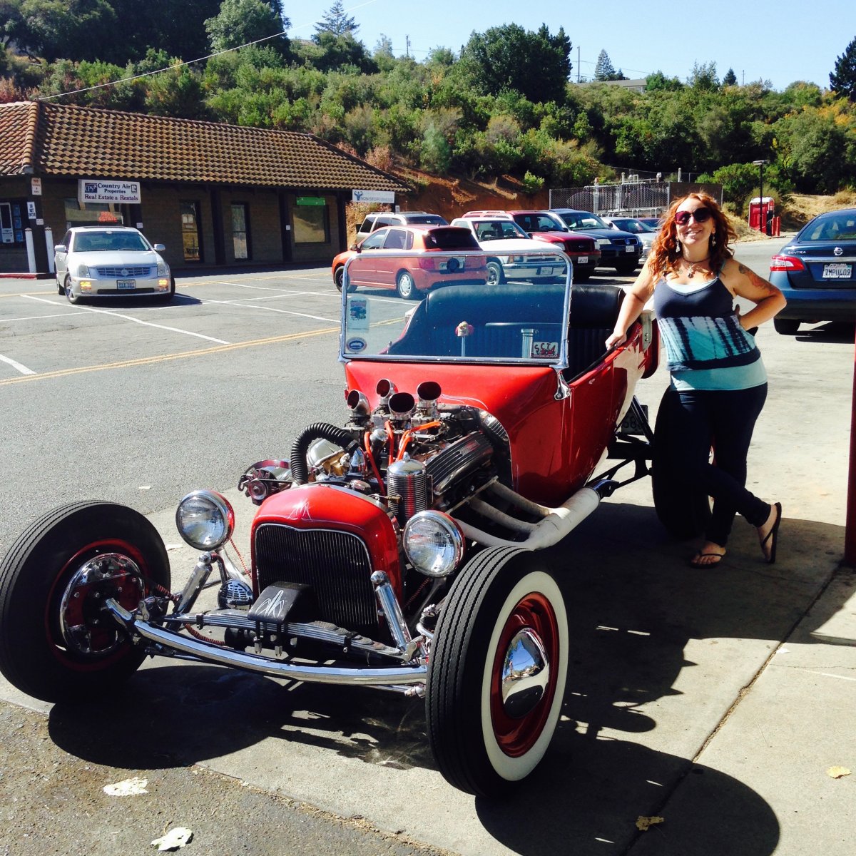

    Joined: Jun 14, 2006
    Posts: 3,604
    steel rebel
    My roadster hasn't got soul? Next thing your gonna tell me professional wrestling isn't real. Tell me she don't have soul. She is ****ing it out of my roadster or putting it in. Who cares?
    Ivo likes working at night too.
    Keep om trucking Fred!
    Your friend Gary
  28. 26 T Ford RPU
    Joined: Jun 9, 2012
    Posts: 12,583
    26 T Ford RPU
    Gary, all my cars have soul. The longer you own them the more they get.:) JW
