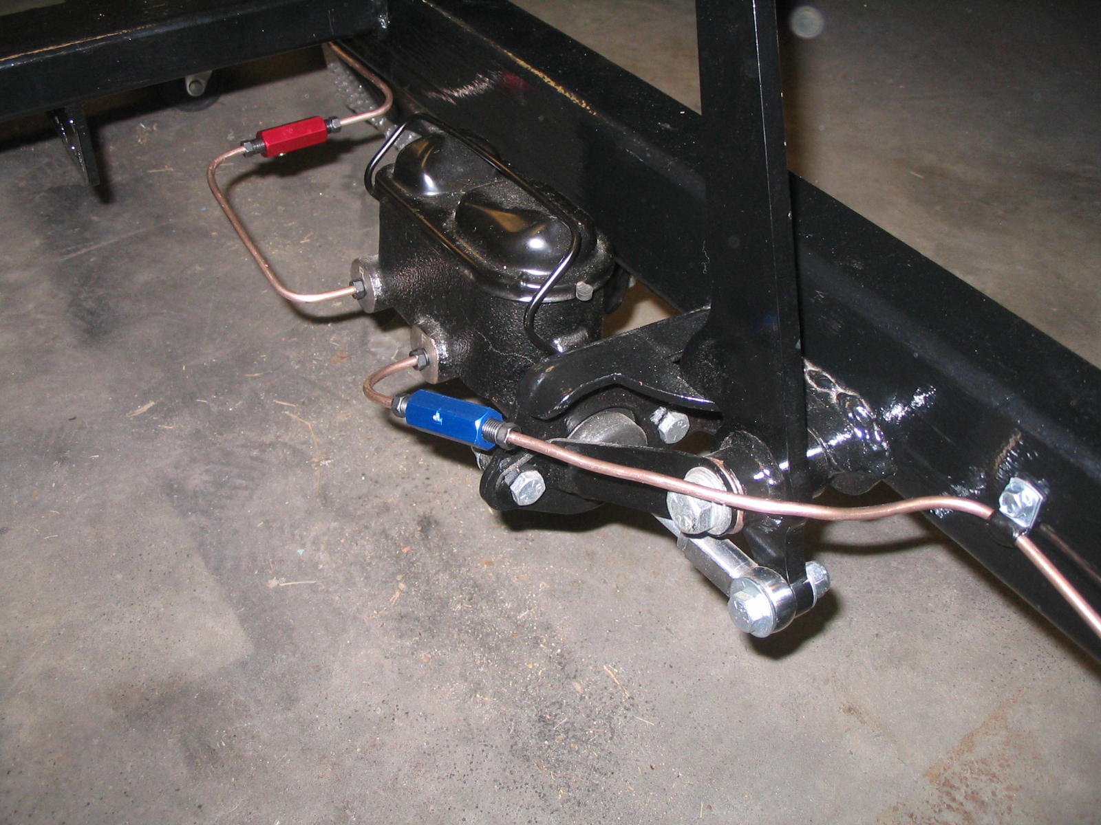

    My M/Cylinder is mounted the same as yours. If the M/Cylinder is mounted below any of the wheel cylinders or callipers it doesn't matter as you will need a leak in the system for it to back feed. JW

    So, I don't need a 10 lb. for the drums?

    A 10 lb on the drums and a 2 lb on the discs will give you a better pedal feel. The roadster my brother used to have also had the m/c below the floor but didn't have the valves and he had to pump the pedal a time or two before the car would begin to stop. I believe the conventional wisdom is to mount the valves as close to the m\c as is practical.

    That's also what I've been told and what I've done (10# drums. 2# discs).
    http://www.jegs.com/i/Right-Stuff/965/RV10/10002/-1
    http://www.jegs.com/i/Right-Stuff/965/RV02/10002/-1
    Glad you did the rear bracket too, Fred.
    I've asked many people about proportioning valves, and the consensus is that it really depends on the final weight, brake bias (size of all components) , tire size and suspension stiffness. You can go by similar builds, but each car is a bit different. Some guys that build rods go ahead and install one during the build so they don't have to modify after final finish. Others will leave it out unless it's really needed. Since you are on a budget and willing to make changes as needed, I'd say worry about that after the first test drive.

    Fred, if the M/Cylinder doesn't have residual valves fitted then do fit them as t-rod said. Mine has them fitted. JW

    I ordered the fittings for my residual valve already. I'll install it and she how she handles, when she gets on the road. Which will be a while.

    Well, after work I came home and did a LOT of web searching on residual valves in Hot Rods. The results were mixed, as far residual valves go. But the underlying factor was, I should go with a 10 psi and a 2 psi residual valve. So, I went down and figured out where I'd put them. And that's when a 20 minute project turned into a 1 hour brain session. End factor? I redid the lines and made them look better.
    I let the groove of cl***ic rock guide my hands and mind. Yea, I got artistic and cosmic. Here's the end result. The residual valves are just mocked in for fit. The fittings for the 10 psi will be here Wednesday.
    I called my guy at ""O'Rielly's" and he says he may have the fittings for the other residual valve (I only ordered 1 for the 10 psi). I'll swing by on my day off and search his waaaaay unorganized brake parts bin.:)

    Looks nice but have you checked for brake peddle to brake line clearance when the peddle is fully depressed, like when bleeding the brakes. JW

    Come on, man!:) Yup! Full range of motion.

    Two of my residual valve fittings arrived today. I purchased some thread sealer and installed the 10 psi valve. Then, I applied thread sealer to all the flare fittings, except for the wheel cylinders, which I'll be replacing later. The other 2 fittings will arrive tomorrow or Friday. Pics forth coming.

    A welcome surprise, the other 2 fittings arrived and are in place. Next up.... I'll replace the wheel cylinders and access the other hardware in the drums.

    Can you "Clock" those so the tiny screws point downward so you can make adjustments from the bottom when the body is on?

    To my knowledge, they are NOT adjustable. No mention of that in the instructions. I looked and the screws seem to be to keep a spring or whatever, inside.

    They will be set at the specific pressure. JW
