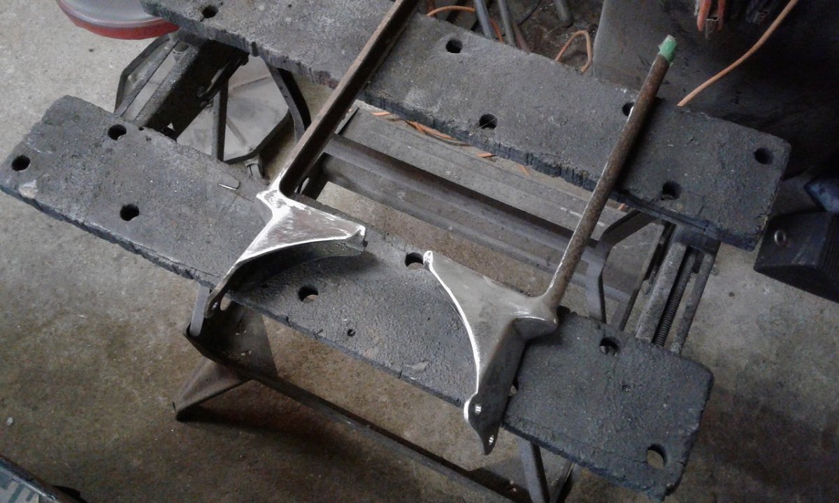

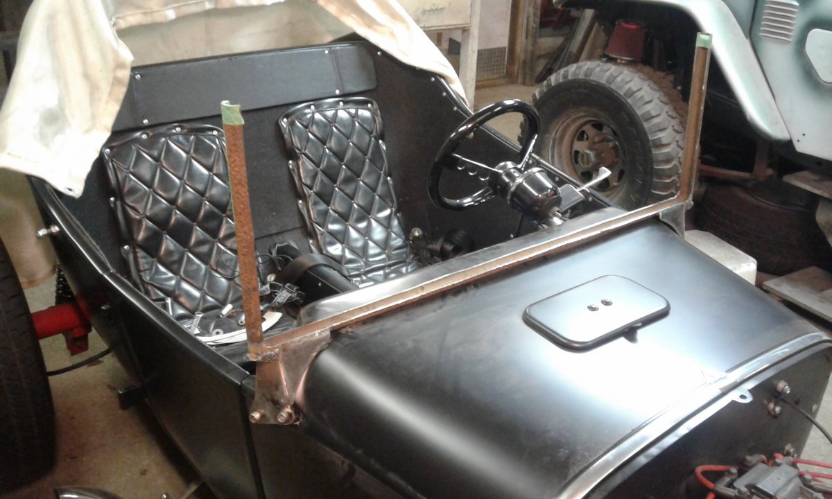

    Well...I built my new windshield frame and posts from some s**** steel, rusty pipe and repurposed tierod tubes.
    Don't have the gl*** in it yet though.
    When its finish ***embled the top retainers will have wing nuts and the bottom ones will be acorn nuts. The jury is still out on support rods.
    Hoping to be out again next weekend.

    Can you take some more pictures of your posts? I'm literally standing here scratching my head looking at mine. I have hacked them up too many times to get them all smoothed out, so I am looking at splicing in some sliced DOM tubing and some radiused plate steel. Not looking promising so far.

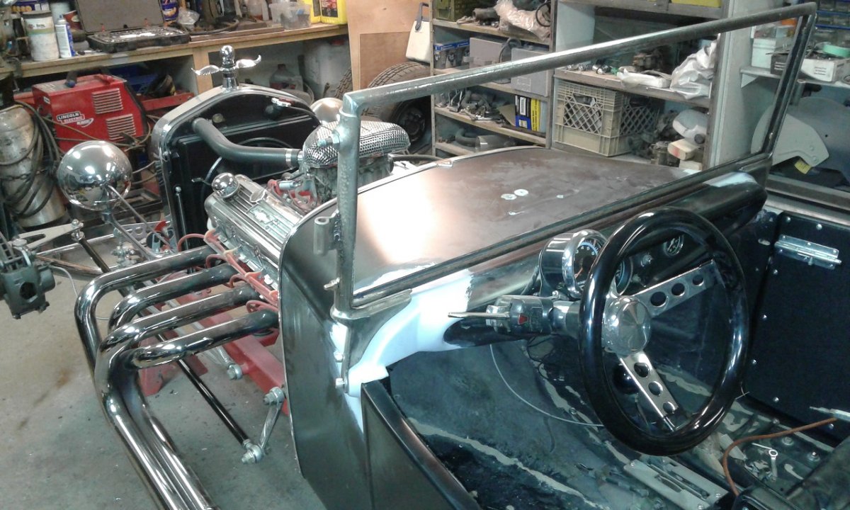

  6. Hackerbilt
    Joined: Aug 13, 2001
    Posts: 6,250
    Hackerbilt
    Sure!
    I wanted tall posts so I split the old water pipe and made a full frame to span the cowl. Made it easier to align everything.
    Then I made up the outer sections that actually bolt to the cowl and welded them on.
    After that I made the triangular front and rear filler pieces and welded those on.
    At the very bottom of the post I added some metal and welding to shape the bump around the base of the posts. i just made them look like the old chrome posts I removed.
    It was pretty easy with a grinder and then a 1/2 round file for finish.
    Once everything was fully welded I cut out the center part of the pipe that went across the top of the cowl. I could have left it in place but didn't want the thicker look it gave.
    I added some hole saw plugs, left over from some other past job, for the round upper mount flats.
    The purpose of all this was to get a more vertical windshield, 2" taller and a little bit farther ahead.
    In addition to allowing for a future roof, this will also visually shorten my long cowl a little AND give us a bit more wind protection. The two hinge plates welded to the sides are for wind wings.
    It all adds up....

    Nice. Thanks. Kinda sorta along the lines of where I'm going.
