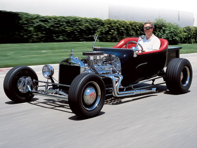

    Here's a T Bucket with a CCR stretched body, like I'll be using. The front tires are 195/60/15 (24.2"). The rears are 275/60/15 (28"). That's difference of 3.8". Notice how subtle the rake is? That's what I'm looking for. My tires are 165/80/15 (25.4") and 235/75/15 (28.9"). a difference of 3.5". I'm hoping my frame and body sit a little lower in the rear. If it does, I think I'm well into the ball park, profile wise.
